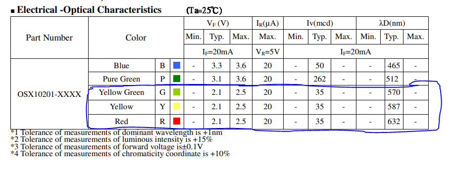

About the LED current. The value of 20 mA AIM65 mentions is per LED. So full scale would require 240 mA for 1 channel. You would power the IC and the LEDs from a single supply which is well above the reference voltage. However, 20 mA is darn bright with modern LEDs. I also am used to calculate LED current at 20 mA like I did in 1974. But something has changed the last 50 years. LED current of 20 mA is sufficient to read the newspaper. Test the LEDs you will be using and make note of the current. Then calculate the resistors for your VU meter.
I am using my VU meter in my home cinema, so in the dark.The current through the LEDs is less than 2 mA IIRC. It is LED dependent so you have to test it.
It's a bargraph with 10 leds: 5 green, 3 yellow, 2 red. All the leds are the same 2.1 - 2.5v voltage drop and 35 mcd i don't know how bright that would be .About the LED current. The value of 20 mA AIM65 mentions is per LED. So full scale would require 240 mA for 1 channel. You would power the IC and the LEDs from a single supply which is well above the reference voltage. However, 20 mA is darn bright with modern LEDs. I also am used to calculate LED current at 20 mA like I did in 1974. But something has changed the last 50 years. LED current of 20 mA is sufficient to read the newspaper. Test the LEDs you will be using and make note of the current. Then calculate the resistors for your VU meter.

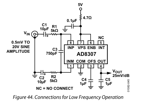

I have first hand experience with the device below and used it in a high-speed logarithmic detector---- the RSSI output has good log fidelity over many decades. Though it's presented as FM IF limiter/discriminator, I'm confident it can be applied at audio frequencies. The RSSI output will provide the log of the instantaneous signal amplitude (absolute value).
https://www.mouser.com/ProductDetail/Nisshinbo/NJM14570RB1-TE1?qs=OSezeAgrLvyzBGfJk3%2BFrA==
The question is what kind of decoupling capacitance you need at pins 7 and 8 and what the resulting settling time at start up will be.
Looking at the "Terminal function" table in the datasheet, it looks like DC feedback is done via 100 kohm resistors. The various graphs show that limiting starts around -80 dBm; assuming that is referred to 50 ohm because there is a 50 ohm termination in the test circuit, that is about 22.3 uV RMS, or about 30 uV peak.
Assuming it is actually the phase detector that starts the limiting, and assuming the detector is an ordinary Gilbert cell mixer that starts to limit somewhere around 60 mV peak, the limiter chain must have a voltage gain of about 2000 at low signal levels. With 100 kohm DC feedback resistance, the impedance at the DC decoupling pins is then about 50 ohm, so you need at least 200 uF at pins 7 and 8 if the lowest frequency of interest is 16 Hz. This is nothing more than an educated guess, of course.
With 100 kohm and 220 uF, the charging time constant is 22 seconds, so it may take a few dozen seconds or maybe a minute or so to settle after power on. If you don't care about the operation at 16 Hz at very low signal levels, you could use somewhat smaller capacitors.
When you just take the 10 nF that is recommended in the datasheet for 10.7 MHz IF, and scale it inversely proportionally with frequency, you end up using 6800 uF capacitors. The settling time will then be very long indeed.

My application was not audio. Spectrum of interest was roughly 50kHz and upward, and thus limited to the bandwidth of the device—— about 25 to 30MHz. So the caps I used were small, probably 47nF. Your reasoning about required cap size seems correct. The technique may be unattractive for that reason. 😢

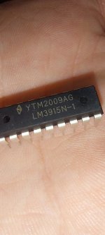

ic's arrived, logo doesn't look " legit " to me but hey , who knows.Hi,. A few days ago I ordered 20x LM3915
National Semiconductor ?.
Before TI bought them .
I doubt they are old stock National Semiconductor.

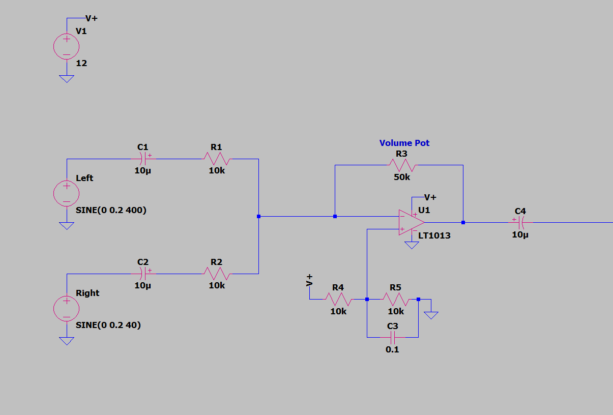

Would this be ok ? . " Bridging " both channels like that andThe head amp before your band pass filters is a bit overkill. Using one or two opamp as buffers could be enough.
Putting the volume pot between op amps idk if it's usless or beneficial, but from a dual op amp , one channel isn't used . And I was thinking this way the pot won't affect the signal source .
Total Gain is 4 if my math isn't failing me , Thinking to use NE5532 , not sure they are ok for unity gain or if I need no gain in the buffer amp that feeds the LM3915's .
That is a very low impedance at the input. Summing two signals is mostly done by building a summing amplifier. That is, connecting 2 signals to the inverting input of an opamp. Google for summing amplifier. Resistors of 47k would be sound.
You could vary the gain by putting a pot in the feedback loop of the summing amplifier.
If you use the pot like you do you would need a buffer amp to get a constant low Z output. If you have the second half of the 5532 anyway and unused your solution if totally fine.
And yes, NE5532 is unity gain stable.
Like this ? Input impedance is dictated by R1 , R2 . 10K for each channel or 5K since they are kinda in parallel?.That is a very low impedance at the input. Summing two signals is mostly done by building a summing amplifier. That is, connecting 2 signals to the inverting input of an opamp. Google for summing amplifier. Resistors of 47k would be sound.
