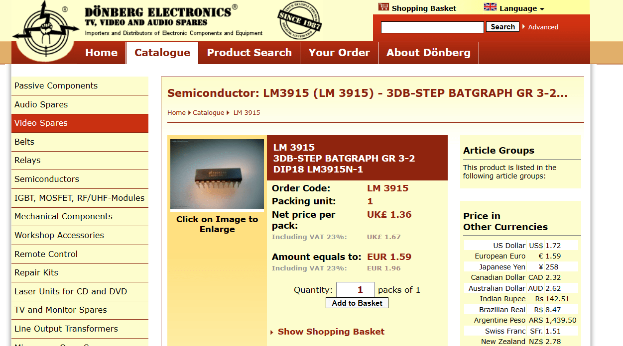

This doesn't directly answer answer your question but as to the LM3915, I would have thought at this point in time you could come up with some new stock. You rule out Ebay and that's fair enough but there are lots of cheapo boards/projects using these chips for sale. Could be worth taking a chance to scavenge the chips.
Donberg list them as available for example:

Hello Thanks for the info.
That pricing seems good and thanks for the info. I am thinking about stocking them. But it's not so easy to say how much....
It did give ma an idea as they are pin compatible I could make a display PCB using the lm391x and if the lm3915 isn't available anymore in the future I only would need to change the detection circuits.

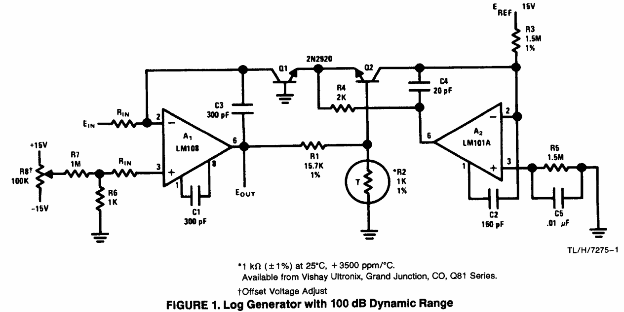

Analogue logarithmic converters usually either use the exponential voltage-to-current characteristic of a bipolar transistor, as TerrySt wrote, or a limiter chain with rectifiers, often called an RSSI circuit.
When you make a long chain of amplifier stages with gain A that clip nicely when overdriven, put some rectifying circuit after each of them and add the rectifier outputs, you get an approximately logarithmic response. Suppose the output of a rectifier goes from 0 to Vrect when the input signal goes from 0 to the amplifier stage clipping level. Each factor of A increase of the input signal then increases the sum of the rectifier outputs by Vrect.
When the amplifier stage is a differential pair, you can use the emitter voltage of the next stage as rectifier output. You often see circuits like that in FM IF circuits, the trick would be to find one that is usable at audio frequencies

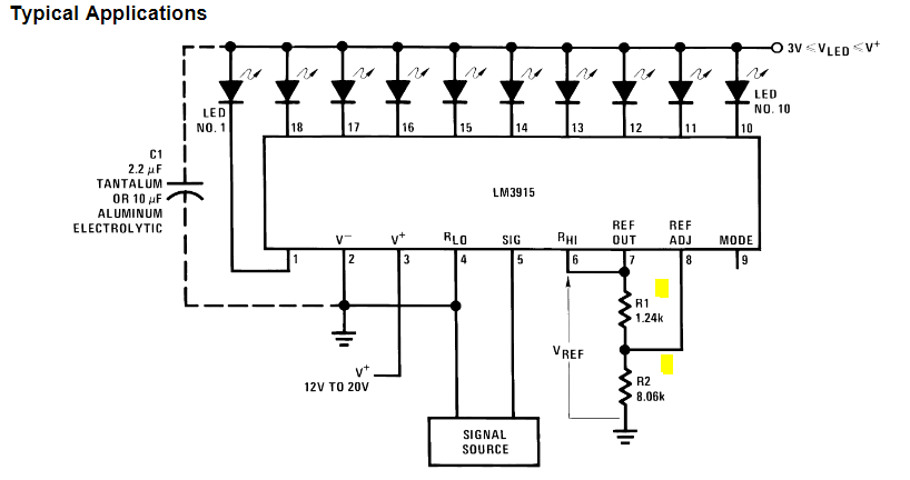

Hi, I was searching on the LM3915, and found this thread , I have some dumb moment here because the led current and voltage scale are selected with the same resistors.
Currently I'm building a LED spectrum analyzer , and if someone here can make me understand better or help with the values for R1/R2

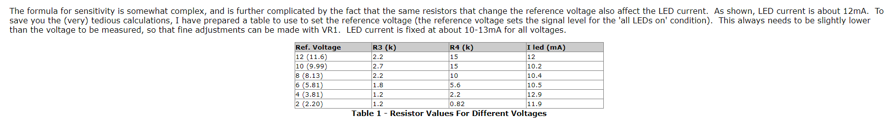

" Internal Voltage Reference from 1.2V to 12V ". So if I mess with R1/R2 I change the current trough the LED's and also the voltage ref, ( one combination of R1 and R2 will light all the leds on 2v input and other combination might light all the leds on 10v input ? ) , so the 3db/steps still remain ? .
Found something on Rod Elliott's website as well saying " The formula for sensitivity is somewhat complex, and is further complicated by the fact that the same resistors that change the reference voltage also affect the LED current. ".

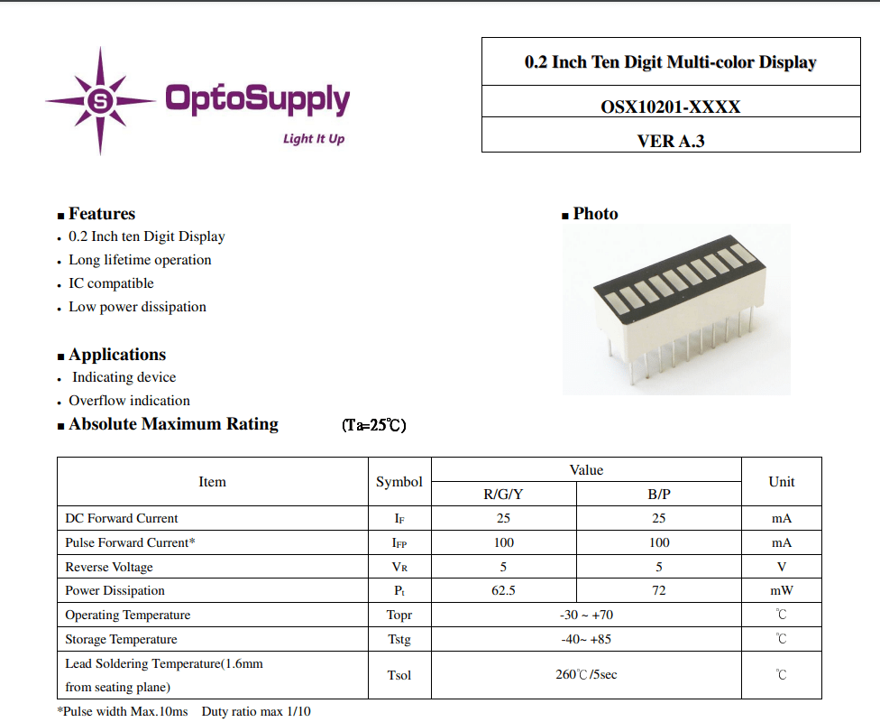

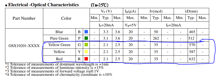

This is the Bargraph I will be using , x10 bargraphs and x10 lm3915.
So , 2.1v at 20mA . Can you help with the calculations for the resistors on the lm3915 for 20mA for the led's , I was thinking 5V supply for the leds , same 5v or another 5v - 12v for the ic's .

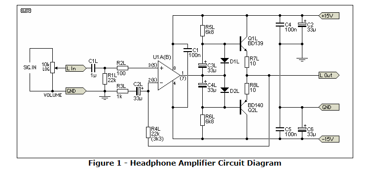

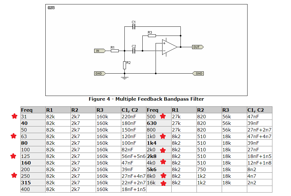

Filters I was looking at these from Rod Elliott's . they have a Q of 2 - 4 .
And for the input, a buffer that feeds the bandpassfilters, I was thinking to use this circuit. I'm not sure a single op-amp can do the job to drive 10x filters.
Since I don't know if I can post someone else's circuits. Here are the links to the schematics by Rod Elliott:
https://sound-au.com/project113.htm
https://sound-au.com/project64.htm
Thank you.

This from the 1994 National Semiconductor "Linear Applications" -- I have a box of the TC resistor specified:

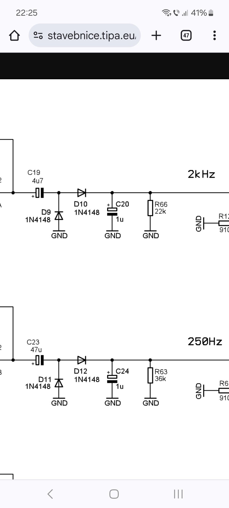

Note for anyone who wants to use the rectifier circuits: The gain for the mid and sub channels is different. I use the VU meter to indicate the power referred to the maximum power the speakers can handle. Because the power rating of the subwoofer is much higher, the VU meter indication is lower.

To calculate the two resistors, you need to decide the max voltage at the input : voltage which correspond to 0dB. Let’s say 5V; then chip supply should be more than this, let’s say 6 or 7V. 6 or 7V are ok for led supply, which should not exceed 7V in bar graph mode. A single 7806 or Zener+bjt should be enough for this.So , 2.1v at 20mA . Can you help with the calculations for the resistors on the lm3915 for 20mA for the led's , I was thinking 5V supply for the leds , same 5v or another 5v - 12v for the ic's .
According to TI datasheet page 2, R1 and R2 could be evaluated using Vref=5V and iLed=20mA.
Use R1=680Ω and R2=1800Ω + 150Ω.
You can also play with this : https://www.electro-tech-online.com/tools/LM3915V2.php but accuracy is too low
Or if you own a Windows PC with Windows < W8, you can use ESP software : https://sound-au.com/download.htm !
The head amp before your band pass filters is a bit overkill. Using one or two opamp as buffers could be enough.
Between each band pass and it’s LM3915 Vu meter you’ll certainly need a peak detector such as the one described in fig17 of the TI datasheet.
Would this also work ?Between each band pass and it’s LM3915 Vu meter you’ll certainly need a peak detector such as the one described in fig17 of the TI datasheet.
Thank you for your time.According to TI datasheet page 2, R1 and R2 could be evaluated using Vref=5V and iLed=20mA.
So with R1 680 and R2 1950 , 5V input would be 0 db , and 20mA for the leds at 5v led supply ? . and 6-7 v for the ic.
I don't think so, this circuit gives you twice peak value (peak to peak) minus 2 * diode forward voltage.Would this also work ?
The diodes induce a voltage drop of about 600mV on the peak value (1.2 on peak to peak). 600mV with a 0dB FS at 5V corresponds to about -18dB, Vu meter display will be erroneous : shifted down by 18dB (6 leds...). That's why an active rectifier is required, such as the ones described in the datasheet.
