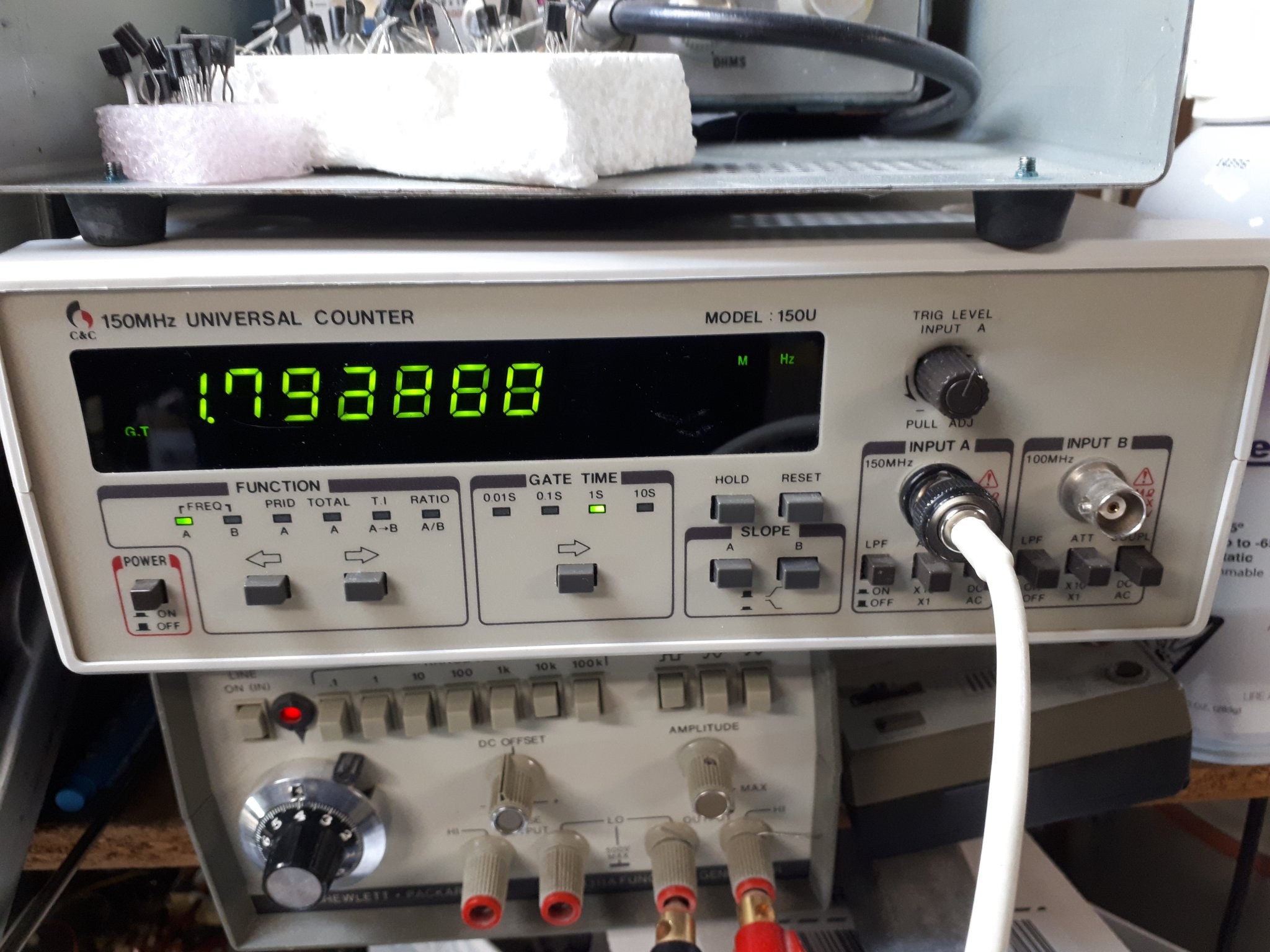

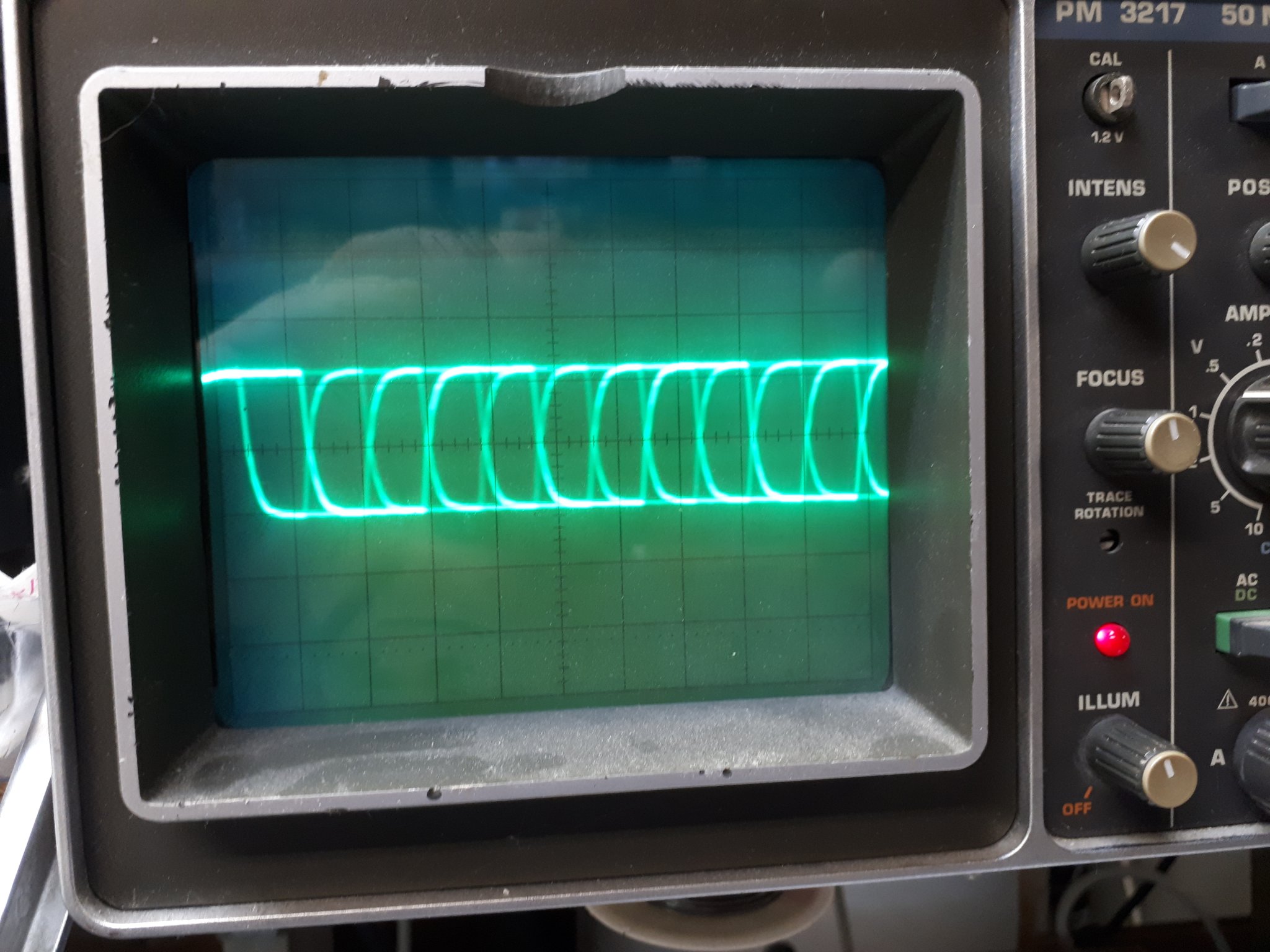

The output of the cd transport is 0.5V. As you can see, the square waves taken at the output of the transport at the end of a 1m coax are quite good. With my frequency counter connected to the output of the cd transport I read 1.79 MHz. What could be the problem ? Thanks.

I tried many signal attenuation as from the chip output, there's 2v. I settled at 0.5V with a 300 ohm in series and a 100 ohms to the ground. I tried the output with a cap. It is always doing the same thing.
