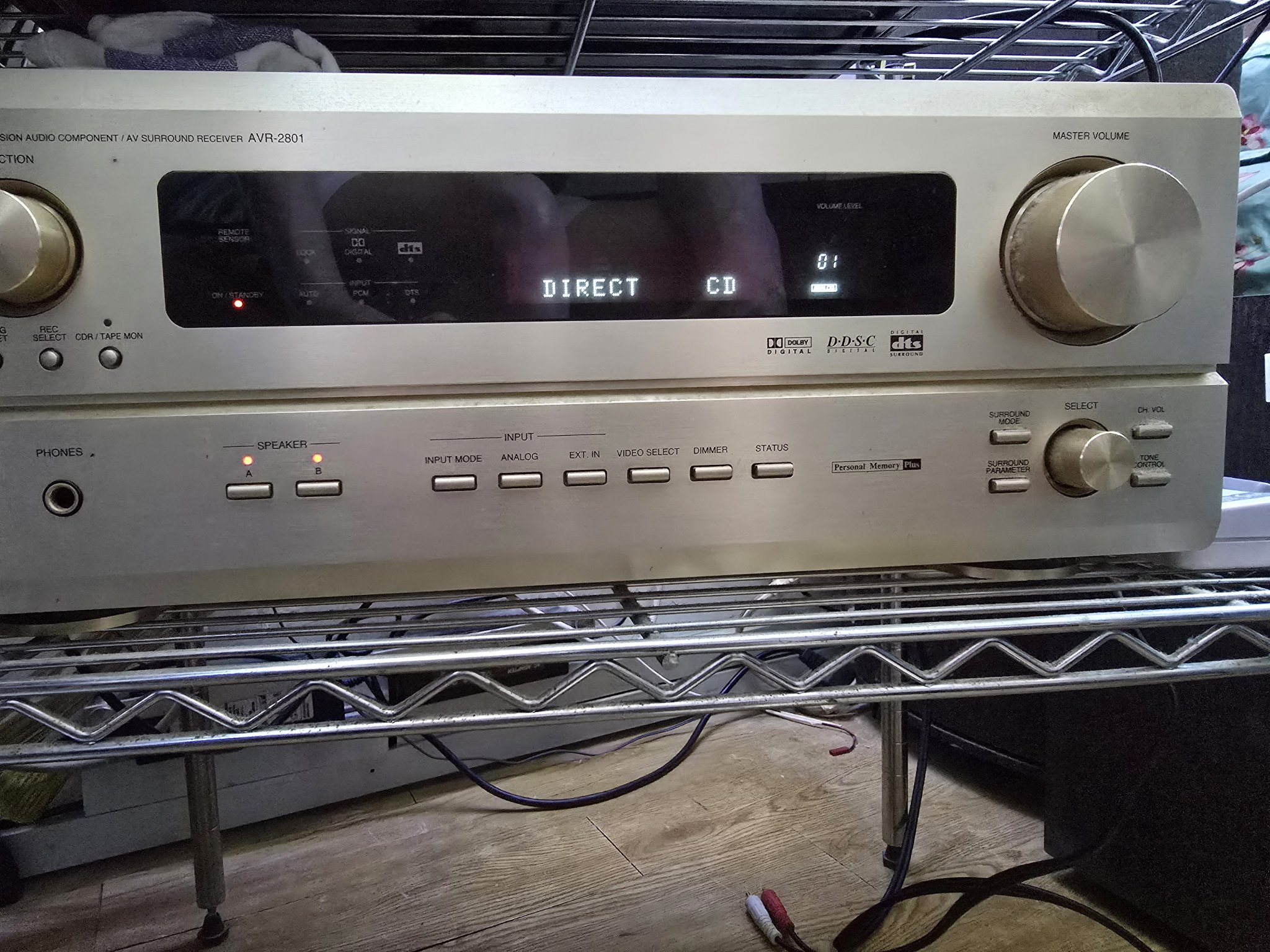

There are many switches on the Denon Amplify.
The problem as I see it is that the Denon is not simply an 'Amplifier', but is an 'AV Surround Receiver'.
I've never used one of those devices and consulting the manual I'm mesmerised by all those switches and settings!
Looking at the 'Playing the input source' section of the manual I come up with this:
- Set the input source to CD using the function control on the main unit.
- Press the ANALOG button. This ensures that the analog signal going from your PC output into the CD input is decoded by the receiver and played. Alternatively, selecting AUTO on the input source function control should make sure an analog source is detected and decoded automatically.
Hi Galu,The problem as I see it is that the Denon is not simply an 'Amplifier', but is an 'AV Surround Receiver'.
Yes, It is quite complicate in operation.
Now I got my problem fixed.
Connectin - CD In ports
Setting - Direct CD (please see attached photo)
The sound is excellent, no difference to my Onkyo CD Player which is not working now.. I re-connect my subwoofer and the bass is also execellent.
Any further advice from you ? Thanks
