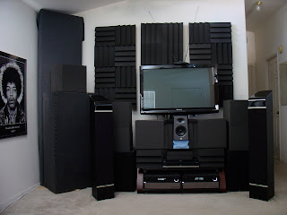

You can see my 2 subs are very close to my mains now--to the inside and on the floor. My third is located underneath Jimi Hendrix. 🙂
