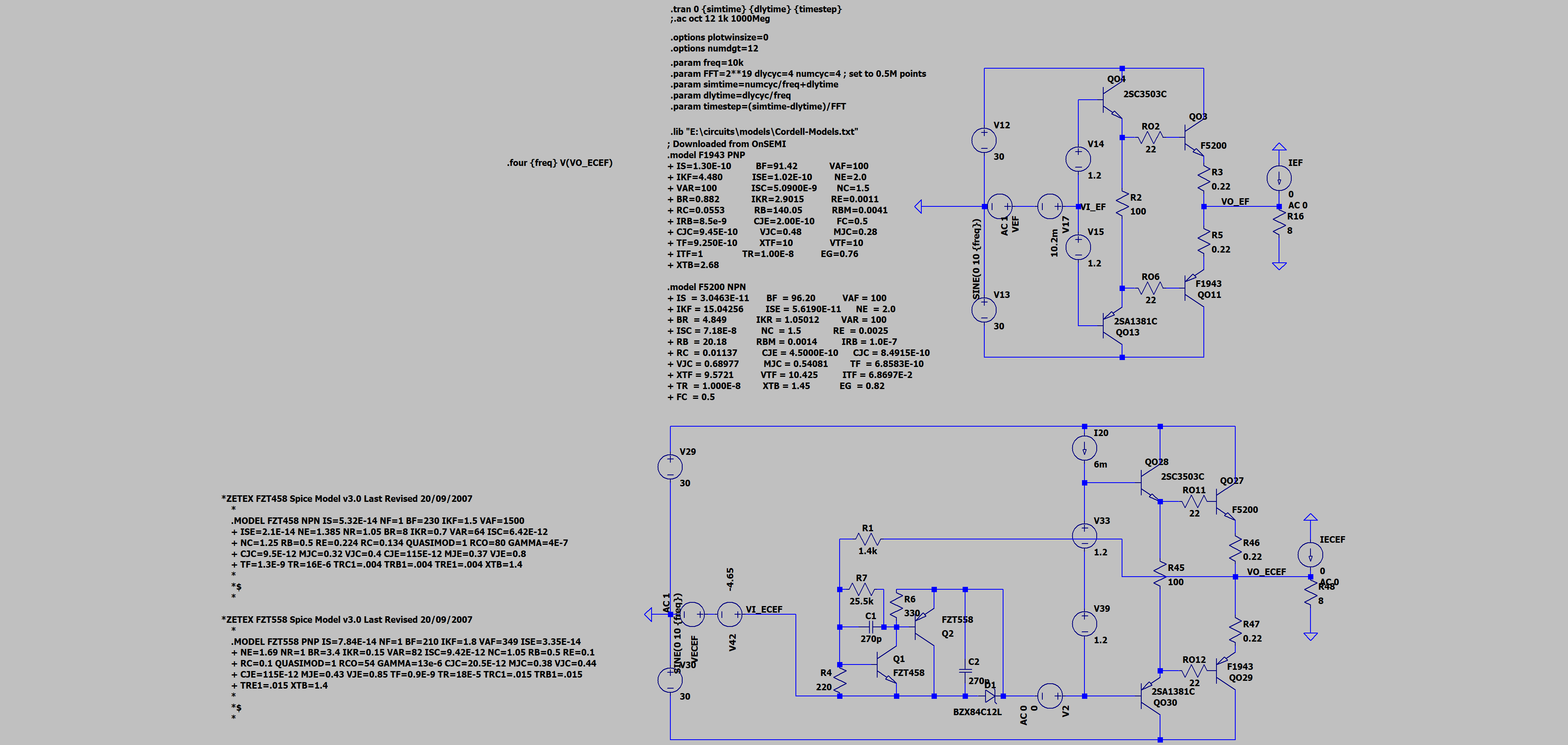

I recently performed an experimental validation of the use of a floating VBE multiplier to perform local linearization of an output stage. The idea is to regulate the voltage between the VAS and output to a constant value.
I researched this concept after an investigation of feedback versus "error correction" last year. OldDIY showed this strategy used in a Russian audio magazine. This implementation is an attempt to distill the benefits of Hawksford "error correction" documented by Jan Didden and LKA and others into a feedback concept with small parts count.

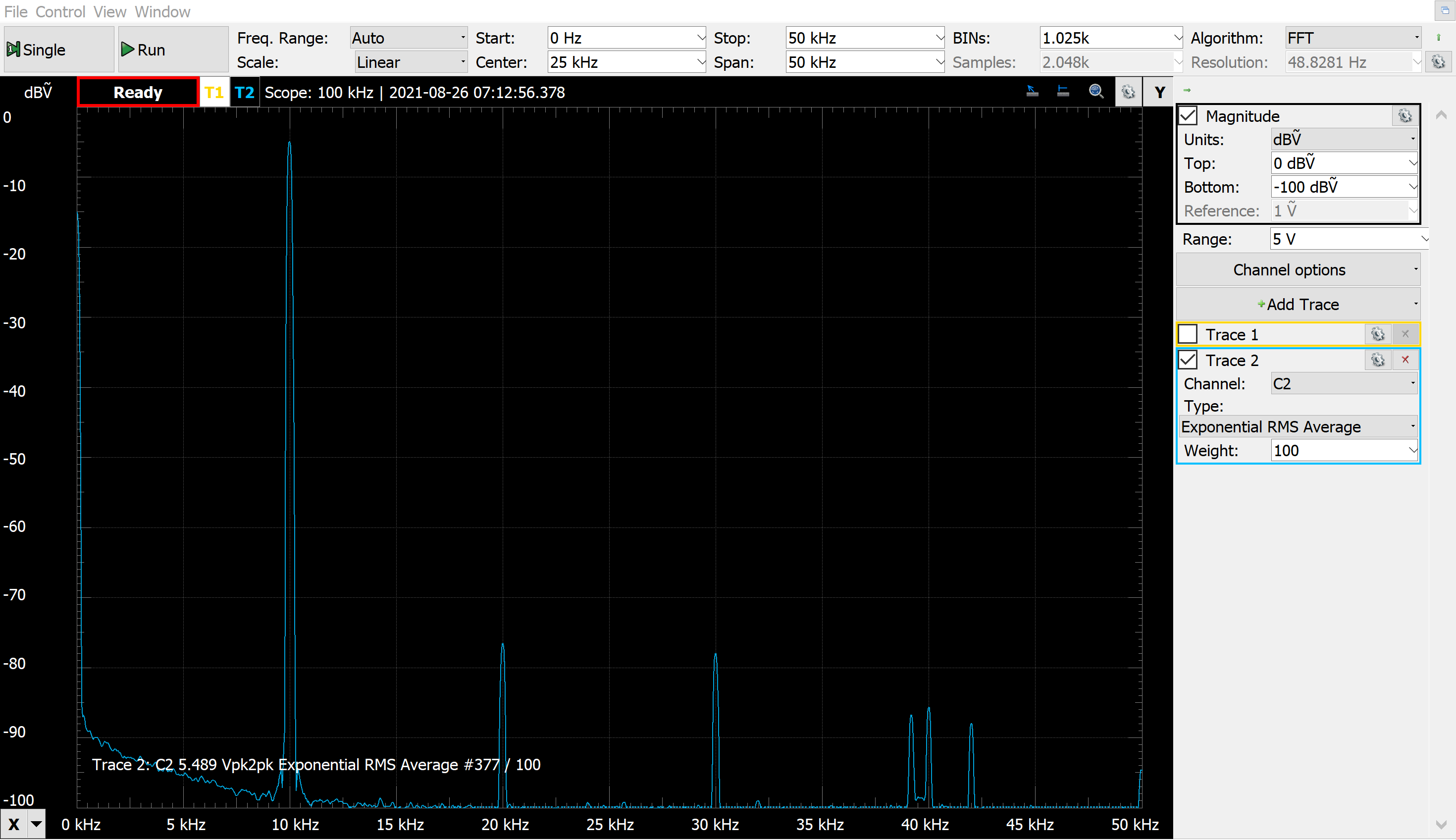

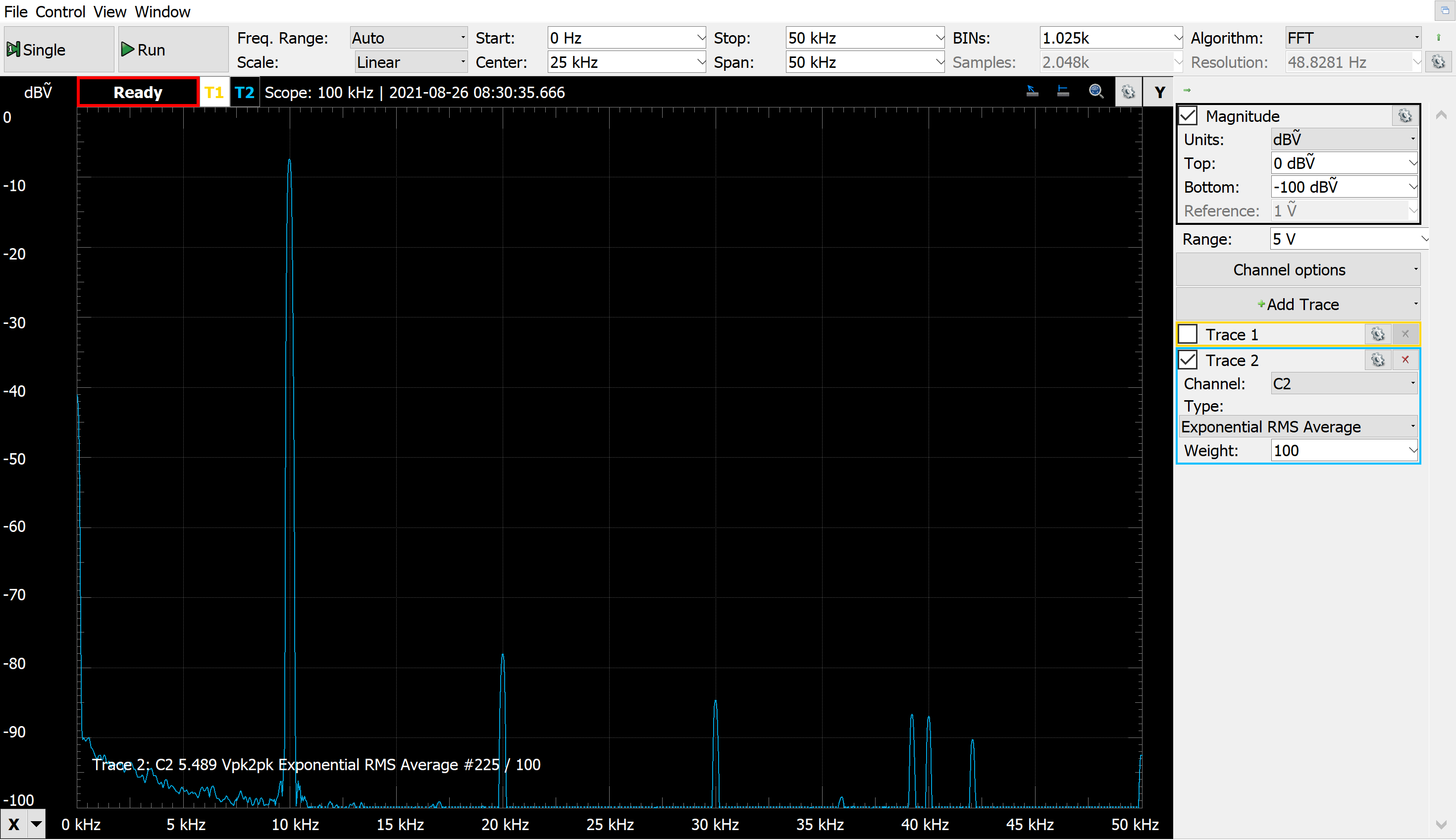

Attached is a schematic, generator baseline, output stage with feedback bypassed, and output stage with feedback. For the generator baseline, I set a scope to play a sine + DC offset into a DC coupled gain of 10 amplifier. This amplifier drove the output stage under test. The concept works nicely (tested with a bias of about ~20mA), resulting in about 10-15dB measured distortion reduction of the output stage with local feedback being reduced to the generator baseline. Results are shown for 5VPk or 10VPk-Pk into 8.2Ohms.
EDIT -> clarify difficult to read plots (better measurement is shown in post 4 with sound-card/global feedback)
Generator Harmonic 2 = -71dB
Generator Harmonic 3 = -72dB
Generator Harmonic 4 = -81dB
Output Stage (NO FB -> FB) Harmonic 2 = -59dB -> -71dB
Output Stage (NO FB -> FB) Harmonic 3 = -69dB -> -77dB
Output Stage (NO FB -> FB) Harmonic 4 = -70dB -> -80dB

Some unexpected things came up with this development. I needed to set the Miller capacitor C1 higher than I thought to be stable. Initially I attempted a >1MHz bandwidth, but I settled on about a 400kHz bandwidth. I also needed to add R7 which helped the circuit find a good DC bias. The circuit feedback using R1 adds a bit more base current to drive this output stage from the VAS, but it is not terrible due to feedback making this fairly constant.
I added Q2 and R6 to increase linearization in simulation, and bypass C2 to control high frequency impedance. I also added zener diode D1 to clamp the output. I used high voltage transistors, but if I can establish the zener does not increase distortion, then lower voltage parts are potentially allowed. Unfortunately, I have reached the measurement limits of my current oscilloscope setup (Digilent Analog 2 + rat's nest) so I did not measure the distortion contributions of these circuit elements.

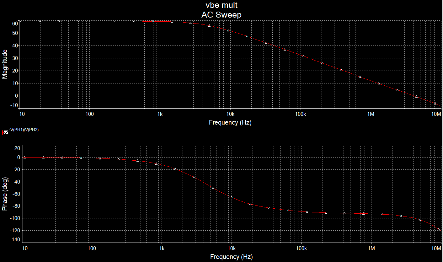

Thanks for the vote of confidence on the bandwidth. I changed the local miller capacitor to 100pF || 100kOhm, and obtained stable operation with about 1MHz bandwidth and 37dB total local loop gain.

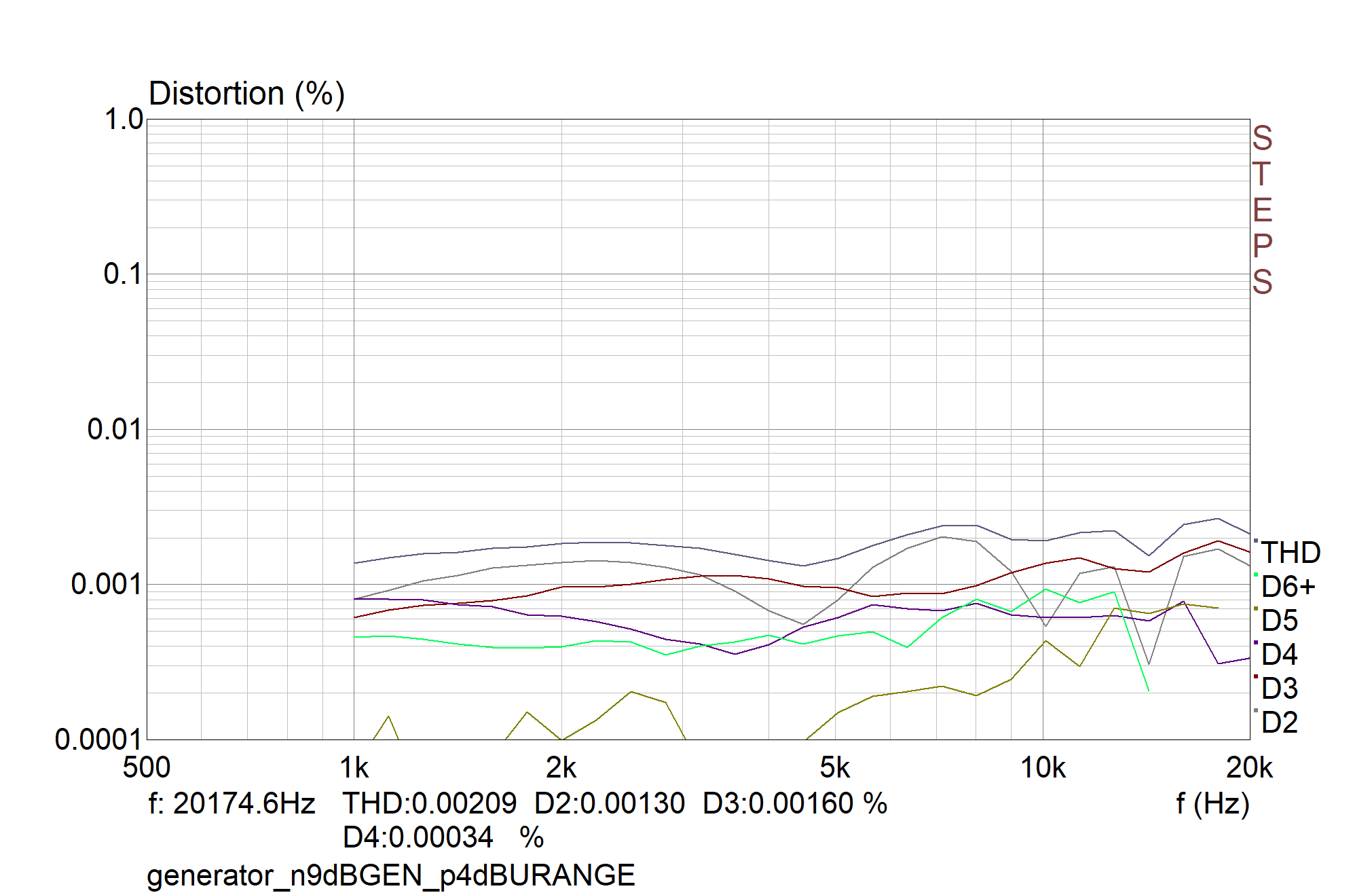

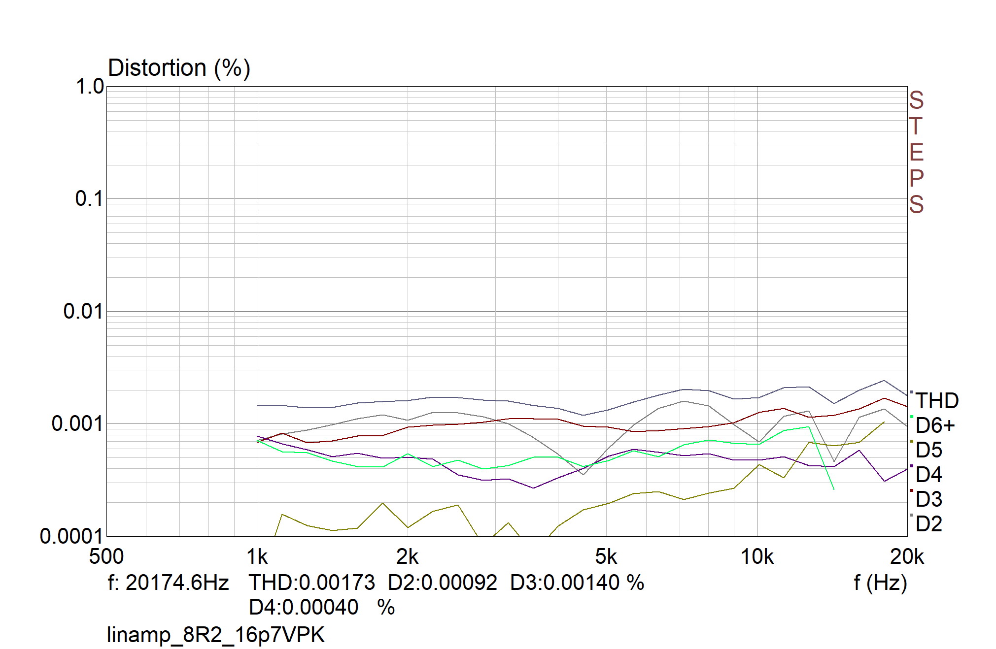

Here is the distortion performance measured using my sound card (RME UCX) to measure the complete amplifier with global feedback. Level is 11.8VRMS into 8.2Ohms which was selected to respect the voltage and current protection limits on the prototype. Measurement sample rate is 192kHz (or 96kHz Nyquist).
The first picture is the sound card loop-back at those levels. The second is the measured amplifier performance, which is indistinguishable from the sound card loop-back. I believe the minor differences in levels (the plots are not mixed up) relate to the gain/attenuator used on the test article.

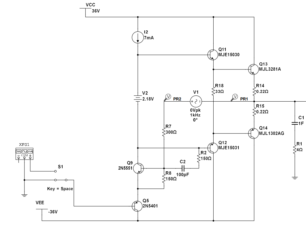

Here is what I came up with.

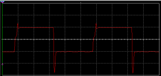

Near 60dB local feedback. Output stage is biased at 100mA. Generally, the more bias, the more bandwidth.
The unit loop gain frequency is around 4MHz. Serial a zero-nulling resistor with Miller cap is kind of required to get extra bandwidth of it.

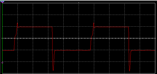

I also simulated square wave, you can see there is overshot, but there is no ringing (almost). If you put it behind a normal VAS (limited bandwidth), there should be no overshot.
BTW, that's 100KHz square wave.

I figured out that if you only involve 2 components in the feedback, you don't need Miller cap, and it is unconditional stable.
Here is my latest implementation. NFB with Vbe Multiplier, Better Than CFP?
