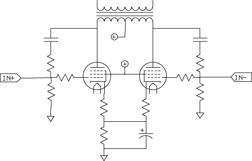

Does anybody have strong opinions/suggestions on implementing local feedback on a push pull amp -- likely EL84 based. For various reasons, I am interesting in playing with a circuit stage by stage, so I'd like to leave the driver out of it for the time being. I have seen plate to grid feedback done via resistor + cap, and I am wondering if this is preferable to connecting OPT secondaries to the grids via just a resistor (which seems more likely to correct for OPT distortion) or if there are other ways I have not thought of.

There are any number of ways to implement lNFB. The implementation you showed is the one I used with the Vixen design that used PP 807s as finals. DC isolation allows for increased design flexibility, as you can operate without the lNFB loop to see if it's necessary and/or how much it improves sonic performance. Just make sure that your DC isolation capacitor has a generous voltage rating: VDC + Vp + safety factor.
The thing to keep in mind always when doing plate/grid lNFB is that the feedback loop increases the load on the driver. You may have to include a grid driver follower to isolate a gain stage from that increased load. Miller Effect will decrease the effective size of that feedback resistor the same as it does the reverse transfer capacitive reactance, and by the same factor (1 + AV).
You could opt for some form of UL, the most common being a direct connection between the screens and a tap-off of the OPT primary. This requires finals that can operate their screens at the same potential as the plates (6V6-oids here, 50C5, 50L5, etc). Otherwise, UL requires either a separate tertiary for the screens or the use of a MOSFET follower to supply screen current at a lower DC screen potential. The main problem with most forms of UL is that it can't be adjusted, and you have no choice but to hope the designers of the OPT got it right for your choice of finals.
The other possibility is cathode feedback, if you have an OPT with a balanced secondary (or you can fake it with a multi-tap secondary). This, too, is limited in that the secondary voltage is dependent on the load impedance. You take what you get.
All lNFB implementations accomplish the same things: reduce the effective plate resistance, compensate for nonlinearities, make the dynamic characteristics of a pentode more like that of a triode. Whether it's necessary or not depends on what finals you're using. Types like the 6L6-oids need the extra help as they tend to make a lot of the nastier high order harmonics. I found that 6BQ6GAs (TV HD final) like the 6V6-oids, make mainly h3 and really don't need lNFB. Just enough gNFB to take the edge off.
Something like 5-10% cathode feedback, depending on what you want/need, by means of OT windings. I find it is more practical, "easier" and effective than plate to grid feedback in most cases.
You could use the transformer secondaries to do this if they allow a symmetrical layout (each side with the right phase) and the center tap grounded (where you connect the negative of the speaker). You will waste some efficiency but it can be quite cheap!

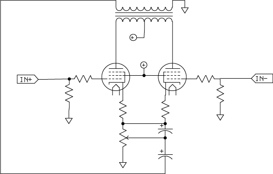

I do like the idea of cathode feedback, but the secondaries on these OPTs don't make it easy. One work around for that was something like the attached to allow for some adjustment. The biggest concern there (which is also a concern for running the secondaries back to the grids) is that it makes switching between the 8 and 4 Ohm taps involve some sort of switch, rather than just wiring them both up with a extra speaker post.

Perhaps one needs to repeat the difference between UL and "outside" feedback regarding pentode output stages.
With outside voltage feedback the pentode still has pentode internal characteristics - it does not know what happens outside and will exhibit the same disadvantages regarding sensitivity to un-uniform load etc. Yes, these are reduced by the feedback factor but still exist, if to a lesser degree.
In UL the characteristics of the tube itself is altered. It has a more triode-like appearance, e.g. with internal resistance (rp) much lower than that of a pentode, thus its distortion less dependant on an alien load. (This is inter alia well illustrated in graphs for the KT88 for various percentages of screen tap - I regret not having the reference at hand now.)
There are no distinct 'optimal' taps for UL. The characteristics change smoothly as the tap point increases, and the preferred point is of one's own choosing, although maximum available output generally starts to fall sharply above some 45% taps, thus negating the advantages.
For that reason I rather prefer using a screen-tapped OPT than an equivalent amount 'outside NFB'. (This apart from the more demanding driving impedance.) It does of course mandate the same voltages for anode and screen.

You might also get cathode feedback to work by using your original scheme, but cross-coupling; from tube A anode to tube B cathode, and vice-verse.

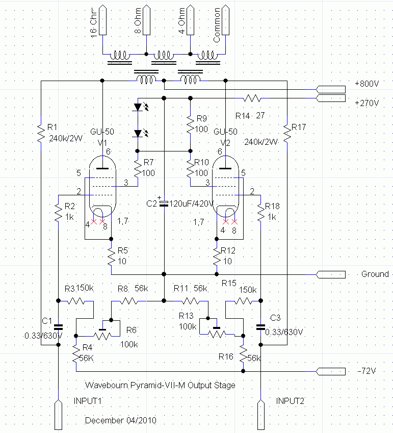

My amps are built on similar principles - but with more Plate to Grid feedback. They certainly deliver without giving up on detail, but gaining massive bass authority.
Shoog
800V of Ub yields a max of nearly 1600V max signal amplitude. This is far too much feedback and needs to be attenuated.
Furthermore, this kind of feedback (parallel derived, parallel applied) can make things a lot worse because it lowers the input resistance (and of course, also output resistance). If you you don't have a dead stable driver with very low r-out, you will increase distortion.
A constant current, ie pentode driver, is the correct approach to driving the feedback grid node.

I think the "input 1" in post 16 above, where the feedback R is applied, was intended to be the plate of the previous amplifier stage. Not a user input.
The shunt Fdbk does indeed lower the impedance considerably at that point as the-manta said. Hence the usual driving it with a current source (or pentode). A true voltage source would swamp out the feedback. That pentode needs to be very much linearized though.
The most accurate place to send the shunt feedback resistor back to would be the cathode of the previous driver stage. Then it lowers the Z in a useful place, and then compares input V with output V in the most accurate sense over both stages. Unfortunately that arrangement seems to sound "worse" to many, since it removes much of the low harmonic distortion "tail", and so removes the mysterious "detail" feature. No tail, no detail. You can always just lighten up on the amount of N-Fdbk though.
