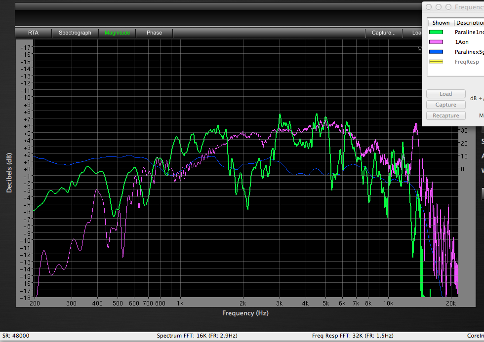

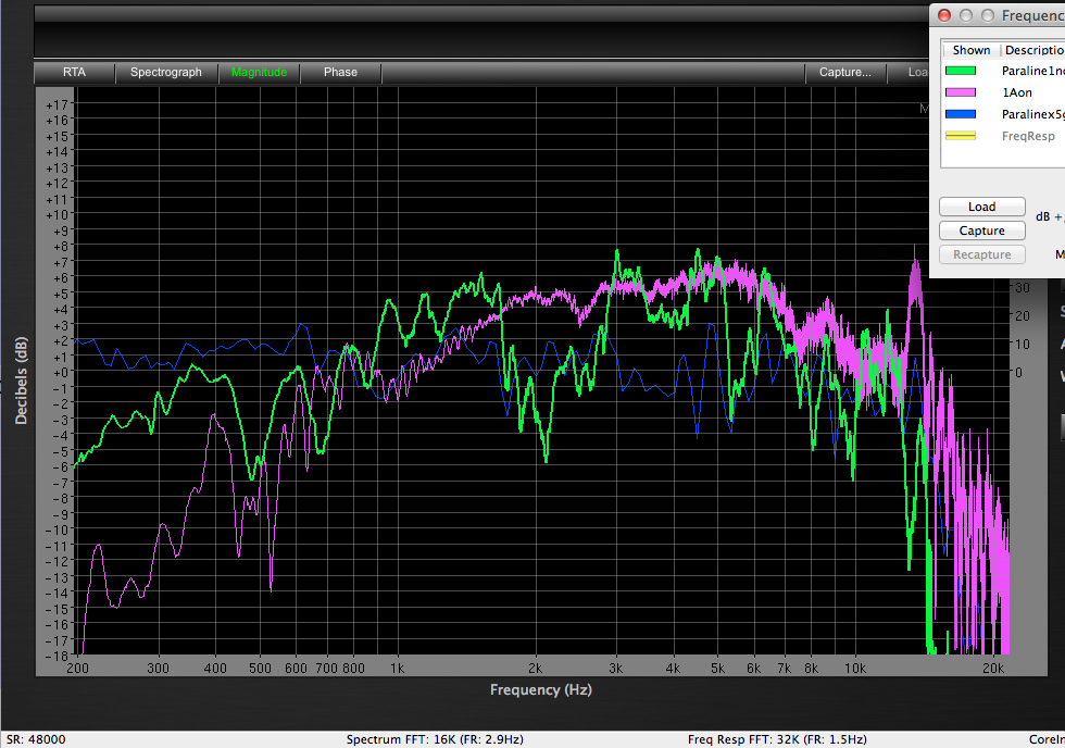

1) Your problems will be made much greater using separate mid and HF drivers and horns in a line array. Though I have fond memories of the 2482, I would not consider it (or any other driver not going up to around 16 kHz) for line array use.
2) The 8" mid drivers cross over to the DH1AMT/Paraline acoustically around 1000 Hz, the electrical crossover for the mids is lower.
3)The Paraline makes the frequency response far rougher than it would be on a conical horn. I don't recall saying "slightly altered", though the response can be corrected with EQ, the deviations are fairly major as can be seen in the comparison of a DH1AMT on a conical horn, on a Paraline, and 5 Paralines with mids equalized. Both non-smoothed and smoothed (as seen in most charts) are shown.
With EQ correction, nothing "weird" about the sound quality, and the pattern control is excellent, so everyone gets to hear a very similar presentation even though multiple drivers are used.

Thanks Art! The graphs are quite interesting. How do you think these deviations actually occur? (Damn, I haven't gotten through the whole "square pegs" thread yet ;) ) Are they simply cancellations/peaks caused by the dimensions and shape of the paraline path?
