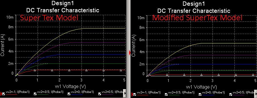

Someone had posted a DMOS model for the LND150 on another forum. I've taken the Supertex info and re-worked it a tiny bit to come up with the following changes to their NMOS Model:

I don't get it, supertex makes a whole library available, and LND150 has a model in it too (see below). Was there a problem with their model?

It turns out there was (and still is) a problem in the model from the Supertex website. There's an "O" where there should be a "0".

BTW There is a LND150 VDMOS model in LTspice by adding Alexander Bordodynov's (standard.mos) library here For LTspice users. Libraries of models, examples, etc
Or add the following to your circuit in LT-XVII
Code:
*VDMOS (c) Copyright Ian Hegglun Jul 2019
.model LND150h VDMOS (Rg=100 Vto=-1.4 Lambda=0m Rs=70 Kp=3m Ksubthres=95m Mtriode=0.6 Rd=300 Bex=-2 Vtotc=-5m Tksubthres1=3m Trs1=2.6m Trd1=3m Cgdmax=5p Cgdmin=3p a=0.3 Cgs=3p Cjo=15p m=0.7 VJ=0.75 IS=15p N=1.5 EG=1.1 Rb=100 Vds=400 Ron=600 mfg=IHKT1911) ;LT-XVII
For LT-IV and LT-XVII
Code:
.model LND150_ VDMOS (Rg=100 Vto={-1.4-(5m-1m)*(Temp-25)} Lambda=0m
+ Rs={70*(1+2.6m*(Temp-25))} Kp={3m*((Temp+273)/(273+25))**-(2-1.5)}
+ Ksubthres={0.095*(1+3m*(Temp-25))} Mtriode=0.6 Rd={300*(1+3m*(Temp-25))}
+ Cgdmax=5p Cgdmin=3p a=0.3 Cgs=3p Cjo=15p m=0.7 VJ=0.75
+ IS=15p  N=1.5  EG=1.1 Rb=100 Vds=400 Ron=600 mfg=IH1911)
The VDMOS model has some extra features that the Supertex model doesn't have like good subthreshold conduction and Mtriode and variable junction capacitance, but the Supertex LND150 has ETA=0.1 (similar effect to Mu of a tube) which the VDMOS doesn't have (but it can be approximated by say Lambda=2m).
