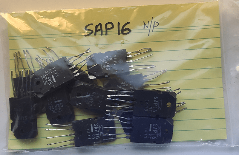

Those are the one's which would regularly blow the emitter resistor! There was an elektor article using them and the LM4702
Yes, I just saw your old post from 2007.
Better stick with conventional darlingtons then.

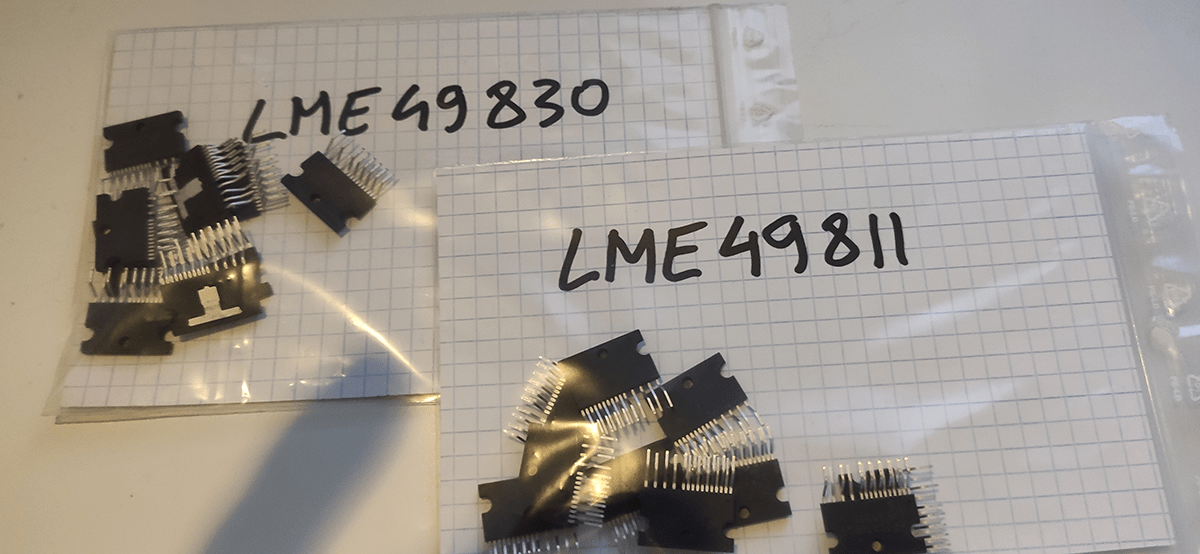

I still have some Sanken MP1620/MN2488 which were popular with the LM4702.
They should work with the LME49811 as well.

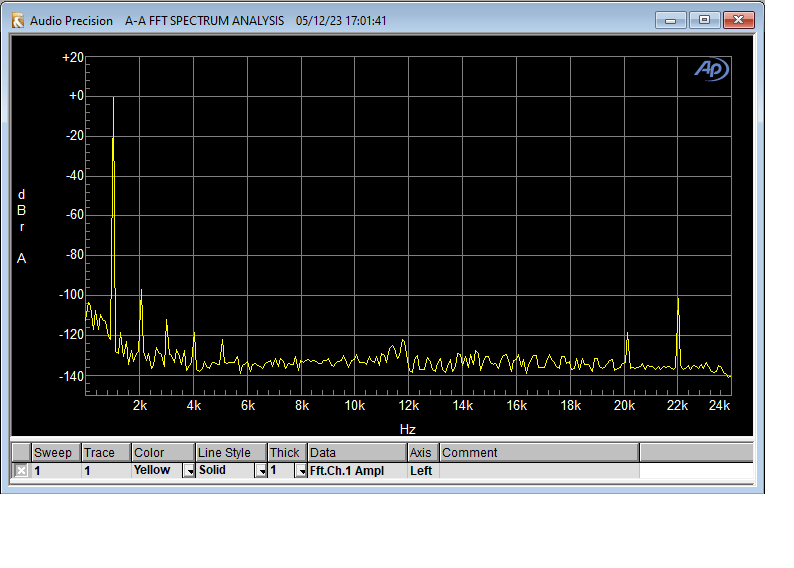

After the discontinuation, I tried to use the 49830 to drive the BJT output stage because the qualified 49810 was not available on the market.
49830+EF-II output stage, connected to resistive load can measure THD+N 0.000X%

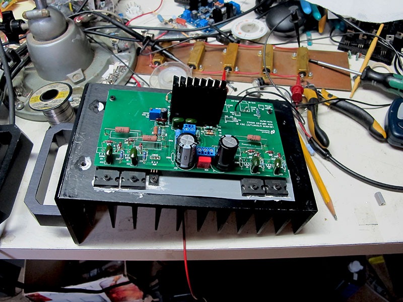

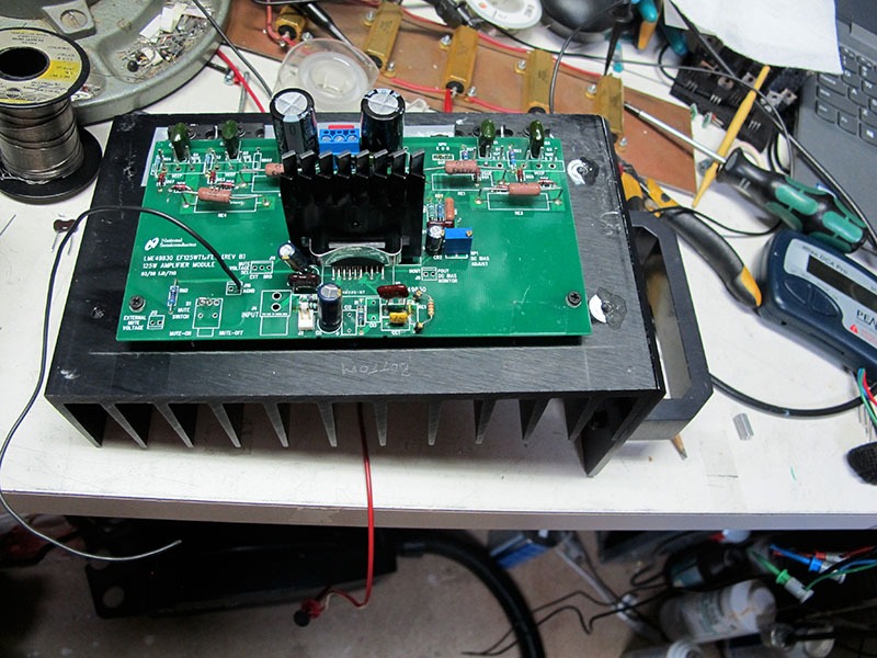

The compensation certainly isn't "set and forget". I am getting slew rates of 23 V/us on one channel and 27 V/us on the other.
and while I am at it -- one of the DIYAUDIO contributors worked on the development of the LM4702 and wrote an application note "LM4702 Driving MOSFET Output Stage" in 2007. (Now Texas Instruments AN-1645). He mentions that the P and N channel Ciss differ quite a bit, suggesting that the gate stopper resistance value and Ciss time constants match up. This will benefit from matched slew rates! It's a bit fetishist for some.
I had to tame the channel which was slewing at 27 V/us -- it would occasionally go unstable. CComp was increased to 47pF

In the 6th edition of Douglas Self's "Audio Power Amplifier Design" he has several graphs (Figures 11-21,22,23) illustrating the benefit of 2-pole compensation. It is peculiar that one of the channels using the NatSemi EVM would require more compensation than the other. 47pF cuts the slew rate more than 50% Time to try something new.
