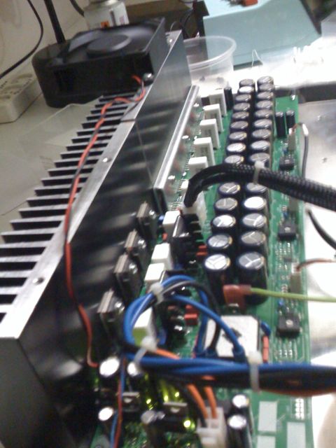

Dear,
Here a image of our prototype.
It is a 3 channel amplifier, with variable gain preamp section. 2x LME49810 + STD03 for mid and high, and BPA300 LM3886 for the subwoofer section.
In the final model I we consider to make the subwoofer amp also semi discrete with a bridged/parallel LME49810/STD03 combination.
Like Andrew point out many times on other sections on the Forum the heat dissipation of the LM3886 is a limitation, hence the fan on top of the heatsink 😀
With best regards,
Bas
