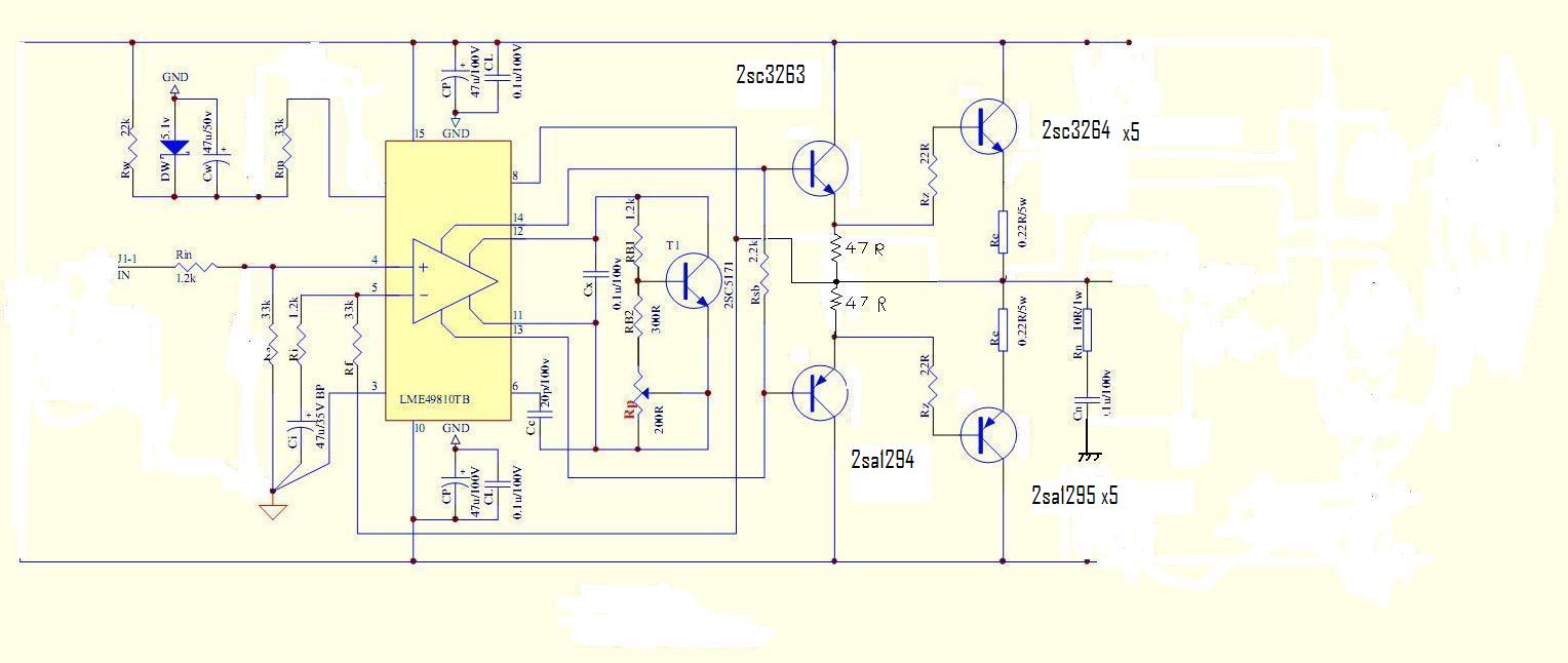

this is my schematic
Dear bobodioulasso,
Thank you. Two questions out of interest.
1: How you came up with the Ccomp of 20pF? Did you test this or was it just a thumb of the rule?
2: The Rsb of 2,2K seems high. Did you tried lower values? My feeling is that with Rsb of 2,2K the chip have to produce a lot of current and will drive mostly in class B. Combined with the relative high capacitance, this can cause distortion. Why not stick to the 1K value of Rotel?
With kind regards,
Bas
2k2 is the LME datasheet value.
I finished with 10 pf.(less is better)
No coil in the output.
The base stoppers are 10R (not 22R)
