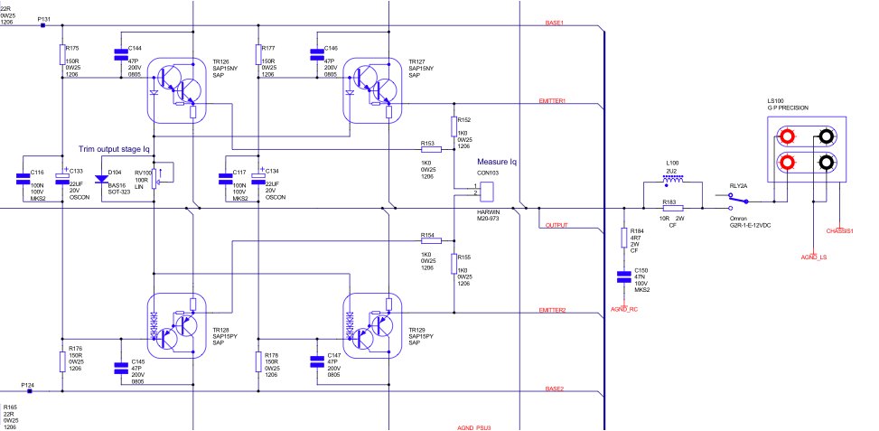

Dear Ken,
This is my application schematic. However PCBs are still in manufacturer. I am expecting to finish my amp in next week. So I will report the results after the first tests...

The ARCAM way (one pot for 2 pairs) has the real risk that each pair has a different bias current, or even guarantee it, unless you match the output devivces, and I doubt they did that (it's expensive in a production environment).
So you probably have one pair that gets hot and another stays cold, and I don't know what the different bias does to the xover distortion. I would use a separate pot for each pair.
Jan Didden
Dxvideo said:An externally hosted image should be here but it was not working when we last tested it.
Dear Ken,
What is the Isink and Isource from that 49811? Sanken specifies 2.5mA per diode string for best thermal tracking.
Jan Didden
9ma is the limit for LME49811 for both sinking and sourcing.. In my configuration, I will measure the Ibb and will set it up to 2.5mA.. I expect to have a good bias level with this Ibb..
