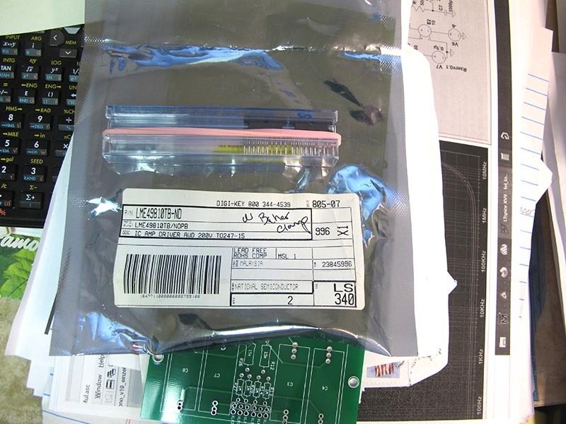

I am trying to fix a classe amp which uses a LME49810, to my dismay, the only sources I find are chinese sellers on e-pay, I bought two of them(different sellers), which don't work, sink and source outputs goes to V-, I found no shorts, I am sure that the amp is not workig due this chip.
if this chip is so marvelous, why has it been discontinued ? and where can I buy one that has no doubts of being genuine ?

PM Me -- a pair from DK

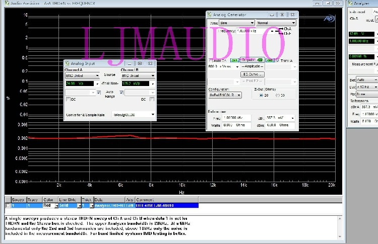

49810 is good. But it is only suitable for beginners.
It doesn't mean much to professional people.

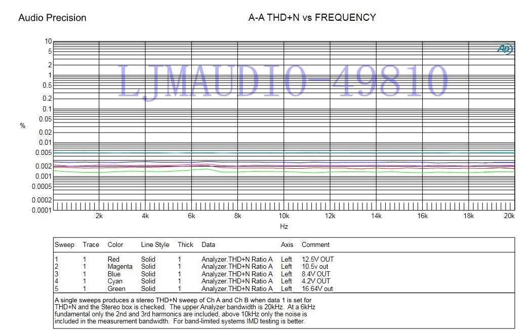

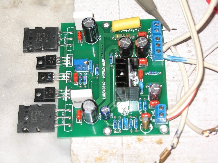

We can replace it with a triode. And the performance is also good.
For example, l20se designed by me. I have tested better performance than LME49810.
49810 is only a voltage amplifying IC. It is not a complete amplifier.
The performance of the 49810 made by most people is lower than that of the IC.

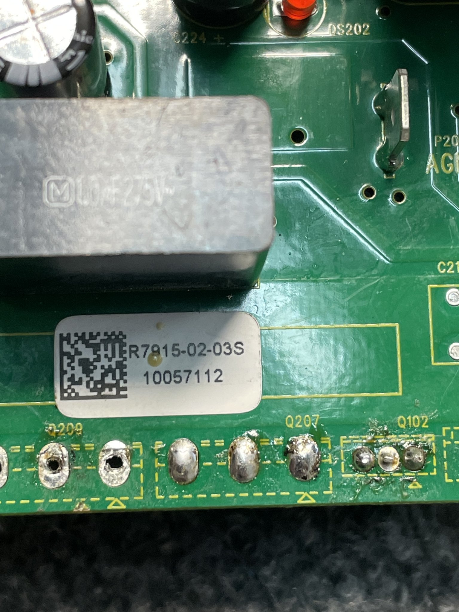

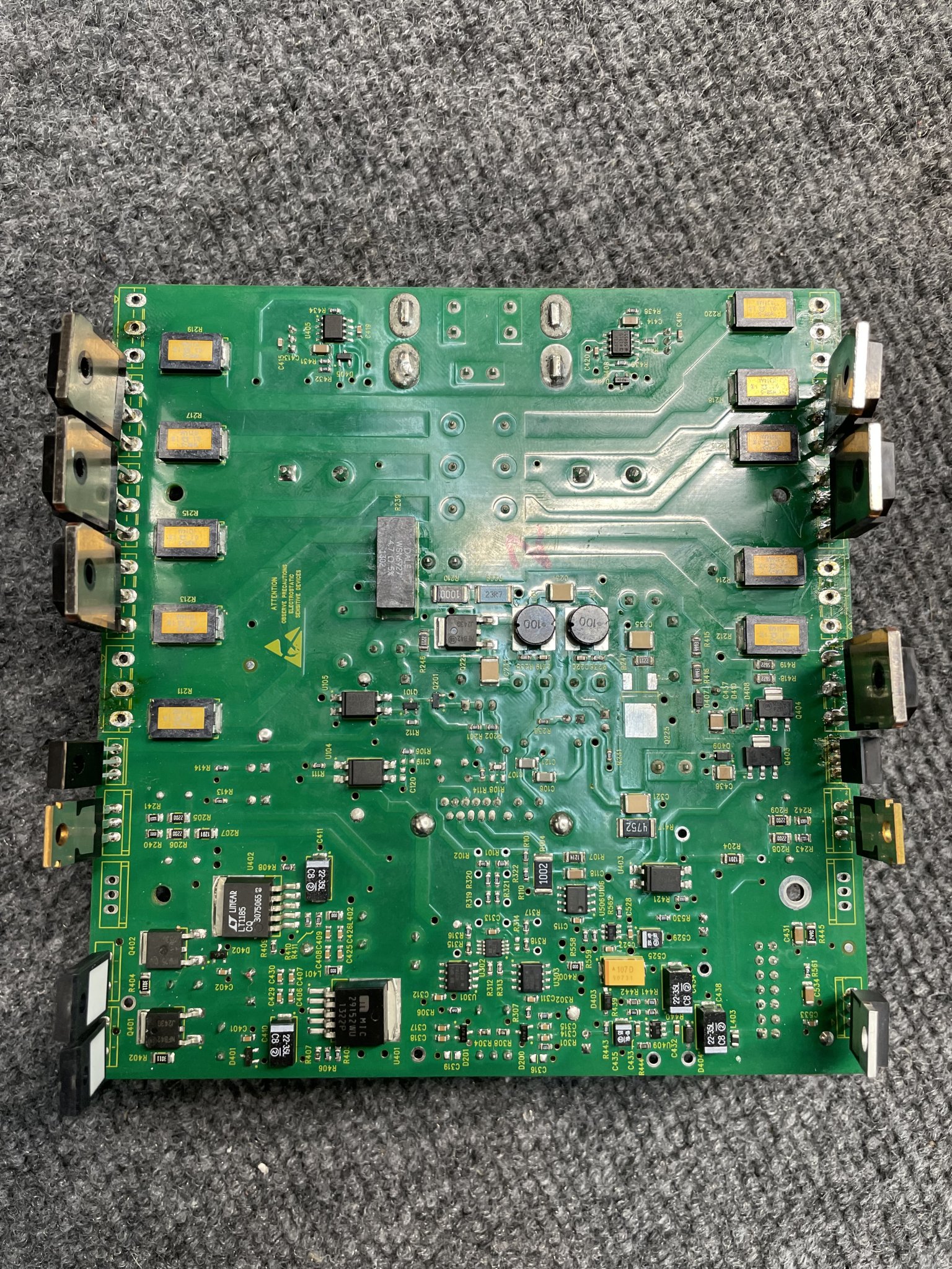

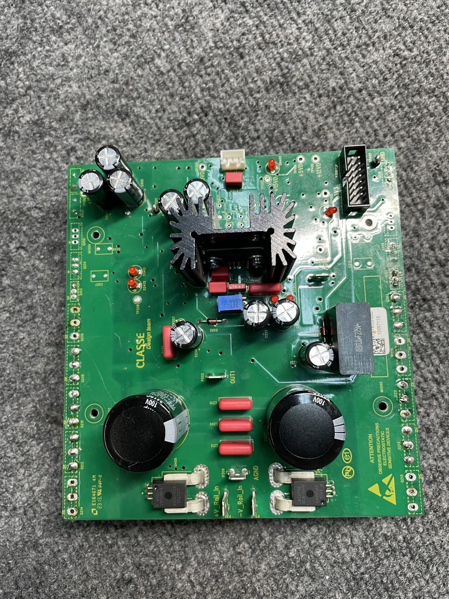

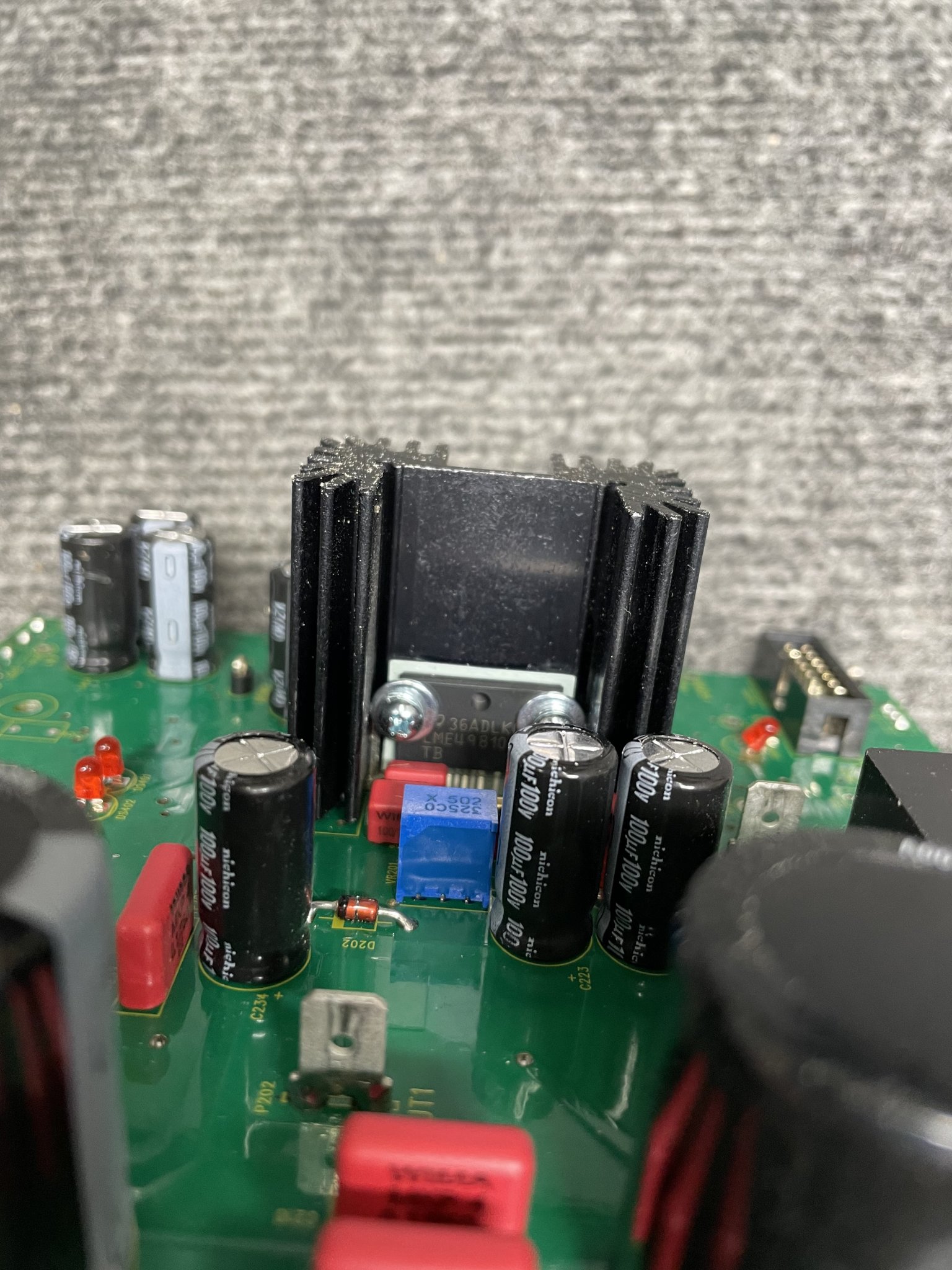

I currently have a Classe CA-5300 that has 2 bad amplifier boards that I am repairing. I need 2 LME49810 IC's ASAP. The boards also have several bad outputs, a shorted 82v zener diode, and driver J253. Maybe we can help each other. Please contact me asap..Jason1238@bellsouth.net.
I am an authorized service center for Sound United.
