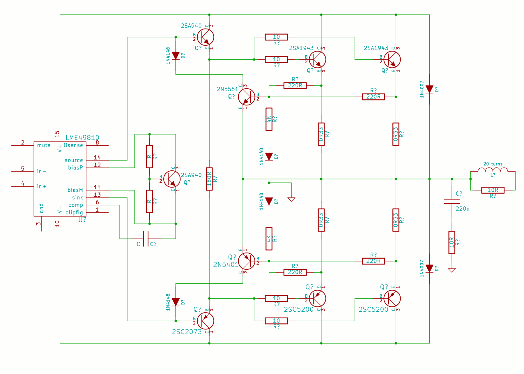

Think this will work?

Can you who follow this thread suggest(and link if possbile proven shematics) the best BJT implementation for one pair of BJT (maybe even darlingtons like datsheet of LME), or emmiter follower?
RARE NJL with thermal sensing diode come out of question because I cant get those easily. I would like to use 2SA1943(pnp) and its complement (npn). Any suggestons and comments about this specific BJT?

1pair of 2sa1943/c5200 running from a 30+30Vac transformer should be good for 70W to 80W into 8r0.
They should be able to withstand the stress of driving a severe reactance 8ohm speaker.
You can get more power from 1pair but reliability at loud levels into real speakers will be compromised, eg 100W to 110W into 8r0 using a 35+35Vac transformer.

I can use than 2 pairs for up to 150W . I presume
what is best way of output configuration ? emmiter follower or darlongton , not single darlington of course, darlington with complementary pairs, more of them
It is usually known that emmiter follower has more distorsion than darlington.
I am looking for complete schematics, that is already tested, but all in all I will draw myself what I plan to make, than you can tell what you think...
no, you need to change the voltage to get more power into the load.
40+40Vac would get to your target of 150W, but I would not use 1943/5200 at this higher voltage, unless you are prepared to pay for the cooling of a 3pair output stage
It is usually known that emitter follower has more distortion than Darlington.
I cannot confirm this.
I would expect a well proportioned double EF to perform better than any integrated Darlington.
If you want to use 2pairs in your output stages, then that allows you to send more current to the load. This might suit 6ohm or 4ohm speakers if you have any.
40+40Vac would get to your target of 150W, but I would not use 1943/5200 at this higher voltage, unless you are prepared to pay for the cooling of a 3pair output stage I cannot confirm this.
Of course, my question is just related to BJT dissipation .. not to voltage..
I do not mean integrated darlington... I mean discrete darlington with more pairs...
1943 is 225 V 15A bjt with 150W dissipation ....
why if we take that current performance is good, why for dissiaption 75W (150W amplifier) would require SO much paralell bjt, you say 4 pairs, is not that too much ?
