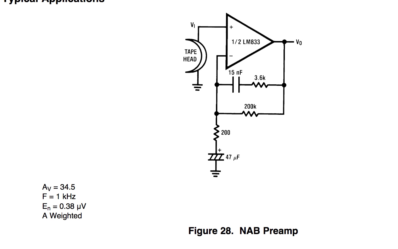

I have what I think may be one of those simple questions that turns out to not be all that simple. I'm building a small instrument that incorporates a variable speed portable cassette player with a tape loop — changing the speed of the motor changes the pitch of the loop. It's been done before. It occured to me that rather than using the cassette player's pre-amp, it might be worth building my own and connecting it directly to the play head in order to streamline the overall build. I have some experience building circuits, but I'm admittedly a beginner (so apologies if I sound like an idiot), and I've been made to understand that tape pre-amps in particular can be pretty fussy.
With that said, I've been snooping around for a relatively simple NAB (I think that's what I need?) tape pre-amp, and there's one on the LM833n datasheet that seems pretty straightforward. (The datasheet is here: https://www.ti.com/lit/ds/symlink/lm833-n.pdf and I've included an image of the schematic). I also happen to have a couple of these ICs lying around. So I'm wondering if anyone has had any luck using this circuit for a similar application (I couldn't find any documentation online of anyone building it) OR if someone who knows more about electronics can eyeball it and tell me if it seems like it would work.
Alternatively, are there other relatively simple, OK-sounding tape pre-amp circuits that sound that I should look into? Or would I be better off using the factory pre that is built into the tape player? I suppose that might be the case, but I can't help but think it would be a cooler final product with a customized pre-amp circuitry.

These are text book circuits and should work well. Remember the opamp needs a split supply (plus and minus rails... at least as it is drawn, you could make it single rail though).
The tape head itself is DC coupled to the opamp input and that is needed to provide a DC reference point for the opamp.

As for the split supply — I figured I'd cross that bridge when I got to it, as I know there's info out there about this. It seems like the supply voltage cannot exceed more than ±15v, so could I just supply +12v and leave GND at 0v? Or is it going to need more juice than that? (Sorry, this seems like an extremely stupid question too — I won't be offended if you tell me to go Google it!)
It is not the so much the voltages that matter but the fact that there is a 'zero volt' ground reference (the 0V) and then a plus and minus supply.
If we used that circuit as drawn on a single rail supply then the opamp would not function because the input (the tape head) would be creating a zero voltage condition on the opamp input.
The opamp (for single rail) needs to be biased to to around half the supply voltage so that the output can swing equally up and down.
So a 12 volt supply would see the output pin settle at 6 volts DC and with the ability to go higher or lower from that point according to the signal.
To do this the input needs to be artificially biased to 6 volts DC and the tape head could then be AC coupled to the opamp.
The opamp output would also need to be AC coupled to remove the 6 volts DC.
(Exactly the same scenario exists if the circuit were just discrete transistors)

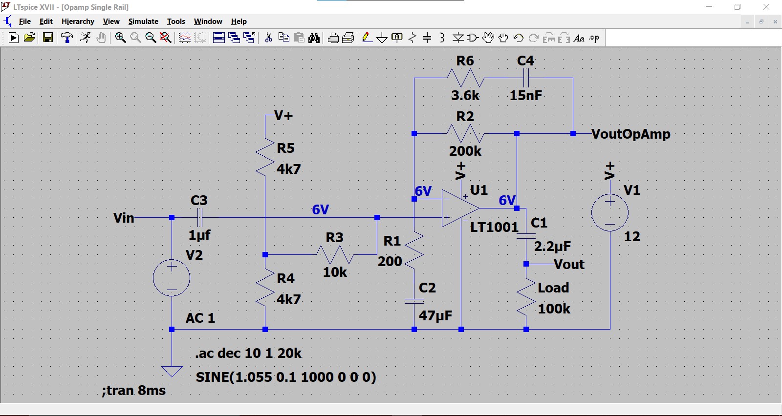

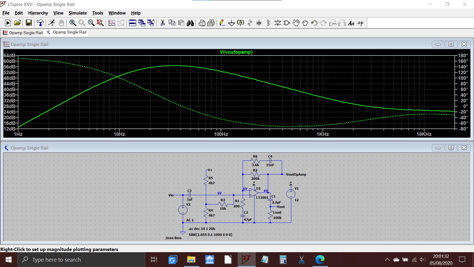

I just happen to have a simulation of a very similar circuit to yours and for single rail.
These are your values plugged into it. You can see the response and gain and also the DC voltages on the chip.
R4 and R5 generate a basic midpoint reference and R3 applies that to the chip. That area would need to be a bit cleaner for your use with some decoupling.
The signal is AC coupled as is the output.

Wow — thank you! That is insanely helpful. All of this more or less makes sense to me, and that schematic is so useful. I guess maybe I'm a visual learner. With this and a little bit of research, I think I'll be in pretty great shape. Now just waiting for the workday to end so I can go try it. Thank you again!!

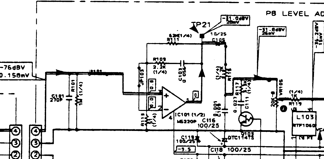

You can try the pioneer ct-777 circuit first for the lowest noise possible if the LM833 can take it(2kohm at high frequency shouldn't be a probem though), if not you can use it with op2227 or op2228 which will be even lower noise .anyway the tape noise will be much higher

That midpoint reference voltage needs to be very clean for a front end preamp and so you have options there. You could for example use a decoupled Zener diode reference. It doesn't have to be exactly 6 volts (for a 12 volt rail). If the midpoint is off by some amount the only difference it makes is that the opamp output is 'off' by the same amount.
So a 9 volt reference with a 12 volt rail would still work but would mean the circuit clipped asymmetrically... the opamp output would only be able to swing 3 volts positive but 9 volts negative.
With a good noise free reference that was well decoupled you would then set R3 (in my example) to give the input impedance you wanted.
Have fun, I'll look in tomorrow 🙂

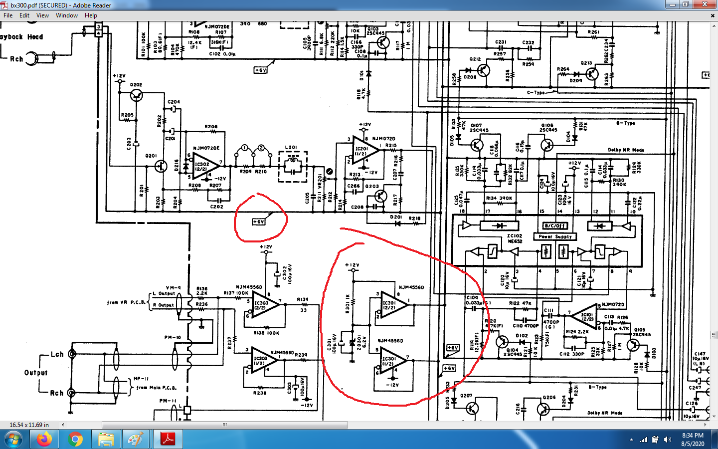

he could go the Nakamichi BX-300 way...

The two opamps show a way of constructing a low impedance 6 volt supply... the reasons why Nakamichi do this seems to be related to the use of the NE562 chip as far as I can tell.
Split supplies are already available on that diagram.
