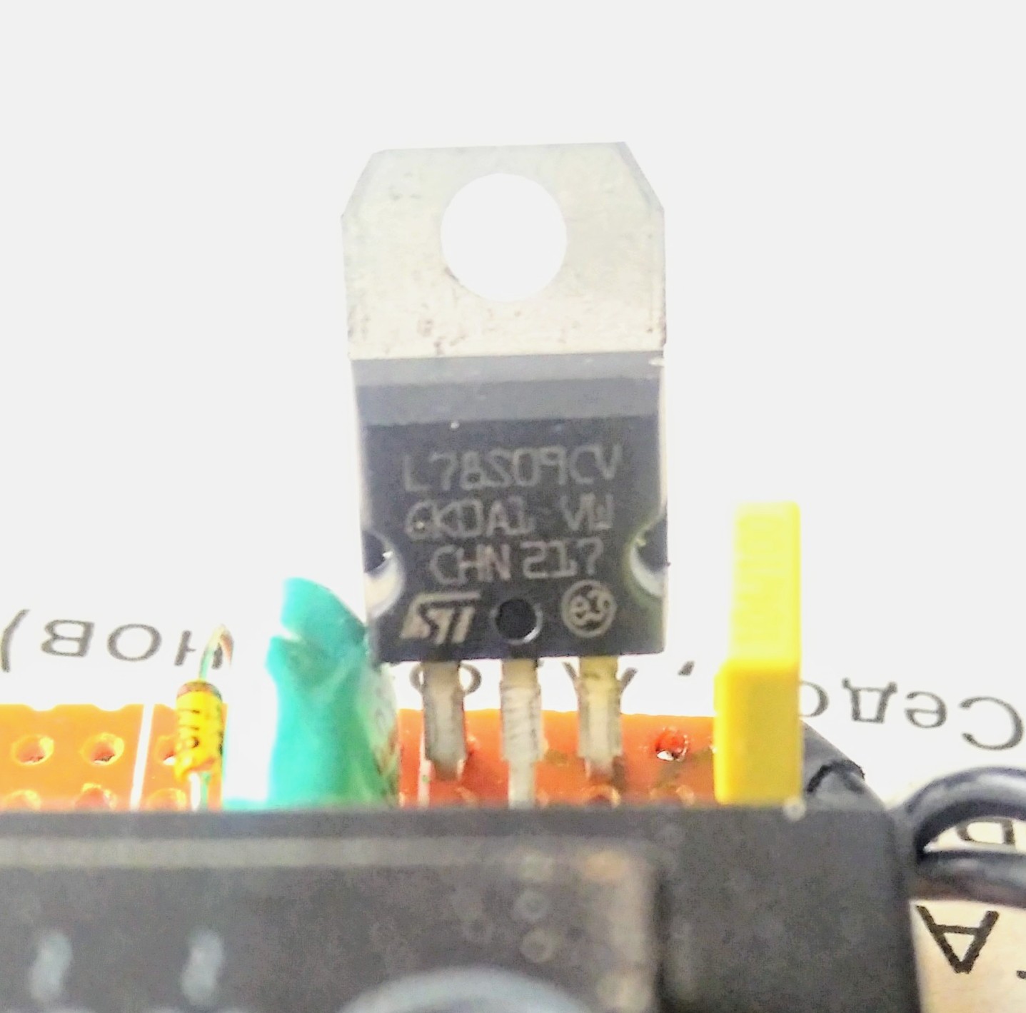

Hi, i am building regulated power supply for guitar effect (compressor).
There is a bridge rectifier (db107) and a cap (4700uF).
The regulator has 220nF at input anf 100nf at output.
There is no hum, but a sibstantial hiss when I run the effect. Putting another 4700 uF at the regulator output reduces the hiss, but still something remains.
There is no hiss if I power the effect with a 9v battery.
Changed the electrolytic caps, but hiss remains.
What could be wrong?
Can I reduce noise further, if cascade 7812 and 7809 in series? (7812 feeding 7809)
Regards

This is the regulator (picture).
Small caps are close to the chip.

Three pin regulators do generate output noise, which can peak in the 2kHz-50kHz range.
The frequency and magnitude of the peak depend on the capacitor connected to the output.
Your audio circuit probably cannot reject HF rail noise very well.
Some three pin regulators do require at least 10uF output capacitance.
Try a 100uF output capacitor, that should be enough to minimize the noise.
Also the input DC voltage must be more than 3VDC greater than the output voltage
for the regulator to work properly.

Hiss is high frequency noise. The 78** and 79** regulators have quite a lot of high frequency noise in the output. The guitar effect unit is effectively operating at microphone signal levels and therefore quite susceptible to noise in the power supply.
The simplest solution is to put a low pass filter on the output of the regulator. This requires a resistor in series with the regulator output, followed by a shunt capacitor to ground. The effects unit probably only draws a few milliamps, so choose a resistor that drops 0.1 or 0.2 volts, say 18 ohms. The size of the shunt capacitor and series resistor sets the frequencies rejected.
Choosing 100 hertz for the corner frequency, the capacitor calculates out to a bit under 100µF. That should give >30dB of hiss reduction from 2kHz up. Put your 4700µF cap on the regulator input to smash ripple at the input to the regulator.

Added low pass at the output (27ohms/ 4700 uf) and it is pretty much done.
If I turn the gain all the way up, it is still quite nasty noisy - above the bass guitar amp floor noise.
But I use it at arount 1/4 gain and difference (effect on/ bypass) is neglible.
No more time for this project, I will leave it like this.
Someday - a better PSU in another enclosure

The thing that is wrong here is using 100nF cap on the output - such a very-low-esr/ low uf part positively-provokes oscillation in these kind of reg (and that's is why adding 1000uf in parallel further downstream may have made things a little better.
NO.
Remove the 0.1uFfilm/ceramic on the reg output - and use ONE cap of 10-100uf or more of basic, cheap, not 'low -ESR', electrolytic; that's all it takes!
That's it, the 100nF with very low ESR at the output makes the regulator sing (aka oscillate). Remove it, replace it with an 100uF electrolytic, and it will shut up.

I had an electrolytic cap at the output from the very beginning.
4700 uf. Such a big value is not recommended for regulators output, but the bigger the better (noisewise, tried).
100-470 uF at output makes no difference, compared to 100nf
Using the output cap in a low pass, makes it signlificangly better. The lower the corner frequency, the better (tried).
Now it is a first order RC low pass @ ~1,5 hz. A higher order would be better, to get the regulator noise bellow the amp noise floor.

1.
With many companies, there are two types of every 78xx and 79xx : A and C. For example, L7809A and L7809C by ST Microelectronics and MC7809A and 7809C by On Semiconductor.
L7809A has much lower noise than L7809C. Also, the regulations are better. MC7809A has the same noise as MC7809C and L7809A. The regulation of MC7809A is better than this of MC7809C. Also, the output impedance of any MC7809 is 1mOhm as compared to the output impedance of any L7809, which is 18mOhms.
Generally, the A type is better than the C type.
2.
No capacitor is big enough. For input and output capacitors, those who want to go crazy, can get a huge Nichicon LS || FW || FG || KZ ( MUSE ). KZ ( MUSE ) is the most important. Any output and input capacitors best be paralleled with low ESR ceramics, such as Murata X7R, NTE ( 100V ), TDK, etcetera. 10uF || 1uF || 0.1uF || 10nF || 1nF || 100pF || 10pF.
Nichicon LS can go to tens of mF.
3.
When the regulators are in regulation, the impedances are as stated. When out of regulation, the impedance is higher as defined by the built in output resistors. Because the output capacitors are big, the built in amplifier can easily go to saturation, driven by the noise. When amplifiers are in saturation, they may be noisy.
5.
As mentioned, 317 can get a good value capacitor at the adjust pin. 78xx, however, has an Aluminium back, which is grounded internally ( and or externally ) and can shield. The front, however, is plastic and cannot.
4.
Internet says the higher the current of 78xx, the higher the noise. The current can be decreased by :
4a. A heavy RC filter and a common collector buffer. The regulation will not be very good because of Ube. Not a big deal for constant current. 7810, 10V, can be used to make 9.3V. An additional Germanium Schottky can be added to make 9V. Consider the tolerance of 7810, though. Type A have lower tolerance than Type C.
4b. A better way to decrease the current of 78xx is to add an overhead transistor ( this is a standard way, well discussed elsewhere and in documentation, see " Output Current Boost " ). A 100Ohm resistor will take 7mA to make 0.7V and 10mA to make 1V. Thus, the regulator will provide only 7 to 10mA and the transistor will add the higher output current. The base emitter current will be provided by the regulator too. TTA004 can be used for low output currents, 2SA1943 for high. MJ2955 is not as good, yet, comes in a better package and can be easily attached to chassis.
