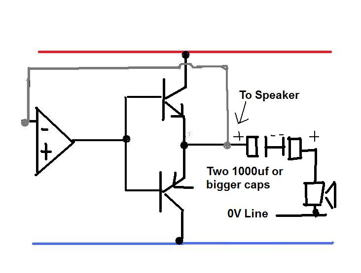

This is the starting point... an NPN and PNP power transistor such as a TIP41 and TIP42
The output of the opamp goes to the transistor bases as shown.
Whatever feedback nework you had connected to pin 6 (opamp output) now moves to the emitters of the transistors.
With any DC coupled amp like this and particularly as you are learning it's imperative that the speaker be protected. That means checking the output of the amp is at zero volts DC with no signal and perhaps adding a couple of back to back electroylitics to prevent damage if a fault or mishap occurs.
Edit... the grey line is the feedback network, missed the resistor out drawing it 🙂

@Mooly, hey, looks smple and nice! and such a simple network guarantees me that the transistor are biased the right way?

I just implemented what Mooly suggested, you can check it out in this Circuit Simulator Applet.
Some thoughts:
1) It seems I don't need any resistor biasing network, probably because one is in cutoff the other is in the active zone and viceversa. Also I didnt notive the zero cross distortion
2) I am surprised that even the gain is only 12, given that the op amp gain is 100. Any ideas why?
3) Also the speaker, represented by a 8hom resistor is consuming only 20uW... isn't that too low?
I feel I am making some little progress, wohoo! 🙂

1. The circuit as drawn is OK, however the 10uf cap needs to be increased to at least 1000uf for the circuit to have a decent low frequency response into 8 ohms. Crossover distortion will be obvious at low levels.
2. I can't figure the simulator result out... I tried altering levels with no success. As drawn the circuit definitely has a gain of 100 at low to mid frequencies.
Both in practice and in the simulator I would use higher supplies. -/+5 isn't much. Use -/+12
I was just looking back at some of the other posts and post #7 by CBS240 shows what would be the basis of the next stage, but you need to get this working first.
