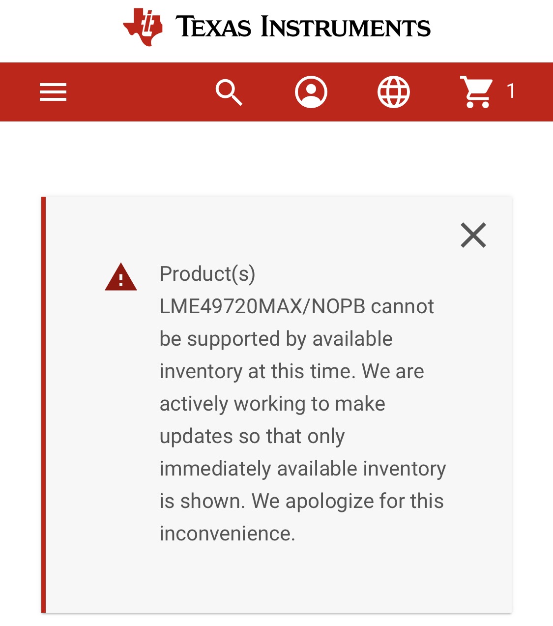

Cool, that’s great information. Thank you… TI‘s inventory display is a bit on the optimistic side though until you get to checkout…
The LME49860 is the exact same part as the LME49720, just binned for higher voltage. I see they're available to order, but cost $3.511 vs $2.133.
The OPA1656 seems to be available and is also a suitable, low distortion, high output drive amplifier. Mouser and Digikey have stock now, only in tubes (not tape and reel).
