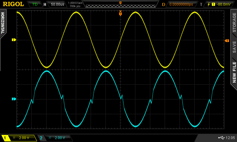

edit- if you're feeling all science-y, you could also include a dual opamp which is known to be terrible for audio: the LM358, with its 1.5V crossover distortion deadband. Maybe if you can't tell any difference among the good opamps, you'll at least be able to identify the terrible one!
