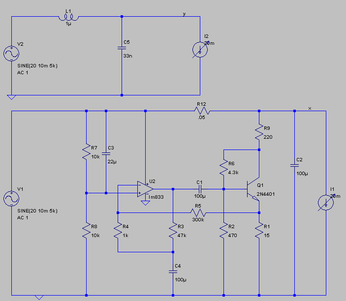

The finesse circuit is not something I would use, but I asked, what the hey 🙂 Regulator is a poor name for it, I think. Active low-pass filter is more like it. It's beyond me why the author would opt for this active filter instead of just a regular LC, LR, or whatever passive low-pass filter.

As for it being which kind of filter, have a look at this.

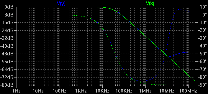

The similarity in frequency response between a regular LC low-pass filter and the finesse "regulator" is quite amazing. Can make them exactly the same this way:

But as that shows no rejection at all in the audio band, you must have got the feedforward gain wrong somewhere. It should show no rejection at DC [0dB](as the feedforward is AC coupled) but then reject 40dB or so across the audio band (according to how well the gain has been adjusted for the particular output impedance).
Sure, it's possible I made a mistake somewhere, since my plot doesn't look like this guy's plot, simulating the exact same circuit AFAIC.

Has your circuit got any DC bias - I see you've got a sine voltage source, but how about some DC too as power for the opamp and bias for the transistor?
