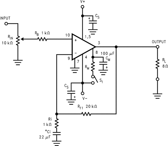

I think he was asking you to connect the resistor between pin 8 and ground (not V-) and measure the voltage across the resistor? .
Where did you get these particular LM3886? Could they be fakes? If purchased on eBay the odds are not in your favor.
Given your supply voltages with a proper LM3886 the chip will unmute when the current into that pin exceeds => 0.5mA, you can use a 20 - 30K resistor to V-.
No DC on the output of your source? (Check with your meter) The Spike protection in the LM3886 does not like DC on the inputs and may mute the chip at some point if present. Input capacitors are not a bad idea regardless. Definitely add an electrolytic capacitor between your 1K resistor and GND. (Non polar type is recommended like Nichicon Muse or similar.)

I was asking about voltage present at pin 8, with >0.5mA current passing through it, so with a resistor from it to -V
Since -V is -30V, you should have 30V/3k=10mA through it, coming from inside the chipamp through pin 8 and you should measure -2.6V (maybe +/-20% would be acceptable) at pin 8 , yet you measure -0.9V
That confirms it is not an LM3886 by any means (or it´s a quite sick one).

According to the simplified internal schematic, there are three diode drops and a 1 kohm resistor internally, so you should end up somewhere around -8.8 V at pin 8 with 3 kohm from pin 8 to V- when V- = -29 V. Doesn't change the conclusion, that -0.9 V from post #10 is all wrong.
The typical performance plots go up to a -10 mA mute current, so the current is not high enough to blow up pin 8 or to bring the chip into some unintended state. I looked in the datasheet because I wondered about that.

Thanks for that. What you've proposed is exactly what I've installed on the power lines. That is, three capacitors to ground on the regulator outputs.i'll try...they are meant to prevent high frequency noise from modulating the supply line of an associated transistor or chip and are generally implemented as close as possible physically to the device. it's not uncommon to see multiple values in parallel across +/- supply lines to ground in order to achieve stability and increase GBP.

I was left thinking that I had made some errors somewhere, each time. But perhaps the chips themselves are down. I do have a previous chip, not from this suspect batch, so I'll wire that up and try again. If I just link up the power lines and input output lines to it I could measure the pin 8 situation like I've just done. Is that feasible, or would you urge rebuilding a new stripboard with all components before investigating?
The bypasses are right next to the chip. Two separate boards, but the connecting wire and track is only 20mm in length and as already stated I have two other amps built in identical fashion that work well.if the bypasses aren't right next to the chip they might as well not be there....every length of wire is an antenna...doesn't matter it seems you do have a bunk chip!

I've now repaired the supply board on this amplifier and wired up an old LM3886 that I found (legs up, bolted to a lump of heat sink).
It works. Yahoo!!
