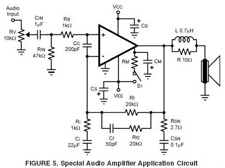

If you gonna do p-to-p I might suggest start from Mick Feuerbacher project as it is, use 100W light bulb in series with your trafo primary. Use some cheap speaker to test your new amp.
Once it's working you can go further with schematic improvements, speaker protection addendum. I would not recommend dealing with more complicated schematics than Mick's one without PCB.
I wanted to use my computer as input source, I am not sure about the presence or absence of DC, So should I go with Mick Feuerbacher's Three-resistor LM3886 chip amp?

I just saw your latest posts, and no, DO NOT build that amp (the "Mick Feuerbacher"), it is totally lacking the necessary components to have a stable, useable amp, and using the DC blocking cap at the input will solve any possible DC input offset issues before they happen (see guidlines below.)
I don't know how much experience you have, but if you follow AndrewT's advice, you won't go wrong (especially on issues of safety)
Here's a set of general guide lines I recommend;
1) Keep lead length and circuit layout reasonably compact, but don't crowd together so tightly that you can't change something later. Keep power supply bypass caps as close as possible to their respective chip-amp pins.
2) There should be three separate grounds from the amp to the power supply "0 volts" (ground); one for the low level input side, one for the on board power supply bypass caps and one for the speaker output.
3) Use all of the components that are sometimes refered to as "optional", they are not if you want an amp that will be stable and operating properly. This includes the input filter to block RF, AC coupling on both input and feedback network with correctly configured high-pass roll offs, power supply bypass with a large electrolytic (470 uF or more) and a small (10 nF to 100 nF) COG or NPO ceramic disc connected directly on the chip amp pins (or as close as possible, I usually put those on the underside of the board to acomplish that), and the output "Zobel" network and inductor.
4) These chips are designed to run a MINIMUM gain of X10 (+20 dB) for stability, in my experience, less than about X15 (23.5 dB) is probably as low as one should go to stay away from the stability margins, and above X40 (32 dB) starts to get into noise amplification territory.
Doing it this way (especially for inexperienced builders) will almost guarantee a good result.

What about this chip-amp?
Mick Feuerbacher Audio Projects
i am confused to select which circuit,

Or this one?
gohar,
Agian, don't build that "Mick Feuerbacher" thing, the kindest comment I can make about it is it's incomplete and most likely prone to all sorts of problems.
The schematic in post #25 is OK if you apply the general guidelines I, AndrewT and others have posted
And yes, that power supply will work fine.

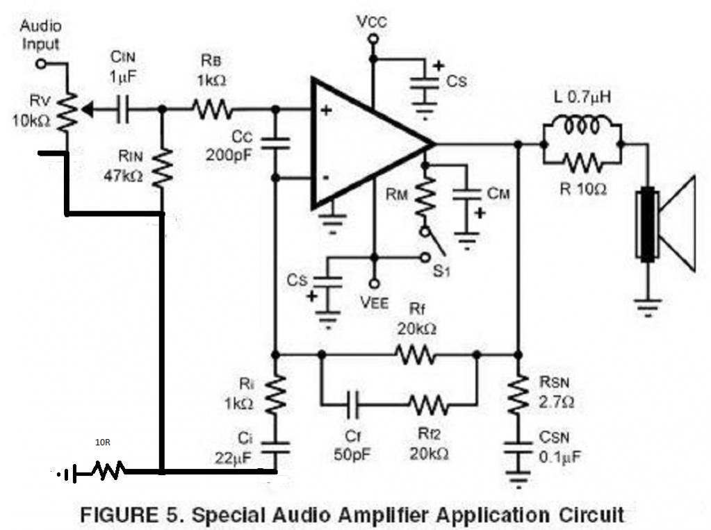

The Signal Grounds are listed in post8.
Audio San drew that description up and posted it in 16.
But, maybe it's you that allege my posts are unhelpful.
Is this another you want to add to that unhelpful list?
Post 8 was extraordinarily helpful, and it not mentioning the speaker ground explicitly led me to resurrect the thread. I might assume speaker ground comes under the mentioned "main audio ground", which seems neither signal nor power, hence the unhelpfulness and incompleteness of your post #29.
Is my assumption correct? Or is it in fact power ground, or some other ground not yet mentioned?
If you are building a monoblock then all except the Signal Ground get connected together.
You can call this the Main Audio Ground (MAG), (my preferred term).
Others may call it the Power Ground.
When building a two, or more, channel amplifier then the grounding ballgame changes.
The Power Ground must be on the amplifier. The Main Audio Ground is likely to be elsewhere. I recommend that the Speaker Return must follow the speaker output lead and traces to eventually reach the MAG.
