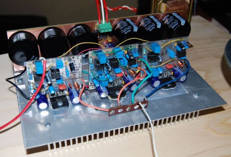

I did a similar thing, back when I was green (well BRIGHT green, I'm still green, but fading to brown 🙂 ). Details here. Mine did not have anything fancy, just the capacity for HP and LP filters, a buffer and the LM3886 on each board.
Original intent was more hifi, but they have been reassigned to a pair of 3-way workshop speakers. Not that they sound bad - they are fixed at ~310Hz and 3100Hz leaving no room for adjustment and they are not quite powerful enough.
