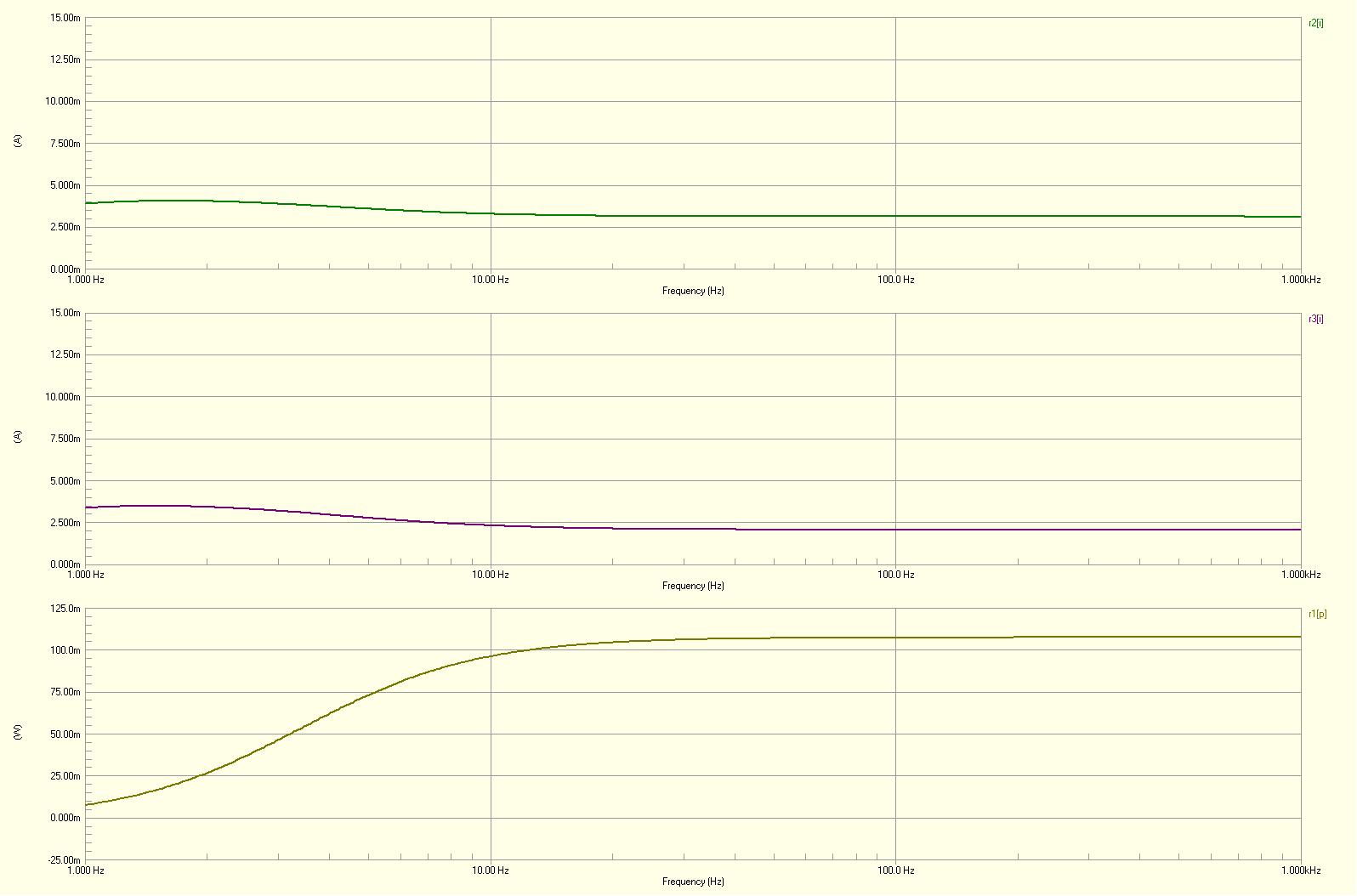

AN-1192 'Good results'
pacificblue has pointed out to us on this thread that the writers of AN-1192 say the following:
1% gain setting resistors (Ri and Rf) will give good results but it is recommended 0.1% tolerance resistors be used for setting the gain of each op amp for closer matched gain and equal output current and power dissipation.
Since I'd already simulated the circuit with the 0.1% Ri and Rf, I decided to take a quick look at what happens when, in place of the recommended 0.1% tolerance resistors, we try 1% types. After all, they do say they'll give 'good results'. So perhaps somebody will be tempted to try with 1% types. As a result of my simulation, the best I can say is don't bother.
If you recall, the earlier simulation gave high frequency (>1kHz) currents from the two amps as 3.4A and 2.3A, corresponding to equivalent impedances of 6.7 and 9.8ohms - a fair match.
With 1% types at worst case the currents turn out to be 7.2A and 1.6A. At first I thought there must be some mistake as these don't add up to the output current (5.7A). The truth is, the current from the lower gain amplifier has reversed its phase - its now pulling current out of the load rather than pushing it in. So now the matching is so bad that the parallel combination is considerably worse than running with a single amplifier.
One possible conclusion is that the 'good results' the writers were speaking about is the financial results of their company - they get to sell two amplifier chips in place of one. No, that's being too cynical....😛 If anyone would like to see what the plots look like, drop me a message.

Remedy for LF gain imbalance
For those still following the AN-1192 saga, the simplest solution to the LF gain imbalance in AN-1192 figure6 is to increase the value of Ci - from 68uF to 470uF. The big lump in the plot at 4Hz then goes away - see the new output plots. The vertical scales have been kept the same as before. There's a barely noticeable rise now, peaking just below 2Hz, nothing much to worry about.
