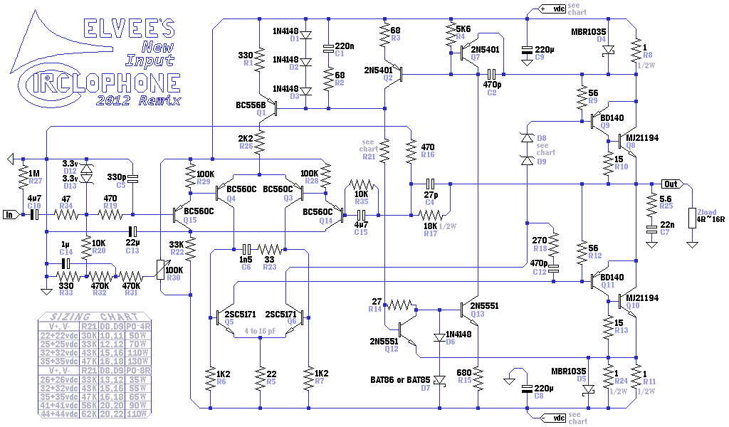

Yes, Marc. The mixed coupled LM1875 was a large group project some years ago. Here's the basic details:Daniel, The title of this thread is "LM3886 without electrolytic feedback capacitor and (hardly) no DC offset voltage". Your post has another subject. Can you do the same with the LM1875 as I did with the LM3886? Marc.
Chip LM1875, amp power caps 470u//100n, power supply board 8x 2200u per rail, transformer 18,0,18vac 4a, input load resistor 10k, feedback resistor 27k, feedback-shunt resistor 820R, input cap 2u and small signal groundlift 2R. It has a high gain of 34, usually 0mv offset and a level frequency response.
I have not made another DC coupled or mixed coupled amplifier after discovering that the dynamics are inferior.
The projects that followed, all had something very much like: 10k input load, 330R stopper, 2u input cap, 2k2 feedback-shunt resistor, 68k feedback resistor, 220u or 330u nfb cap, 2R or greater small signal groundlift.
For amplifier board power caps, TDA7294's want 220u~330u and no mute cap, LM1875's want 330u~470u, and and LM3886's want 680u~1000u and 47u mute cap. Lower figures for the amp board power caps, are facilitated by selecting a just right rail to rail cap power filter, else use the higher figures. Rail2Rail cap for LM1875, LM3886 is Mallory SEK 4.7u 250v from Allied Electronics, and just one per each amp board. TDA7293 and TDA7294 wants a 2u bargain grade high loss polyester for its rail2rail cap. That filter dumps power noise and makes more laid back mids, which eases selection efforts for all other caps. Cleaner power (and cooler amp heatsink) is always worth something.
The NFB cap took some selection effort and usually some bypass cap work to restore a level frequency response; but the extra effort there, paid off in more power, longer life, speaker protection and bigger dynamics. NFB caps are easiest to select when they're big enough for 5hz and when the input cap is not big enough for more than 10hz. Refer to AndrewT on the specifics.
However, a NFB cap does not necessarily balance the load evenly for IN+ and IN-. See the following schematic with 10k-470R load at IN+ (Q15) and 10k//4u7-470R load at IN- (Q14):
Circlophone 2012 Remix (this newer edition not yet proofed)
Both in+ and in- are balanced equally. You've got an offset trimmer circuit on the in+ side. On the in- side the 10k//4u7 has been added to the feedback loop. For sure it wasn't easier than simply using the NFB cap.
