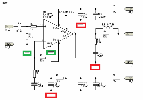

I had an old transformer and got a pair of free lm3886 so I decided to build a chipamp. After doing a little of reading I decided to build the following amp:

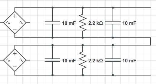

As requested, this is the PSU:

Would the grounds be ok like this:

I think red means points joined together and grounded through one (red?) wire, and green another similar net, using another (green?) wire.
I find the most "dangerous" return the speaker ground, and it always deserves its own dedicated wire, straight to the filter caps junction or the negative if single supply, because of 2 very good reasons:
1) it carries a lot of current and
2) it's audio, in phase with signal, and thus "excellent" to get positive feedback, instability and oscillation. 😱
Or at least weird unexplained distortion.
Correct, the green is intended as signal ground and the red as power ground.

I fixed it! It was a grounding problem. Checked a couple of point to point builds in the forum, notably http://www.diyaudio.com/forums/blogs/wintermute/134-construction-p2p-lm3886-gainclone-part-1.html and realized that I had the feedback cap ground tied to the "zero volts" ground.
So based on wintermute's build, I moved the feedback cap lead to pin 7 and now I can turn it on with everything grounded and measure less than 1mV with no load.
