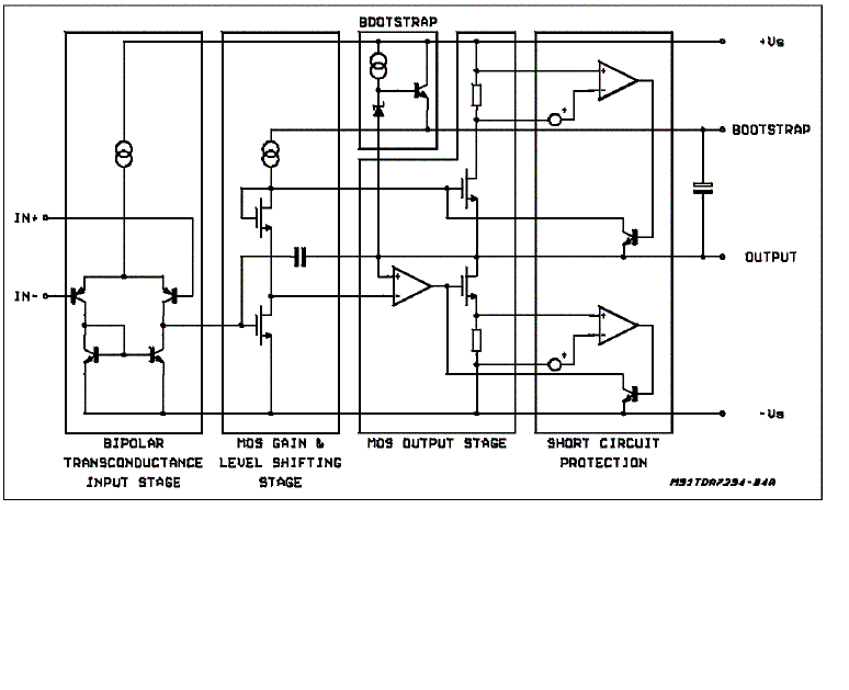

Since you claim you were studying engineering, I'll assume you are correct, but this is what I found:
DMOS is a fabrication process. Double-Diffused Metal Oxide Semiconductor, if you must know the abbreviation (I don't know why HP chose to use a single D). Used to make transistors, switches and diodes as well as FETs and JFETs.
MOS-FET is a specific type of transistor. Metal Oxide Semiconductor Field Effect Transistor. FETs can be made with MOS, CMOS, LDMOS, VDMOS, V-Groove, HEXFET, or IGBT (mixed tech of Bipolar+FET) processes. Therefore you can have a DMOS-FET, LDMOS-FET and so on.
One does not, in my view, equal another. You're the engineer. You tell me.
From the datasheet: To overcome these substantial drawbacks, the use of power MOS devices, which are immune from secondary breakdown is highly desirable. The device described has therefore been developed in a mixed bipolar-MOS high voltage technology called BCD 100.
By that statement I'm guessing they mean this is not a pure MOSFET amp, but only the output stage is made of Power DMOS devices. If it was a MOSFET amp, they would have called it a MOSFET amp.
If I'm not mistaken, this is one type of a hybrid amp (the other being the STK series which mixed integrated and discrete on the same substrate).
Power to you sagar, I'm sure you already know all this and are right on the money about this stuff.
no claim,i m in final year(elect.) now.
DMOS is a fabrication process. Double-Diffused Metal Oxide Semiconductor, if you must know the abbreviation (I don't know why HP chose to use a single D). Used to make transistors, switches and diodes as well as FETs and JFETs.MOS-FET is a specific type of transistor.
but what is the end result of the process,its a FET ,metal oxide semiconductor FET.MOSFET.
these different processes determine how the conducting channel will form in the MOSFET.this allows for MOSFETs being designed for requisite applications.
DMOS process in tda case results in a high power and high voltage mosfet.
for tda input stages r bjt based,the main or the o/p stage is MOSFET made using DMOS process.(to enable high voltage and wattage along with inherrent benifits that MOSFET offers over bjt)
see block diagram of tda i post here
