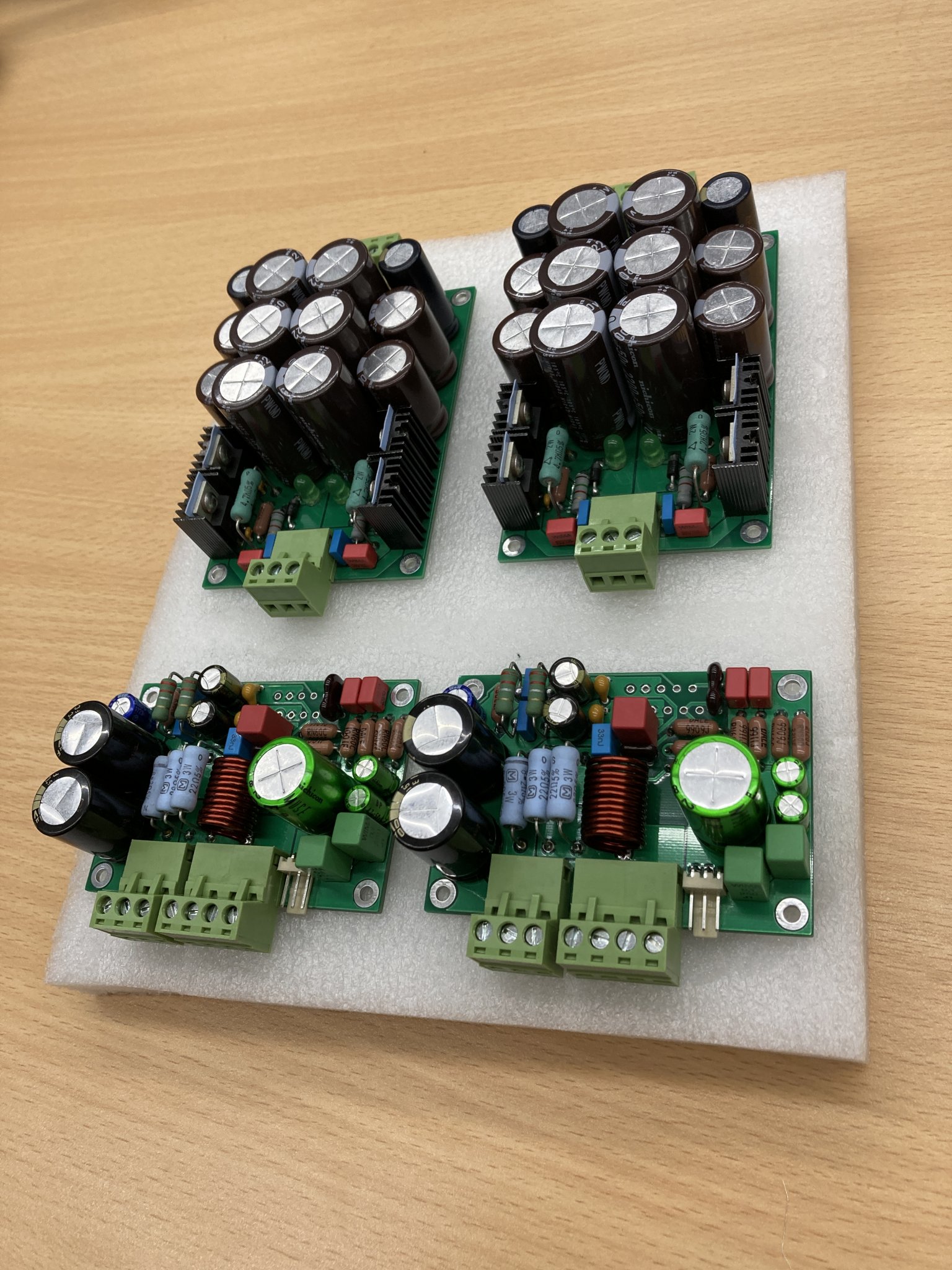

Hi, I need some help to decide which resistor is the most suitable for the Thiele Output resistor for LM3886:
  • Metal Oxide
  • Wirewound Silicone Coated (inductive)
  • Wirewound Vitreous Enamel (inductive)
I only can found 3 type above in my local shop with the value and power rating needed
Thank You and any advice will be very appreciated.
You want a non-inductive resistor for the Thiele network. Its job is to conduct current at frequencies where the reactance of the output inductor exceeds the resistance of the resistor. You want a non-inductive resistor in the Zobel network as well for the similar reasons.
There are many non-inductive resistor types on the market. Metal oxide, metal film, metal foil, and also a few wire-wound types with Ayrton-Perry style winding. Between those types, the metal oxide (or MOX) type is the most prevalent so I'd go with that.
"Non-inductive" should be taken with a grain of salt. All resistors will have some inductance. Non-inductive should really be termed low-inductive. Most wire-wound resistors are quite inductive. I mean... Think about it. A wire wound resistor is basically an inductor with a ceramic core and a specified DC resistance.
Tom
Hi Tom, yes I understand a wire wound R basically is an inductor, when I make this post I have a thought that the output of the amp is gong to passive crossover and the first component for the tweeter crossover is wire wound resistor (after that also voice coil), after some read finally I realize that I should not confuse which part is belong to "AMP" and which part is belong to "LOAD". When I decide to try build this amp, I learn a lot from all Your post / guide here and also NEUROCHROME site, I'm Thankful to You for that, I attach the pic of the build (not finish yet)

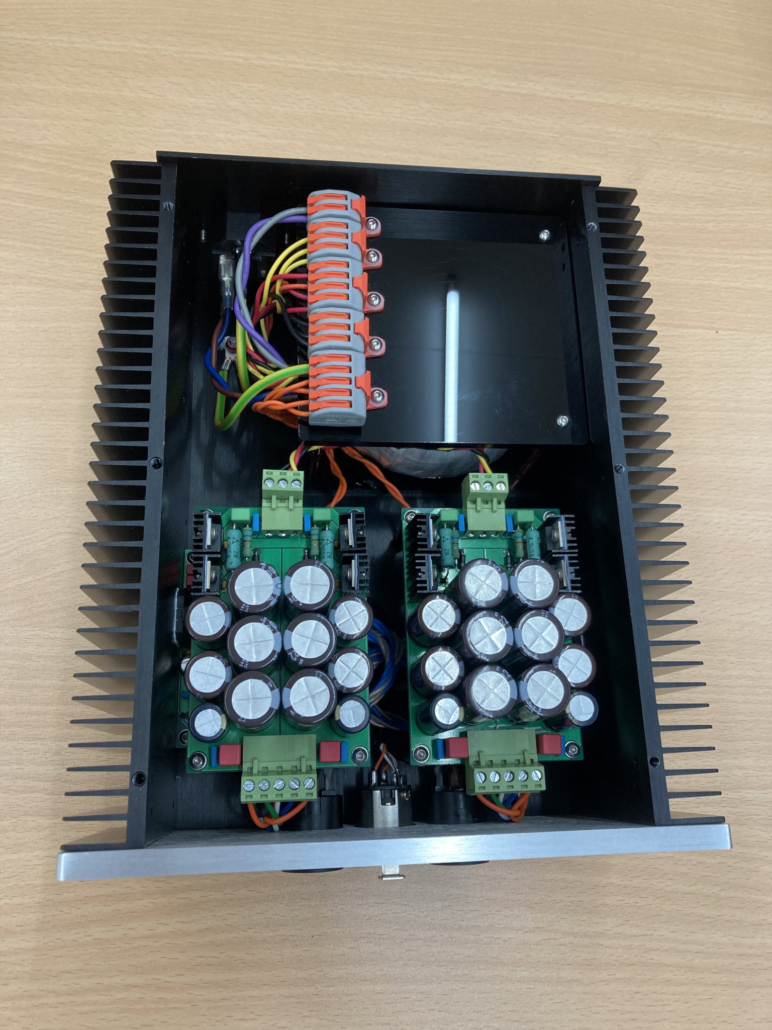

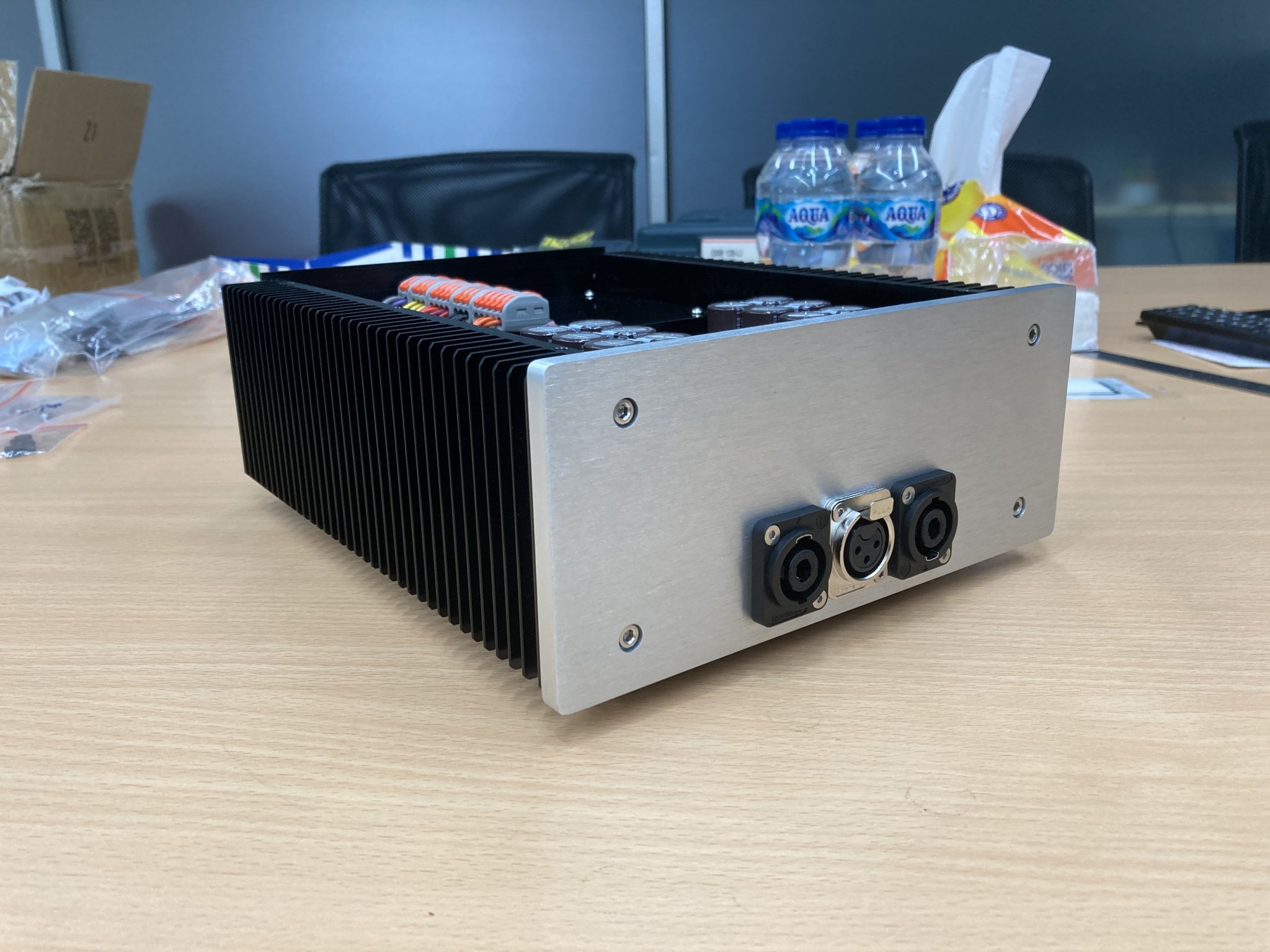

Understand Tom, I had read and learn about that from Your website before make this little amp and the component selection in my build had transition band around 58KHz and 25MHz, now the only problem is sourcing LM3886, really hard to find both TF and T
Finally got the chip, tested and assembled into case, the result (sound wise) is far beyond my expectation........ I should Thanks to this forum and forum members, especially @tomchr for all the information about LM3886, I learn a lot when build this little amp
