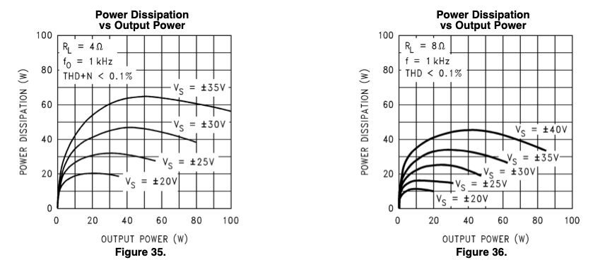

40 VCT will result in ~±27 V rectified. At that voltage the LM3886 will dissipate about 3 W at idle. That alone will get the heat sinks to 42 ºC assuming 25 ºC ambient and that the heat sinks are Boyd 6400BG. The thermal resistance of the heat sink is 5.7 K/W.

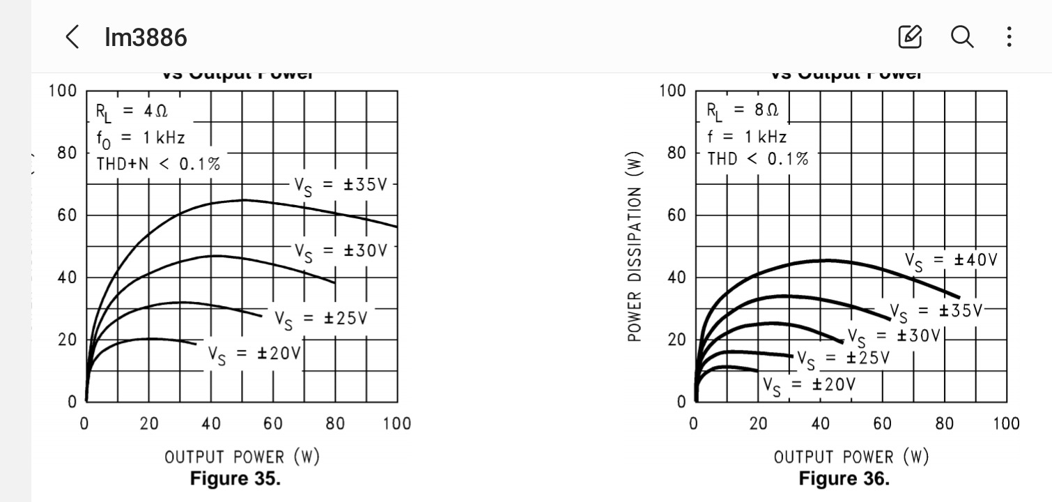

The amp will overheat if it delivers more than about 5 W into 8 Ω. See figs 35-36 in the LM3886 data sheet:
As you can see, about 20 W will be dissipated in the LM3886 at that supply voltage even at that low output power. That'll result in a heat sink temperature of 139 ºC and a chip temperature well about 150 ºC.
If you never push the LM3886 out of class A operation, you'll be fine. But personally I would add a little Noctua fan.

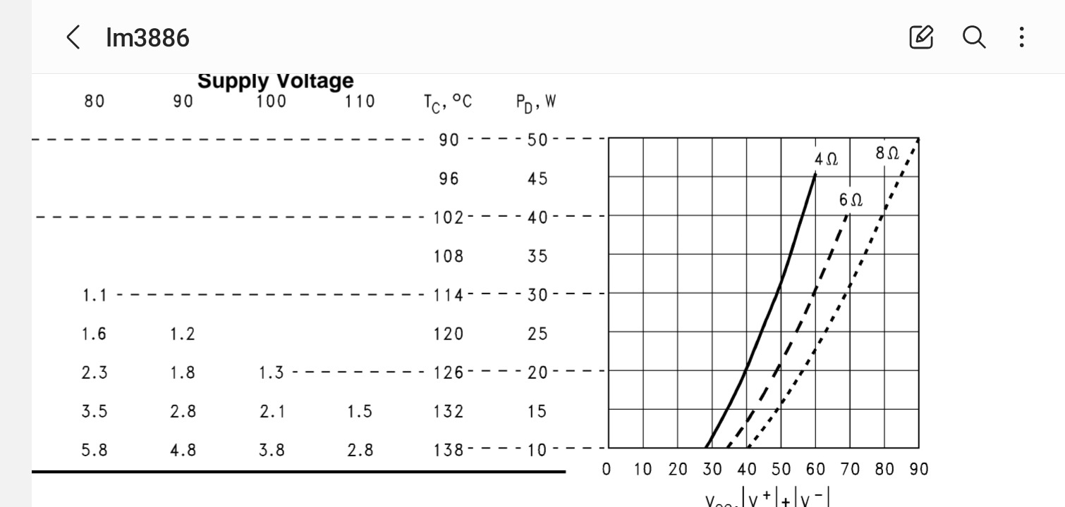

The DS gives the maximum operating Tc, case temperature, on the graph bellow.
Foe example. You have +/-35V supply and 8ohms load. The graph shows the maximum dissipation is 30W and maximum operating case temperature is 114°C. If you apply an isolator and grease, it will ask 1°C/W difference which makes the temperature of the heatsink to be max 114-30=84°C.
The graph bellow says with +/-35v, the maximum dissipation occurs at 30W output and will disspate about 34W, this why better limit the heatsink temperature to 70°C.

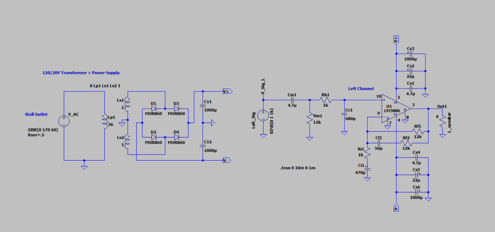

So, I redid the power supply schematic using many of the forum suggestions. I believe this 4 diode rectifier should work the way I intend it to but, whenever I try to run the transient simulation with the command text included in the image, I get an error saying my time step is too small. Does anyone know why this would be the case?
The power supply simulation works find if not connected to my amplifier circuit, but as soon as I connect them the simulation takes way too long and I get an error before even reaching a couple of ms.

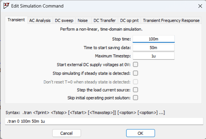

The transformer ratio 36:1 for 110v ac is wrong. Maybe 6:1 if it is 2x18v. You need to add primary and secondary resistance to get correct charge current.
In LTSPICE, let 50ms before starting data acquisition, put 1us max step, maybe it runs.

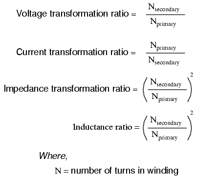

@HAYK The ratio you see on the drawing is in Henries not turns.
Is this what you mean for the simulation command window? It didn't work, i have been told to start my transient reading later than 0 and have noticed that LTSpice is still very slow to start up and get to the initial reading point.
Also, what resistance value should I add to the primary and secondary sides?

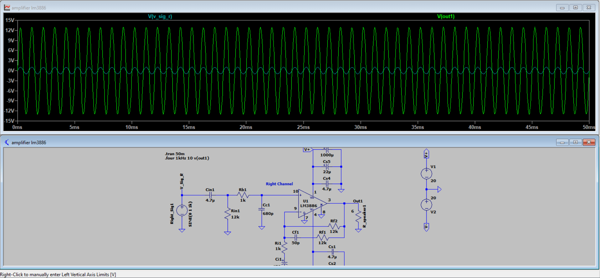

Once again, as I pointed out before, you have the "mute" pin(8) pulled low with a ground connection...I'm not sure if the Spice model of the LM3886 works exactly the same as the real one, but if it does, pin(8) must be pulled high through a current limiting resistor or it will remain in "mute" mode, and the amp will not work.

You need to measure by ohmmeter the resistances of primary and secondaries. They will tell how much the rail voltages will sag under load.

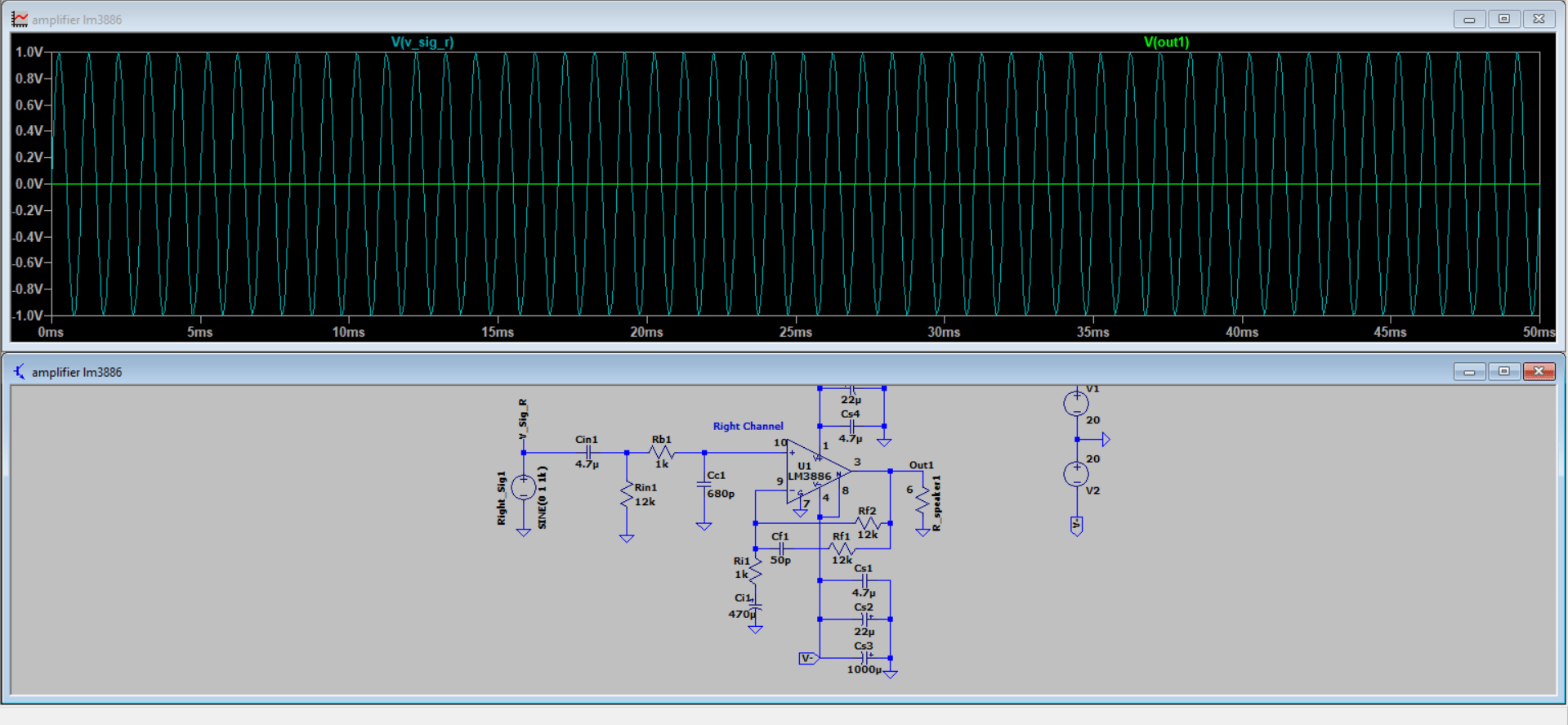

The spice model I'm using definitely isn't perfect. These are the results for the amplifier circuit with some basic voltage sources.
And this is what I get when the mute pin is connected to my negative rail (with 40uA flowing out of the mute pin). If I leave the mute pin disconnected the circuit also amplifies. So I guess whoever made this model must've misread the datasheet.

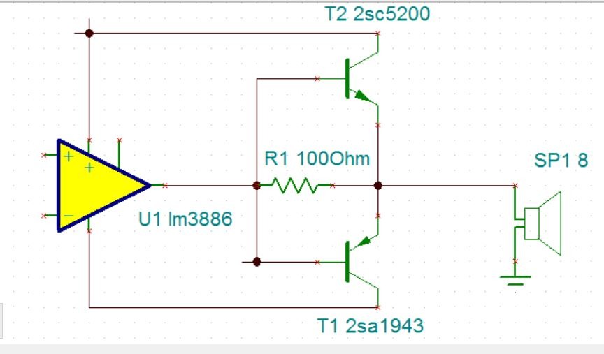

The current of the rails are not implemented in the model. You need to add a pair of output transistors 5200, 1943 with bases linked to output and 100 ohm resistor between basses and linked emitters.
Your 2x18v ac will sag to about 21v which is suitable for 4 ohms load to output 40w.
