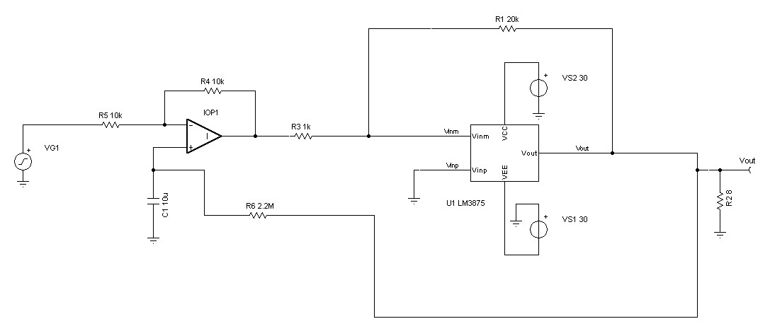

If you are happy to add an op-amp, this technique (see attached pic) is a good way of getting the low distortion of the inverting mode, together with a low output offset.
The extra components to ensure stability under all operating conditionns aren't shown. The schematic was simply a means of checking the SPICE model of the LM3875 that TI have recently released.
Hi Marc,
I share your observations, the datasheet circuit to me always looked like a bad prototype layout fixed up to "make it work", somehow. In a spice analysis, using an AC model derived from curve fitting of open-loop gain and phase as given, it's close on the edge of oscillation like the real thing.
For most any chipamp in non-inverting mode, I prefer to stabilize HF gain with parallel capacitors to the main feedback resistors, like 20k//470pF and 1k//1n for a gain of 20x (26dB).
Input and output must be filtered against HF ingress and the 2nd input roll-off capacitor must terminate exactly to the GND point of the 1n cap.
For stabilizing offset I see no other way than matching input pin impedances and/or injecting a quiet offset nulling current somewhere... and hope that drifts and aging don't spoil the party...
