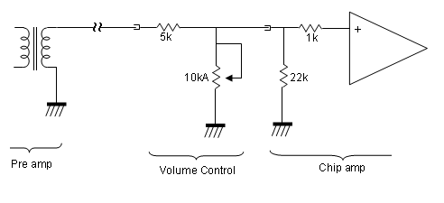

Output offset voltage is affected by the imbalanced input voltages (between + and -). And the input offset voltage is set by input offset current of the 2 inputs on the impedance they see. So the impedance changes, voltage changes. This is by the datasheet, or what I've read. Correct me if something wrong.
Now my + input is gounded (by the upstream trafo's winding), so the volume pot can't change that low impedance, thus no change to the input offset.
I don't know how you have wired up your volume adjustment pot.
If it is done as usual, it presents a variable resistance to the receiver.
This variable resistance will develop a variable voltage and that in turn affects output offset.
The transformer before the pot does not affect what the pot presents to the amp.
Here
Let's assume the DCR = 10r0. The resistance seen by +IN is
1k0 + [ 22k // 10kApot // {5k + dcr} ]
If 10kpot is set to 10k then +IN sees ~3898r (maximum volume = -4.75dB)
If 10kpot is set to 0k001 then +IN sees 1001r (minimum volume = -74dB)
I would suggest that -IN should see ~2k5, to minimise the maximum input offset resistance to <1k5
