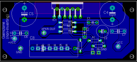

My PCB
Here is my non-inv LM3875 PCB, which I've yet to freeze on. Compared to Roadkill's PCB, this one is larger: it's about 3.5" by 1.5". The red rectangle around the chip is an area marked in the "tKeepout" layer of Eagle for the chip. I use that area to keep other components out of that restricted area, because I want to use a clamping bar on the chip to hold it to the heatsink, and put two bolts on two sides for the bar. Also, my PCB contains the smoothing caps (1000uF to 2200uF per rail); I don't have any off-board smoothing caps. The rectified power supply will come straight from a bridge (yes, I intend using a plain vanilla bridge of 25-35A for a set of amps) to the board.
I intend to use L-clamps to attach the PCB to the heatsink, like I've done here. In that case, only the two mounting holes at the rear edge (i.e. top of picture) will be used, the other two are there "just in case."
I have provided space for a large input cap, with lots of alternate pads to accommodate various sizes. Now, with the inputs that theChris has given, I may be able to eliminate the input cap altogether. That'll save me some money... I was planning on a good MKT cap there.
I've also put the smoothing caps to the sides of the chip, not in front, to allow me to use a screwdriver easily to tighten the bolts of the clamping bar holding the chip down. I intend to use non-isolated "T" type chips, incidentally, with mica sheets and heatsink grease.
Comments please? And the Eagle files are available in case any of you want them.

Re: My PCB

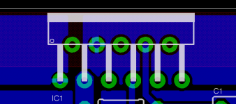

I would put the LM3875 closer to the edge of the board. I placed mine .1" from the back of the board, which seems to work good for mounting the board directly to the heatsink.

Life on the edge
However, there seems to be some confusion somewhere... I've certainly put my chip closer than 100mil from the edge of the board. If you want, I can send you the .BRD file and you can take a look. From the picture, does it appear that my chip is far from the edge? Here's another picture, much magnified. See if this makes things clearer? As a data point for comparison, the centre-to-centre distances between two adjacent front-row pins, or two adjacent back-row pins for that matter, is 0.134". Visually, it seems that my chip is way closer than 0.1" from the rear edge, isn't it?
One more reason to keep the chip where it is, and not shift it any further back, was to keep the supply rail tracks at their current widths. I don't know how much I need to worry about that if I move the chip back by a few mil, but I thought this was a nice compromise.
And since I'm not using the "TF" type chip, I'll get a few mils from the mica sheet and heatsink grease.
I too had the fear that the chip shouldn't be any further forward than I could avoid, even jutting out a bit if needed, but of course, my beloved Eagle DRC would begin hollering if I did that. 🙂BrianGT said:I would put the LM3875 closer to the edge of the board. I placed mine .1" from the back of the board, which seems to work good for mounting the board directly to the heatsink.

Re: Life on the edge
I was referring to putting the top row of the pins on the LM3875 header 100mil from the edge of the board. The rows are 200 mil apart, which is enough to put the V- trace between them.
If you get DRC errors, just modify the silkscreen part of the chip.

Re: Re: Life on the edge
But regarding the space between the rows of pins, I seem to see a lot of the space getting eaten up by the pads. Will the gap still be enough? Can you post a magnified image of just this portion of your PCB layout, like I did? Also, there's a track going from front to back to pin 8. Since mine is a single-layer PCB, I'll have to put a jumper there. I'll find it difficult to put my feedback path components on the underside, since I have four components in the feedback path (okay, I can reduce it to three) to your one.

Actually, if I had to choose between moving the chip closer to the edge and switching to a double-sided PCB, versus keeping the board and FB resistors as they are but retaining a single-sided PCB, I think I'll choose the latter, just to keep costs low. Please try to accept my different perspective. 🙂 I am not as advanced an audio system builder as you (and many others) are, and I'm not at all sure I'll be able to hear the sonic improvement that comes out of shortening the FB path by a few millimetres. On the other hand, I want to retain the other FB components as I've shown them, i.e. the cap and extra resistor, because others on the forum have reported instability with this amp at 300KHz and above, and I don't want to suffer that if possible.BrianGT said:If you are curious, I decided to solder the NFB resistor directly to the IC pins instead of putting it on the pcb. This cleans up the board a bit, and provides the shortest possible feedback path, which is very important to the design.
Perhaps the only reason why I didn't opt for your excellent group-buy opportunity was because I could see that your design was geared for very high-end (and expensive) passive components, whose benefits would be lost on me. I'm trying to design this PCB to let me sample the Gainclone's sound as a first attempt with off the shelf MFR and caps.
But I'll see if I can move the chip further back anyway.

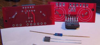

I could have easily made my board single sided, but it is the same cost here in the states to get the board done double sided as single sided, as most all of the board manufacturing places use a double sided process more often.
My pcb also works with cheaper components. I am looking to offer a more budget orientated kit, in April, with cheaper resistors, knocking $20 or so off the price of a kit.
Your layout looks good so far, and it certainly is fun making your own pcb layout if you are able to do so. I hope your boards work out well for you. You could even start your own group order there in India for all your friends 🙂

to TCPIP:
the locations of c6 and c7 vs c5 and c4 are switched. the smaller caps should be located closest to the ICs, ideally next to the power pins, but next to the IC is fine.

Thanks. Will do. Seems like it will be easy to do this change.theChris said:the locations of c6 and c7 vs c5 and c4 are switched. the smaller caps should be located closest to the ICs, ideally next to the power pins, but next to the IC is fine.

Nice layout, here are some points:
- Either manually insert some space between the polygons for the ground plane and power planes, or use Eagle's "Net Classes" command to assign a clearance of more than 15 mils. The planes, if they're so close, will cause problems due to solder bridging, etc.
- How are you going to connect the speaker wire? If you just solder it to a pad, the joint will eventually either break or cause the pad to lift off the board, since the wire used will be heavy gauge.
- The pad dimensions you have used are more suited to a PTH board. If you use similar pads for a single sided board, the adhesion will be very poor, and the pads will tend to lift off easily. Usually, octagonal, elongated pads are used for single-sided boards.
- I'd advise you to use large filter caps close to the bridge rectifier. It may sound like paranoia, but the charging/discharging current into the filter caps will cause EMI, esp. for bridge rectifiers without snubber caps. Keep the smaller caps (220u or 470u) on the board, for local decoupling.
- Disable thermals for the various planes being used. They will limit the current flow very badly.
