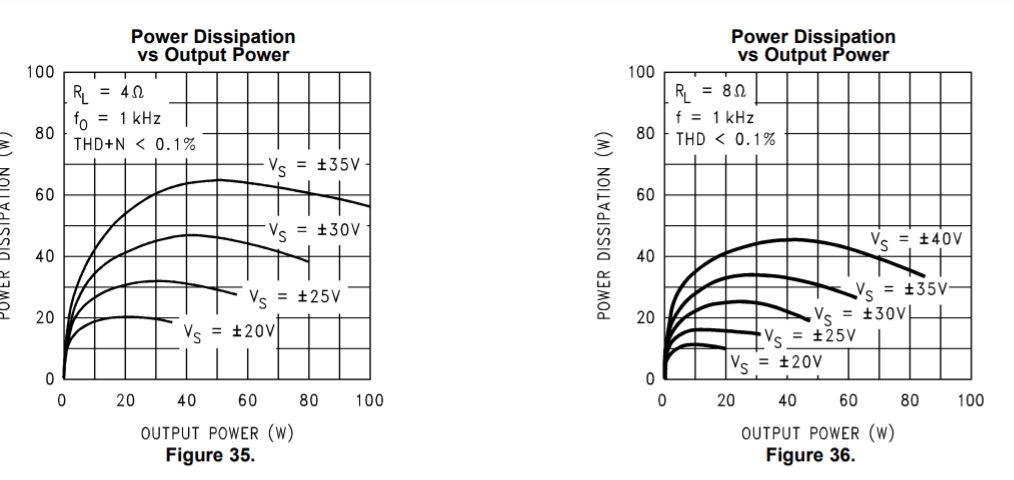

If the load is 8 ohms you can see that with +/-25v you get near constant dissipation. The idea of Gaincard amplifier is to use higher but sagging supply due to low reservoir capacitors 2200uf so that at low power the disdipation equalizes to that of above 5w.
Normal chip amps have the output transistors heat up from 25°C to max. 150°C that is 125°C max increment, the LM3886 have unique in the history of semiconductors to use 250°C operating with protection, that is increment of 225°C instead of 125°C ordinary. This is not for decoration, the datasheet clearly gives heatsink size that makes the amp to function at 120°C junction temperature. This why the Gaincard amp uses tiny enclosure the size of CD casing for 2×25W and runs at untouchable temperature.

Because the LM3886 can survive high temperatures doesn't mean it is optimized to work at those temperatures. Datasheet specs are given for 25°C. The SPIKE app note makes clear that running the amp hot degrades its operation.
Furthermore, domestic amps operate usually most of the time in the vertical section of that dissipation vs output power curve. So good luck with constant dissipation.

Many intended-for-beginners LM3886 project designs, recommend using a 200VA power transformer with (2 x 22VACrms) secondaries. This gives about ±28 volts DC on the supply rails, IF your transformer is in spec and IF your AC mains is in spec. You can estimate the output power delivered to the loudspeakers, when the supply rails are ±28 volts DC, by studying Figure 37 of the LM3886 datasheet. You can also estimate the maximum heat dissipated by the LM3886 chip (and pulled away by an enormous heatsink conservatively chosen by YOU), when the supply rails are ±28 volts DC, by studying Figures 35 and 36 of the LM3886 datasheet.

Also note, that if you have the isolated chip, its thermal resistance is a whopping 2K/W. At a theoretical Pdmax=40W that equates to +80K which is not only piping hot and hard to cool but a very unreliable application.
I´d guess many naive DIYers are driving those chips much too hard.
Thermal shutdown is at 150°C by the way! (page 4 of said app note)

With 8Ohm +-35V is absolutely fine. With 4Ohm I wouldn´t go over the recommended Pd=40W and thus almost +-28V; although I do believe you that the 30V might have worked for you. Probably not with a rock-steady and non-sagging rails I´d guess. (see graphs in #4)

±40 V might be okay with an 8 Ω load, but ±30 is about the optimal with a 4 Ω load. At higher supply voltages the SPiKe SOA protection will engage earlier, which means that you get less output power into 4 Ω at voltages above ±30 V than you do at ±30 V.

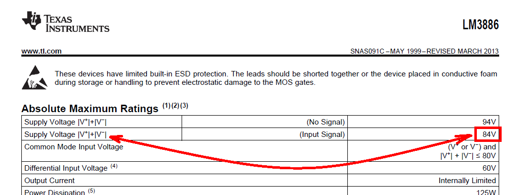

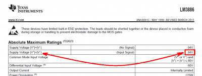

the data sheet tell +-84DV, so 42/1.4=+-30AC is the max AV,I use+-22AV*1.4=+-30.8DV,can provide 45W a channel.
It´s not a DV (design value") but an absolute maximum value.
Since it can´t be surpassed, and give parts tolerance, mains voltage variations,etc. ,safe design means you must keep *at least* a 10% safety margin.
And in any case, Datasheet clearly suggests +/-28V rails for 4 ohm and 8 ohm loads and +/-35V for 8 ohm and higher, NOT recommended for 4 ohm ones.
To boot, besides "standing" the supply voltage, chip must also dissipate associated thermal power, so stretching values up does not provide real advantage.
