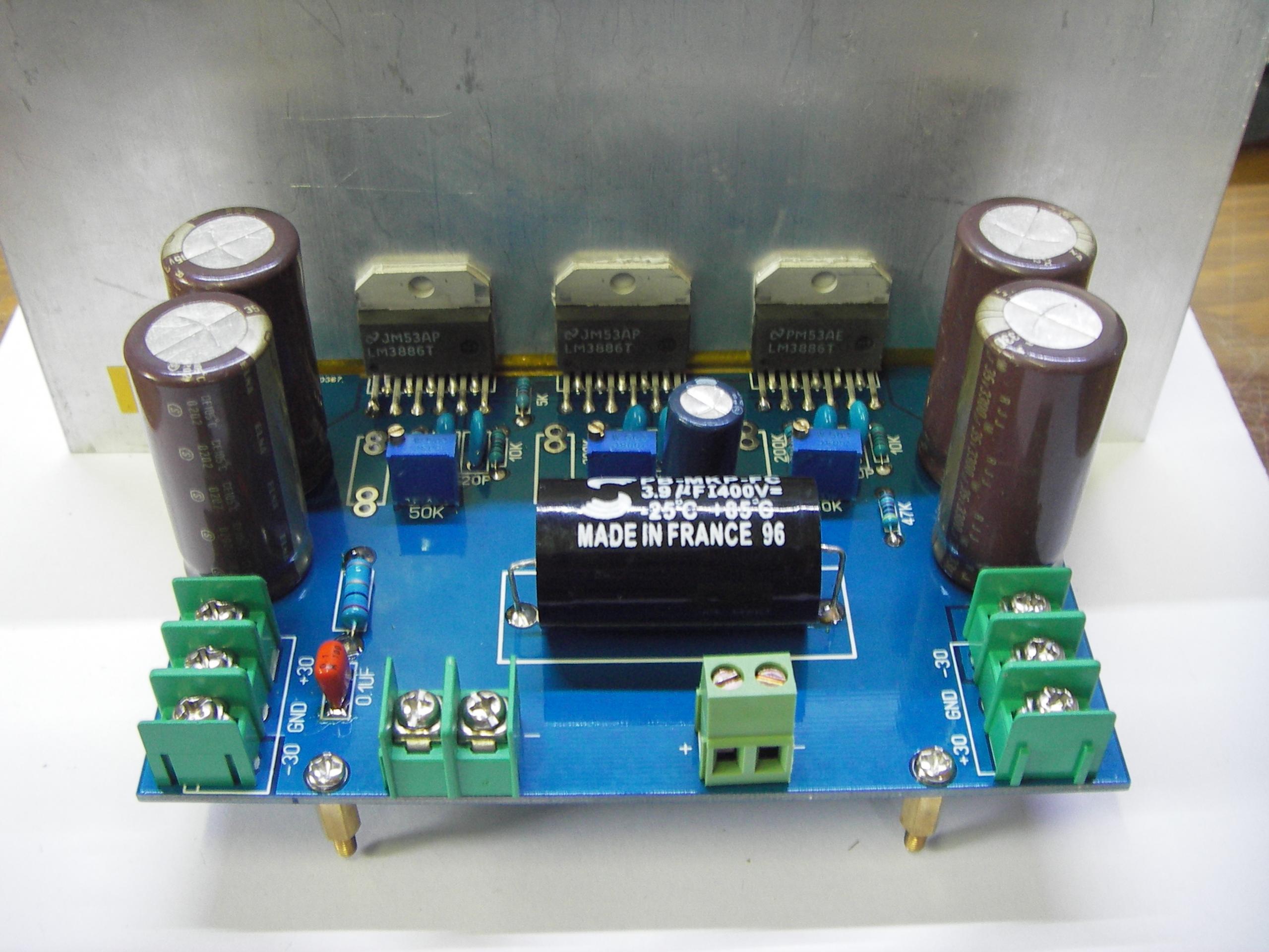

Measured data
Some data are available from the test board. We can see below the THD vs power for single, two and three 3886s. The rails is +/- 25 V, no load.
From left to right: 1k, 4Ohm; 1k, 8Ohm; 20k 4Ohm; 20k, 8Ohm. We can see the clipping level is higher for parallel in particular from one to two 3886s and 8 Ohms load. We get lower THD by using an additional 3886. Will the fourth lead to better performance? We will know after I stacked the boards.

Paralleling more than three 3886 may not be necessary aimed for higher current demand. If this brings improvement, we may get better sound even the speaker impedance dip is about 4 Ohms. Using 3886 or other single-chip chipamp has the advantage of eliminating protection circuit design. I never doubt LME498xx with discrete output is much better. We just need to take care the protection.
Left is THD vs output power for 20 kHz, 4 Ohms load. 80kHz filter was employed. We almost get 0.01 % before clipping.
Right is THD vs freq for 44 W into 4 Ohms load. 80 kHz filter was employed.

When one of the four 3886 gain is set different from the other three (18.8 vs 19.4), distortion is higher due to this discrepancy. 1% resistors with multi-turn trim pot are employed in the test board for gain setting. The figure below shows the THD vs power for board with and without gain error among the chips.

Anyone seen more than three 3886 in parallel? Make sense?

Thank you for your suggestion. I was thinking to include TDA7294. TDA7293 is definitely a better choice for parallel. I will test it after 3886.
I would love for you (Panson_HK) to whip up a board using 3 or 4 of these in parallel, or something that the user could build as 2,3, or 4 in parallel by adding components as needed. I have a design for a dual board with some tips on selection of components to keep the TDA7293 doing what they should, which can be tricky. PM me if you want the details.
Yes, this is being considered. I will either make a board for, say, 4 x parallel or a 2 x parallel board easing for 4 x, 6 x ... parallel.
