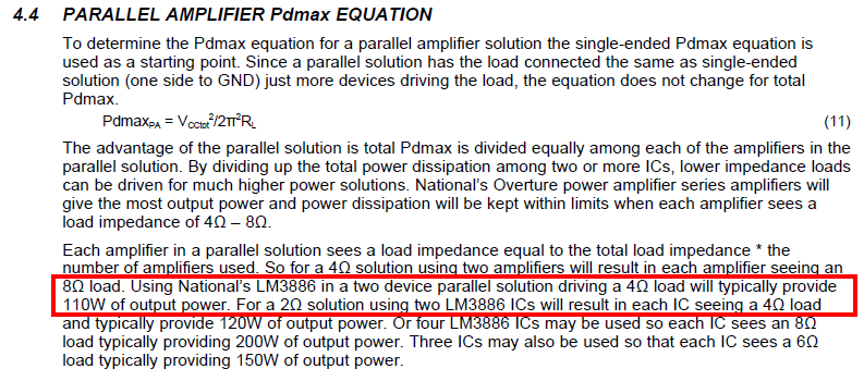

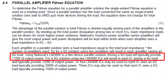

Hi that's why many people confuses (including me) regarding output power.
Datasheet shows this in page 6.
LM3886 in a two-device parallel solution driving a 4Ω load will typically provide 110W of output power.
Even ebay sells parallel amps using LM3886 mentioning 120W per channel into 4 ohms load.

Pdmax on page 6 = dissipation.
Pmax,rms = Vpeak^2/(2*R)
With 35v rails and a 4 ohm load, that's 153 watts. Given losses, rail sag, etc, they're saying 110w. With 28v rails and a 4 ohm load, you're getting 98 watts--with losses that's your 68W.
Chips in parallel simply mean you can drive the current and manage the heat.
What they are describing is 2x68 Watt with a 2 ohm load, not a 4 ohm load.
If you half the impedance then you can theoretically double the power, it also means doubling the current output capabilities of the amp and PSU.
If you wanted 4 times the power of a single LM3886 into 4 ohm, you would need a 1 ohm load and 4 lm3886 and a PSU that can supply 4 times the amount of current.

With two chips in PARALLEL you'll get the same output voltage as with a single chip if operating on the same power supply, hence, the output power will be the same: 38 W, 68 W in 8 Ω, 4 Ω, respectively for ±28 V supply.
However, two chips in parallel support more current, hence, can drive a lower impedance. An amplifier with two LM3886es in parallel will be able to drive a 4 Ω load to ±35 V rails. This allows you to build an amp that can drive a 4 Ω load and operate on a ±35 V supply. In this case, you'll get about 60 W into 8 Ω*and 120 W into 4 Ω.

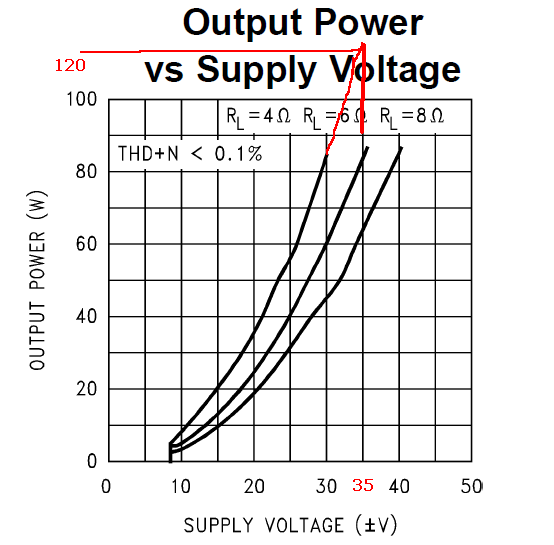

Hi thanks for the details.
Now I got it, the whole idea based on the graph on page 12 in LM3886 datasheet.
National has stopped the curve in 4ohms load upto 85Watts on 30V supply.So it is clear the chip can go more than that.The graph will move about 120W when feeding 35V on 4 ohms.
So better to parallel them and feed a 35V supply to share the current.So I can go even for 2 ohms sub as well in future.

The power dissipation at 100 Watt output power with a 2 Ohm load and a 35 Volt supply is about 130 Watt, each chip dissipating about 65 Watt. That is not output power but the power that is heating up the chip.
Also the PSU will need to hold that 35V at full current demand.
