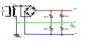

i've followed this schematic for power supply.... i use one power supply for 2 LM3886... is it correct?
That power supply is a little bit weird but should work, except that with 19 VAC RMS from the transformer, you would probably only be getting a little over +/- 26 VDC for your power rails.
By the way, those 100nF caps could be the subject of a debate. If they are high quality (low ESR, such as film or C0G/NPO ceramic) then they could cause high-frequency ringing.
