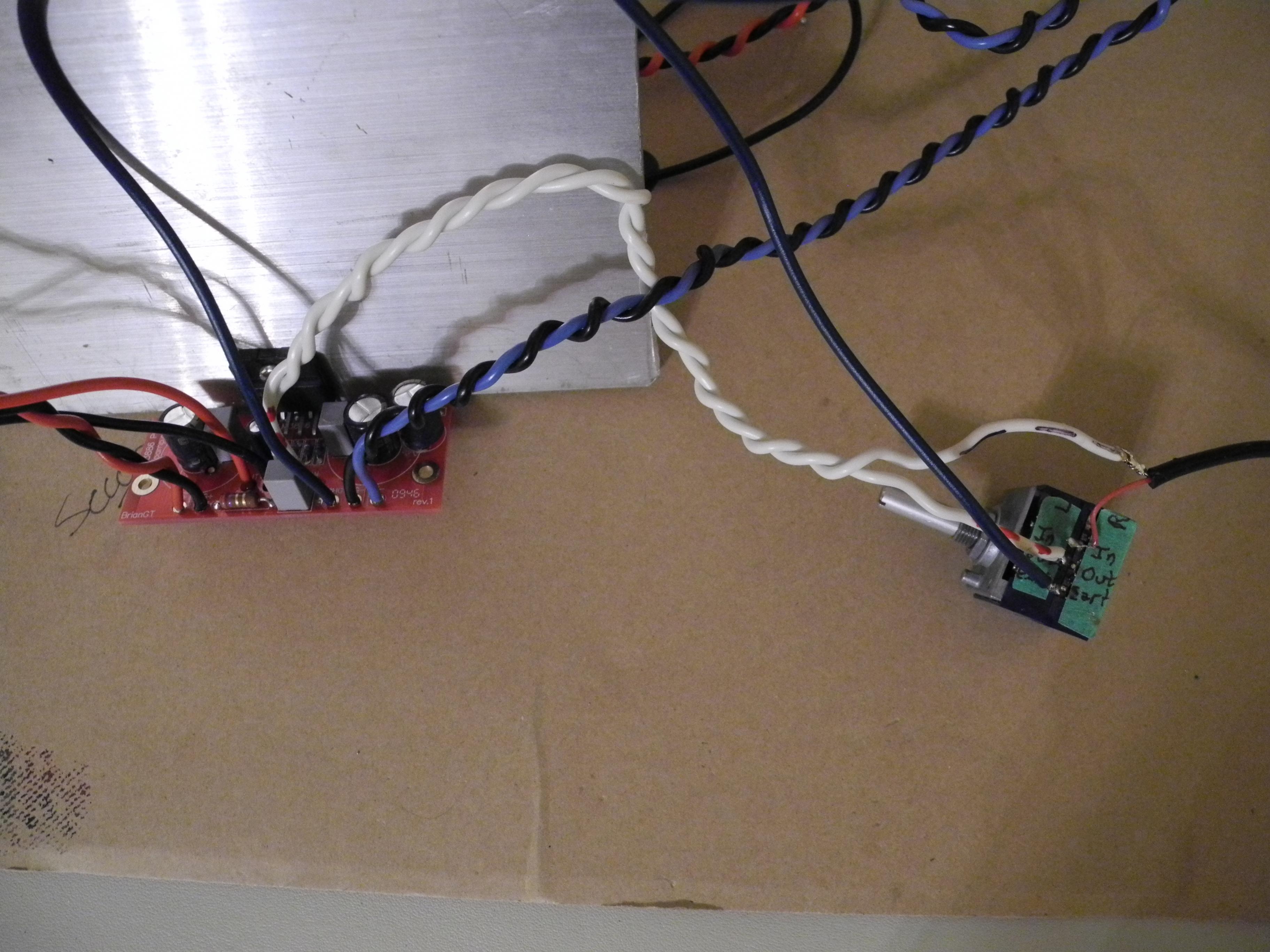

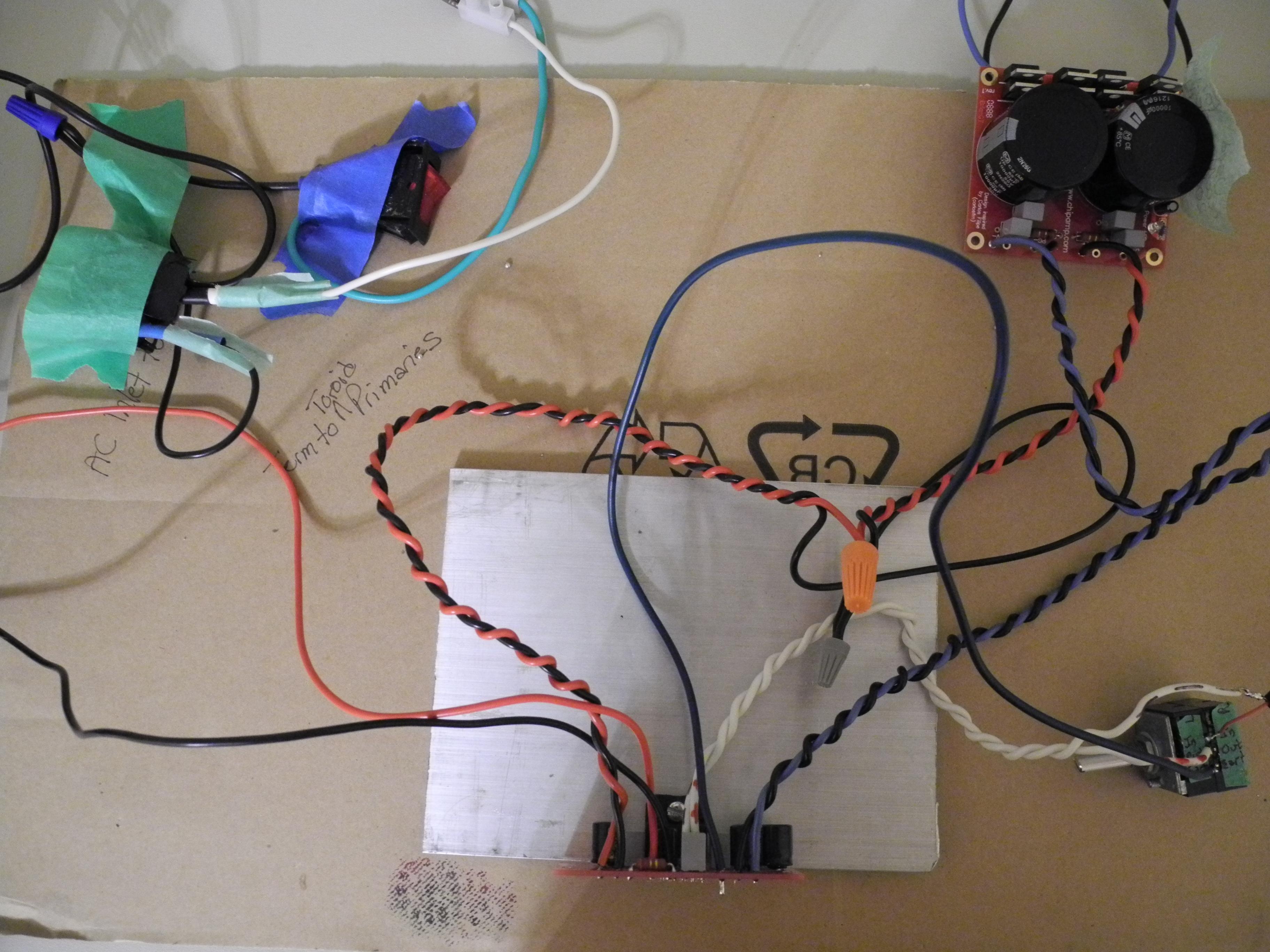

Damn! Something else must've got screwed up. Since I attached the POT, no music plays, but I do hear a faint buzz if I turn up the POT.
Here are a couple of photos, albeit dark, showing what I've done. Any idea what is wrong?
What terminal on the amp is the dark blue wire going to? The screen from the source should be going to "earth" on the pot together with the white wire it's connected to.
Ah, blue wire is going to "chassis ground" on board, disconnect that.

Thanks for sticking with me on this. Actually, I forgot to mention-the wire you mention is actually green, but the colour is off -it's a dark green. To make things worse, I took that photo at night and the camera made it look even more like blue. I soldered the green wire from chassis ground on the amp to ground on the POT (but not to any actual ground or earth). That okay?
