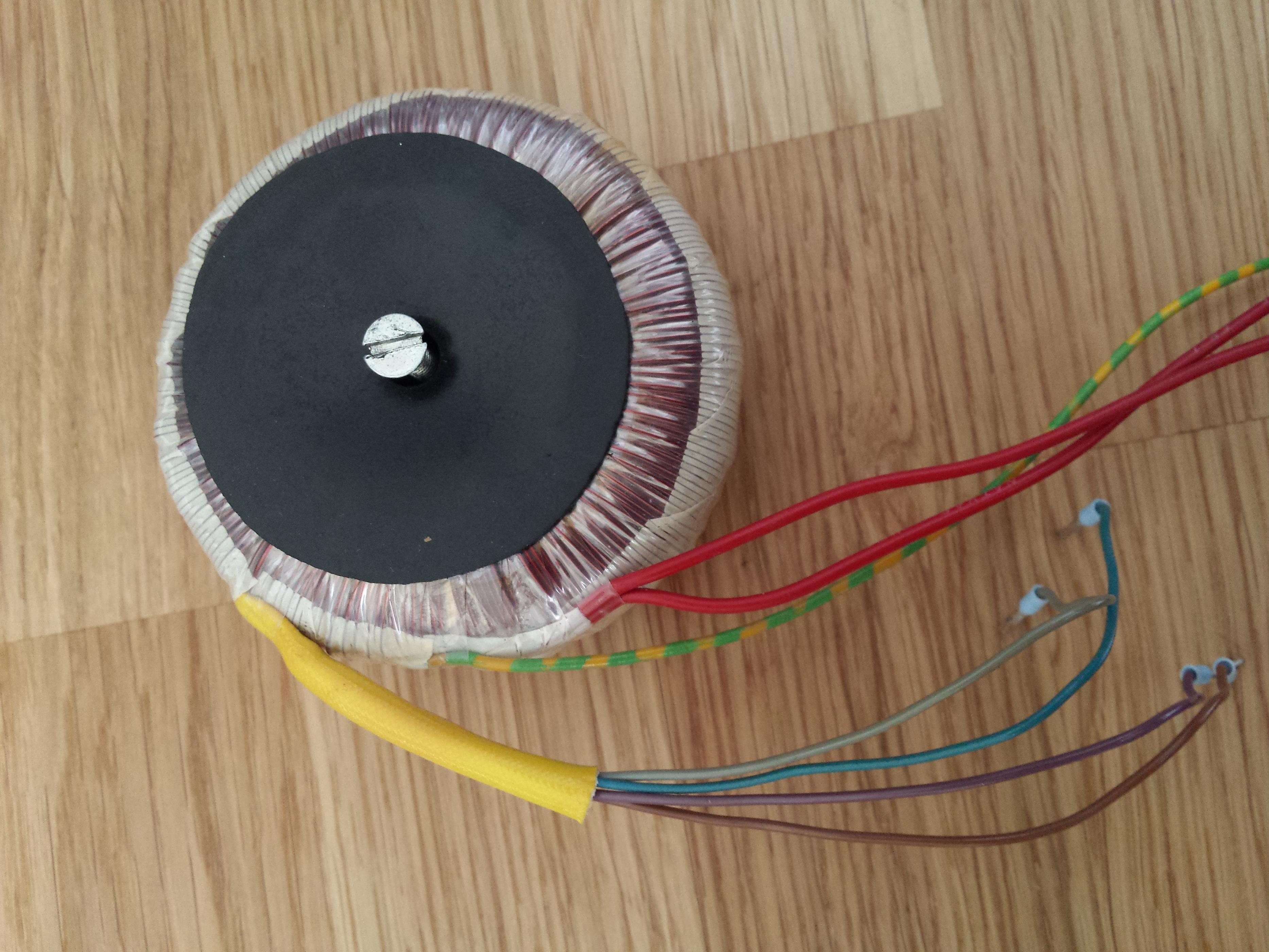

The wires are a clue.
The two reds are probably the mains primary.
The green/yellow may be a screen.
The four wires Blue, Brown, Violet & ? might be a dual secondary winding.
But because these have an extra sleeve of insulation they could be a dual primary, meaning the reds are a single secondary.
More information will help.
insert each wire end into separate terminals of a 7way insulated terminal block. The screw down should break through the enamel insulation.
Set your DMM to low ohms, preferably 199.9r
Measure resistance probe to probe.
measure red to red
G/Y to all other terminals
V to Bl
V to Br
V to ?
Bl to Br
Bl to ?
Br to ?
Post results of all 14 results.

Hi Andrew,
I did the test as per your instructions..
Violet to Brown = 44ohm
Blue to Grey = 43ohm
I didnt get a stable reading on any of the other wires, the multimeter was jumping all over the place.
I can understand grn to any of the others giving hay-wire results.
That would confirm that Grn is ONLY connected to screen.
Violet to brn and Blue to grey confirm these are tappings to different windings and each winding is ~43r. This is high indicating a lot of thin wire.
Probably the primary windings of a dual primary transformer.
The fact that none of Violet, Brown, Blue nor Grey connect to any other tap is good news. It means that at very low voltage there is no short from mains to any isolated winding.
But I can't understand why red to red does not give a valid resistance.
Check that again. and make sure the enamel is broken through.
