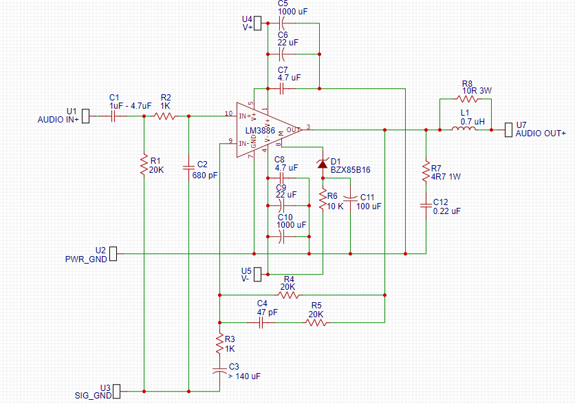

Dear All,
I´m building a 3-way speaker with mid range and tweeter path based on seperate LM3886 (XO at 240 and 3700 Hz)
Would it make sense or do any good (stability, ...) to limit the bandwidth of the amps or is this even negative and better to run them in full range?
THX for any thoughts!
Best, Josef
No need of bandwidth limiting, just use all optional component recommend by NATIONAL engineers. I mean input RF blocker, feedback compensation, Zobel & thiele network etc. For low noise set the gain around 27db.
not sure if reducing the bandwidth of LM3886 via feedback network would actually decrease stability (mininum gain for stability). it could eventually reduce the amp noise, if this is an issue.
you could consider adding a servo with increased high pass frequency. but it probably makes even more sense to add a (big) output cap for the tweeter, to protect it from eventual faulty low frequencies.

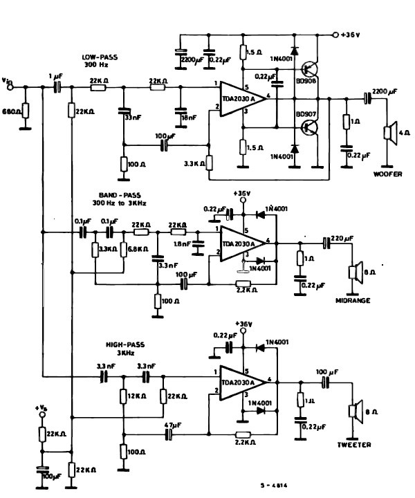

Would the LM3886 lend itself to having the e.g. LP @240Hz-2e Order built in the NFB network al la picture attached, or would that lead to stability issues with this particular chip?
Jan thanx. Pardon my ignorance, but how would that be easy to see? I not familiar with the LM3886 datasheet (and was too lazy to look that either..) , but is this because the LM is not stable below, say, less than 20dB gain?
Using a conditional stable amp like the LM3886 as part of the filter is a risky thing. If you look at the internal (summing) nodes of such a filter, signal voltages can be much higher than what you would expect from the outside, and loop gain also varies all over the place especially at the filter cut-off frequencies.
It is not readily apparent that, for instance, the minimum gain requirements of the LM3886 are respected.
If can be done but needs good insight and care.
Jan
Thanx for chiming in. Risky: that was my thought too. Related: do TINA or LT Spice indicate (a sort of red flag) stability issues?
No, but it is customary to do a sim run and check for stability. There are several methods, if you're interested there are several threads here on that. Probably the Using LTspice from beginner to advanced is the best and most complete one, but also the longest ;-)

Can we make the general assumption that, as soon as gain is no more uniform -even in the filter passband- but starts to rise "locally", the circuit is locally running out of phase margin and is thus approaching "instability territory"? It is the gain-stage before true oscillation I am referring to.
That would be a very, very general assumption. Especially with feedback with frequency-dependent components, you can easily have the opposite.
And what gain are you talking about? The closed loop gain? In that case it isn't true - look at the LM3886 itself: increasing the closed loop gain around it from the minimum to a higher value improves stability.
This is an area that is very hard to grok without at least some formal training.
