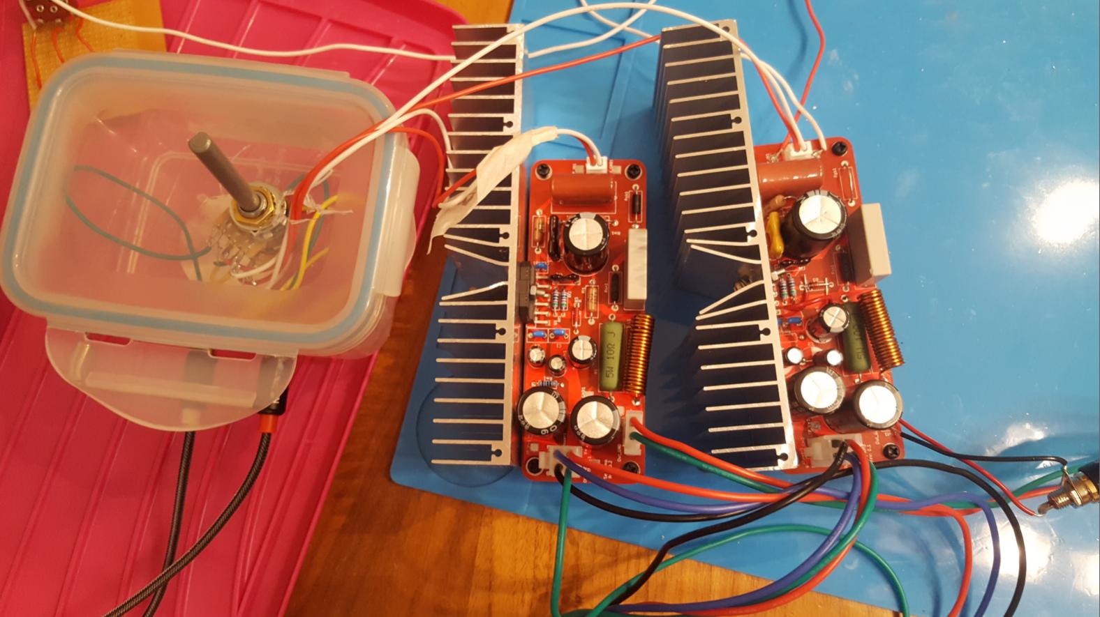

I replaced the 10k mute resistor with 30k and shorted out the Zener for the mute.
This seems to eliminate pretty much all the power on / power off DC voltage spikes.
I'm not really sure why though. On power-off, I could understand that the mute cap would still hold charge and thus conduct through the zener, but I dont quite understand on turn-on after cap is discharged.
I can see two possibilities:
- The mute pin is effectively floating on startup as the zener does not conduct. The LM3886 might not appreciate that.
- The zener current is pretty low, which means that you don't get the full zener voltage developed across the zener diode.
If option 2, try a low-current zener. You can get zener diodes that'll work at 50-100 nA (and some down to 5 nA too).
I've never quite understood why people add the zener diode. I mean, I understand what they're trying to do, but it's utterly unnecessary. Just use an RC and be done. Design for ~1 mA mute current at the nominal rail voltage.
If you absolutely want to keep the LM3886 muted until the supply voltage exceeds ±10 V, I think a better option would be to have a transistor pulling the mute pin to ground until the supply voltage exceeds ±10 V. Ideally you would design the circuit such that the LM3886 is held in mute if the positive supply is missing. I do that in the Modulus-286 and Modulus-686 as parallel LM3886es can show some undesirable behaviour if the IC is un-muted without the V+ supply.

Thanks for that explanation Tom.
I've been doing testing with the zener shorted and seems fine.
I dont really recall much of a pop now on turn-off / turn on either. More an instant-on with no pop, and a delayed off with no pop.
The Zener is a 1N4745ATR, and the datasheet says 5uA Zener current, this being too small?
Perhaps a future revision would involve the transistor setup as you suggest. For the moment, this may be "good enough". As I get more test gear in the months to come, then it may be a good idea to revisit.

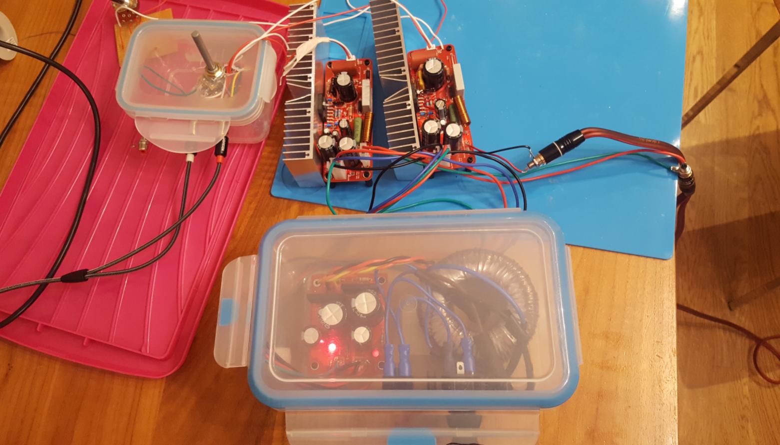

The current update is:
- I've got something that plays.
- the heatsink is lukewarm when playing for 10+ minutes on medium volume.
- I think I did kill my tweeters though - no scope to check but perhaps an earlier version caused oscillations. Cheap PC speakers, maybe they were dead a long time ago.
- when no source connected to the RCA, there's a buzz / hum that gets louder as i increase volume. I know my pot is a bit dodgy so will replace it, but I'm worried there's a ground loop issue somewhere. With volume to 0, there's no buzz. Unsure what this could be - perhaps just RF or magnetic noise being picked up by the test wires and test pot?
- plugging in audio source (PC line out) while amp is turned on causes pops and bzzzz noises, when no sounds playing. Same if I hold the jack plug on the cable that goes to the RCA - is this normal (noise picked up during mechanical plugging in) or some sort of filtering / grounding issue? (EDIT: when plugged in, and sound playing, there's no pops etc. Just the moment when plugging in)

That should be fine. If you have an oscilloscope it could be interesting to measure the zener voltage during startup. That's more of academic interest at this point, though.
Sweet! That was the goal, right?
That's normal. You're picking up mains hum and noise as the amp's input is terminated in the relatively high input impedance (Rin1 = 20 kΩ).
Then you have no ground loop - or if you do, it's not of any consequence.
Also normal. Your body acts as a great antenna for all sorts of hum, which the amp will happily amplify. This is why we don't mess with the interconnects when the amp is powered up and connected to speakers.

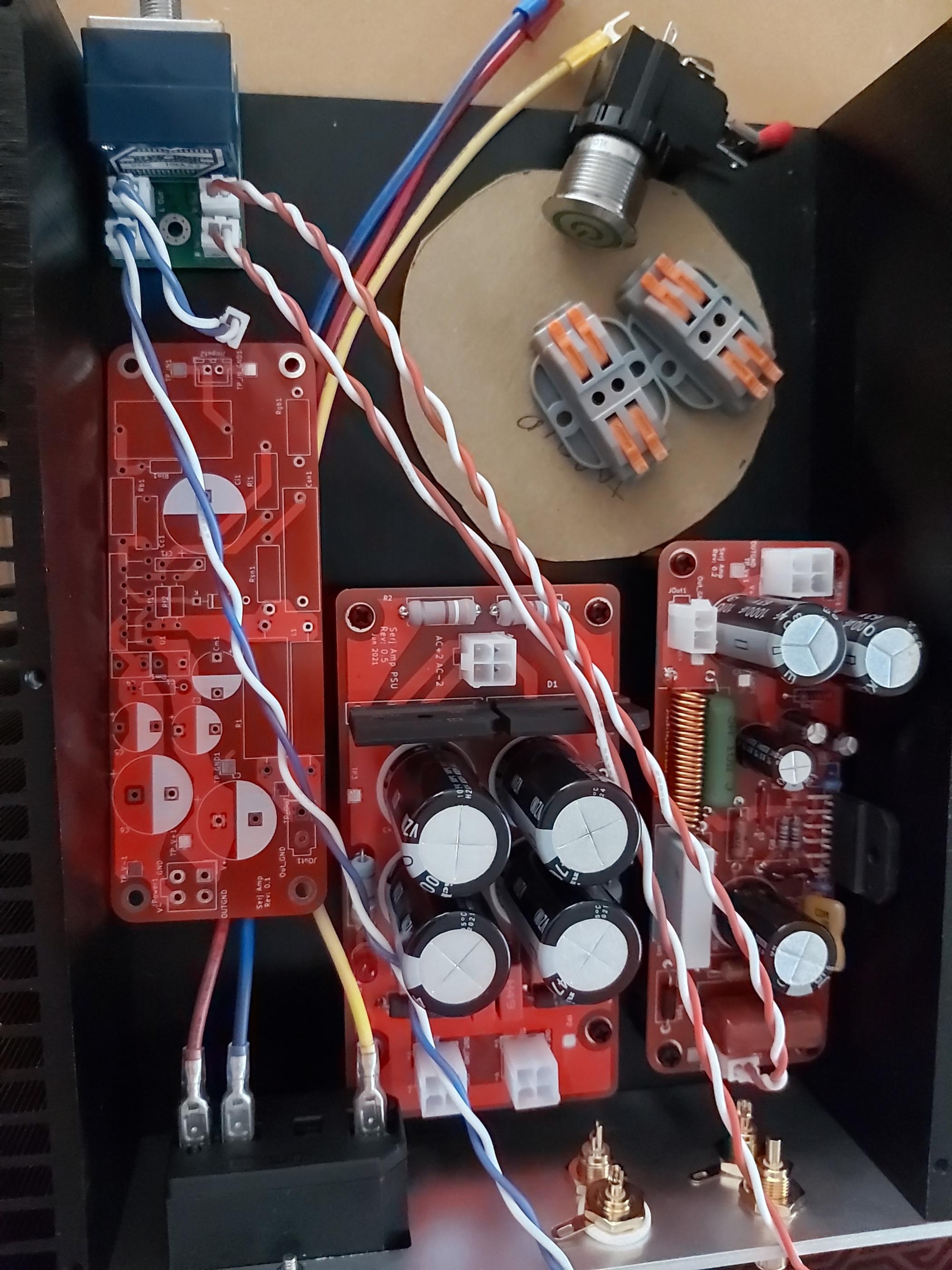

Slow progress here.
Some things done:
This project has come a long way since my first prototype last year.
Perhaps I should start a build thread?
Some things done:
- Made rear panel, but got the size wrong for the RCA connectors, so will need to get factory to make again.
- Bought a new pot (the Alps blue is smoother than the old one), and made a breakout board, because I hate soldering wires to potentiometer pins.
- Playing with the layout of the case and the boards.
- New PSU board (that I've not tested yet), largely based on carlosfm's circuit.
- And a latching mains switch with LED indicator, that I might use for the front panel.

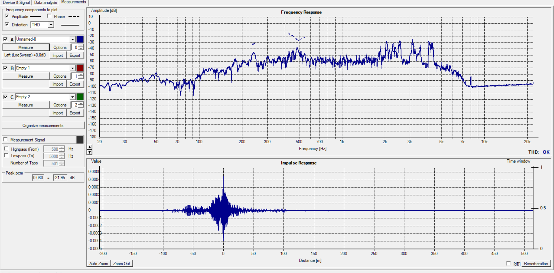

- I still need to order accurate mic so I can profile the sound output.
Nice work so far. Beware of the inrush current of the transformer. If you find that the mains switch wears out quickly you'll need to add a soft start.
I like the compact layout and that you use connectors rather than terminal blocks. It's also good to see heat shrink or boots on the mains terminals.
Tom
Tom
