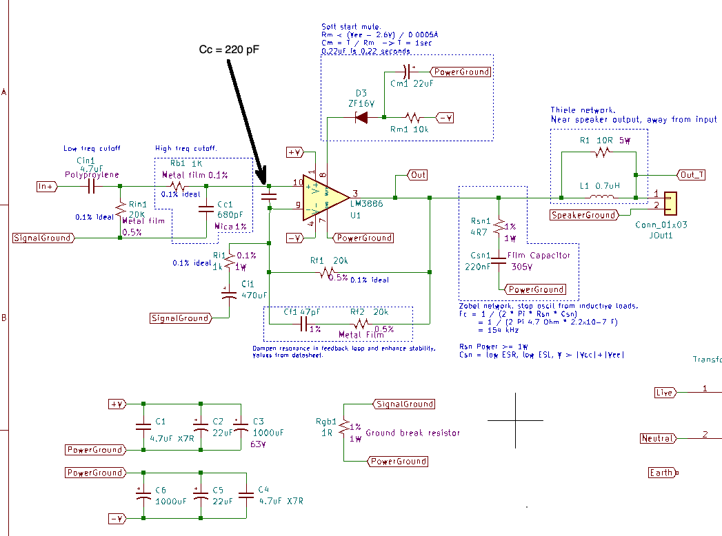

I've soldered up my LM3886 board and getting a hot chip (using a bad heatsink, if I use pliers to press it against a big heatsink then doesnt get hot).
The main issue I have is that it's apparently outputting 0v at the output with no load connected, and PC line output connected as input with no input attenuation via a volume potentiometer.
I had previously built a veroboard version (minus the zener mute function, minus the thiele and zobel networks) and that used the same bad heatsink and worked and had no heat issues.
This is a different chip - when I get time, I will swap the chips to see if I have a faulty one.
I'm using a pcb this time for the new amp, components are more compact compared to veroboard.
Rgb1 on the schematic is just a bit of hookup wire that has not been soldered - intent to use 1ohm 1w resistor. This might be causing issues, although continuity seems fine on those points, it might be introducing noise.
Anyone able to point me to the right direction please?

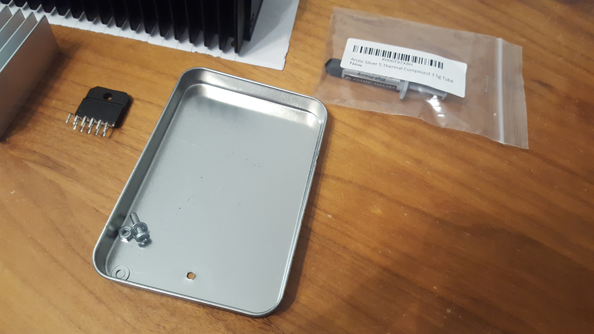

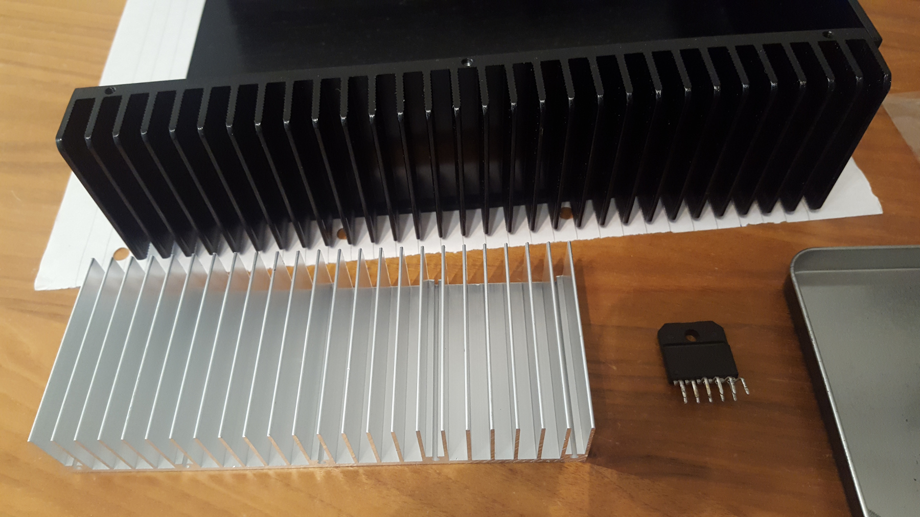

If it runs cool with pliers, you need locking pliers? Or a proper heatsink screw?
Zero Volts DC is usually the expected output with no audio signal.
Why is the ground jumper not soldered? Sounds like trouble.
I don't have any locking pliers. The good heatsink I have is part of the case enclosure I want to use, but I havn't decided yet where to position the boards, and without that decision, I wouldn't know where to drill the mounting hole for the LM3886.
It's a double sided board and I was holding off soldering it as I wasnt sure if my solder-sucker or wire wick would be good enough to remove the solder. I'll try with it soldered tonight.
Speakerground to powerground connection looks to be missing in both the schematic and board.
Speaker ground and power ground are connected directly to each other on the power supply board.
Would it be better to connect a short jumper wire under the power socket of the amp board so that power ground and speaker ground are shorted at the amp board as well?
I think the issue is that you forgot the compensation cap (Cc) on the inputs of the LM3886 (see attached schematic) and the LM3886 is now oscillating. If you probe the output with a scope, I bet you'll find a nice signal there, probably in the range of 1-10 MHz. You'll probably find that Rsn1 is heating up too.

That said, I don't think grounding is your issue here. Your schematic looks right and the PCB layout is pretty decent, so the circuit should work as long as you have all three grounds connected together.

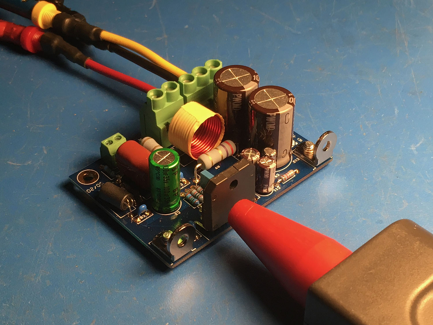

If you run the LM3886 on ±30 V without a heat sink, it'll definitely get warm. It'll probably get to 50-60 ºC case temperature. I've run it like that even with a signal applied to the amp. As long as you don't have a load connected, that should work just fine.
Once you connect a load, you will need a heat sink. I often use a 0.4 K/W heat sink (165 x 300 x 50 mm, 2 kg) for testing because I have some. For a quick test, I'll often use a Bessey spring clamp (see attached) to clamp the LM3886 to the heat sink. I can get full performance out of the LM3886 in that configuration.

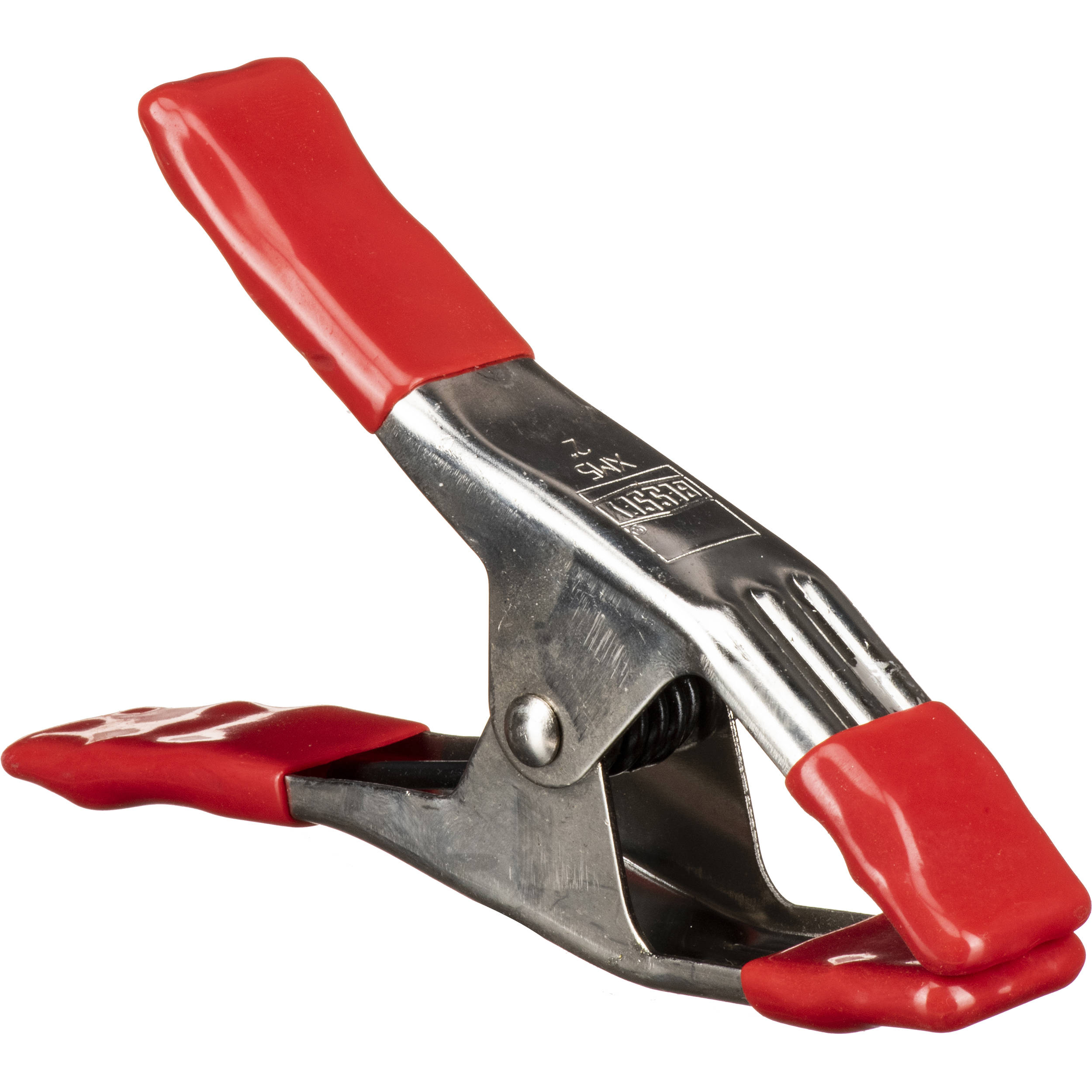

If you go with those clamps, be a bit careful as the metal of the clamp tends to eat through the protective plastic tips. That makes it easy for the metal to contact the leads of the LM3886 with potentially disastrous consequences. Ask me how I know... 😱 When I go to replace my clamps, I'll get the more expensive ones with plastic jaws.

If you place 100 nF between the inputs of the LM3886 it will oscillate for sure. You need something in the range of 150-220 pF. Those would be labelled 151, 181, and 221 (150 pF, 180 pF, 220 pF, respectively). Make sure you get one with C0G/NP0 dielectric. The other dielectrics cause too much variation in capacitance as function of voltage and temperature to be useful as a compensation cap.
If the LM3886 is oscillating you'll have 0 V DC on the output, but some AC voltage present in the low MHz or high hundreds of kHz range. A good bench top multimeter can measure that. many handheld meters don't have that much bandwidth. They may show some AC voltage. They may not.
A quick thing you can try before adding the compensation cap is to take Rf2 or Cf1 out of the circuit. If the LM3886 still gets hot to the point where you can't touch it, it's probably not a stability issue.
Double check that the 20 kΩ resistors are indeed 20 kΩ (red-black-black-red-tolerance). They appear to be, but colours can be hard to judge in a picture with artificial lighting.
I didnt have this issue on the Veroboard version, and I didn't have the compensation cap on that version either.

Looking at this: Taming the LM3886 Chip Amplifier: Stability – Neurochrome
suggests that my Ri1 and Rf1 should be really close to the LM3886, however my Ri1 is off towards the edge of the board. Is this likely to be causing my issues? I can't get anything significant out of the amp.

With the zener shorted, you should have Rmute = 33 kΩ, Cmute = 100 uF. Your current values will work OK, but expect a turn-on pop. But this is not why the LM3886 gets hot.
If you have all the grounds (SignalGround, PowerGround, and SpeakerGround) connected together and include Cc (220 pF), the circuit should work. If it doesn't you either have a bad component or accidentally installed the wrong component.

So I decided to conduct a little experiment for you. I powered my LM3886DR by a pair of HP 6643A lab supplies set to provide ±30 V. The LM3886DR had no input (so input grounded by 48 kΩ) and no load. I measured the temperature on the back side of the LM3886TF package with an infrared thermometer (the red tip you can see in the picture).
On ±30 V, the LM3886DR drew 52 mA from the supply and the back of the IC package reached 80 ºC.
On ±35 V, the LM3886DR drew 53 mA and the back of the IC package reached 95 ºC.
You might be able to glean some insight from measuring the supply current. If your ammeter can't resolve low currents, insert 10 Ω in series with each power supply lead and measure the voltage across these resistors.
Tom
On a tda7294 chip amp I used it needed that capacitor if the gain was reduced below a certain level. At low gains they can become unstable.
My amp was a valve/tda7294 and when the tda oscillated it radiated back into valve ! so I had a good RF oscillator.
The cap fixed it.
On the LM3886, the Cc = 150-220 pF cap across the inputs tame some parasitic oscillation that occur when the VAS exits saturation (i.e., near clipping). The added Cf = 47 pF and Rf2 = 20 kΩ clean up the transient response (Cc causes some peaking there).
You can run the LM3886 without Cc, Cf, and Rf2, but you get better performance when you include them. If you choose to include them, include all three components.
Tom

LM3886TF is what I have.
I've got a new aluminium heatsink to play with and some thermal paste.
I'll include the old sheet metal heatsink in the picture.
