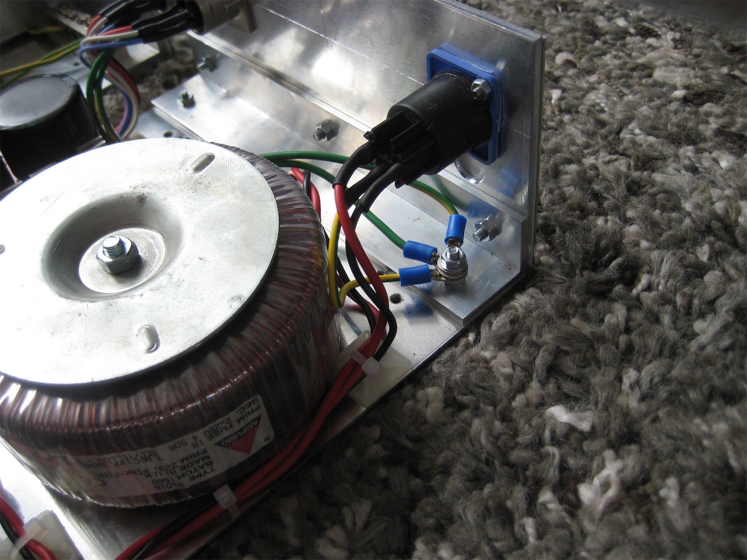

Philfr, your schematic has a wrong layout of the ground connection to chassis!
It should be:
Mains Earth -> Chassis -> Ground Loop Breaker.
That's copying the error in the ESP schematic.
ESP shows the PE wire going to the "ground loop breaker" (I call it the Disconnecting Network DN) first and then a tail going off to the Chassis.
I have told a few that ESP is showing it incorrectly.
The PE wire should go direct to Chassis. Nothing else gets in the route.
Then quite separately the DN connects the Main Audio Ground (MAG) to Chassis. This connection should be beside the MAG, not a long wire back to the PE.

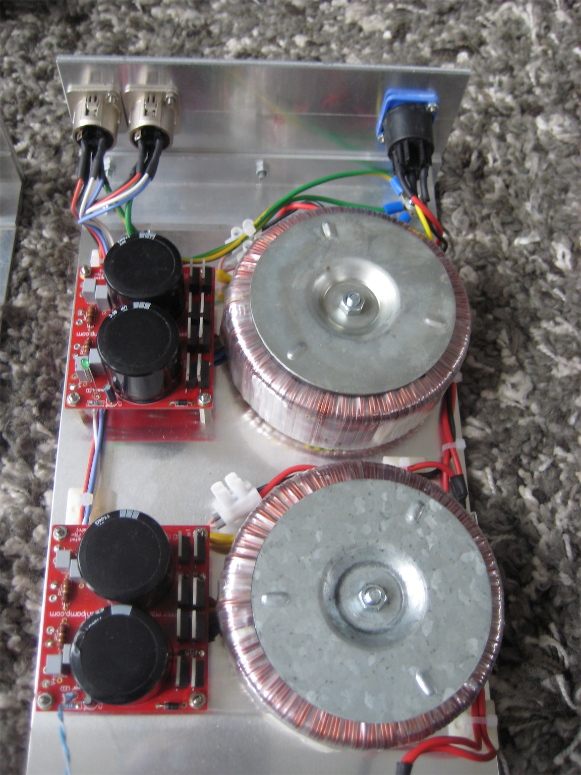

But when I switch on there is also still a hum, this hum gets worse when I fit the amplifier in it's aluminium sleeve and when I connect the DAC the hum also gets slightly harder.
Well the DAC is new so there still could be a problem, but before the upgrade the amp was dead silence and now I installed the breaker there is a hum...weird.

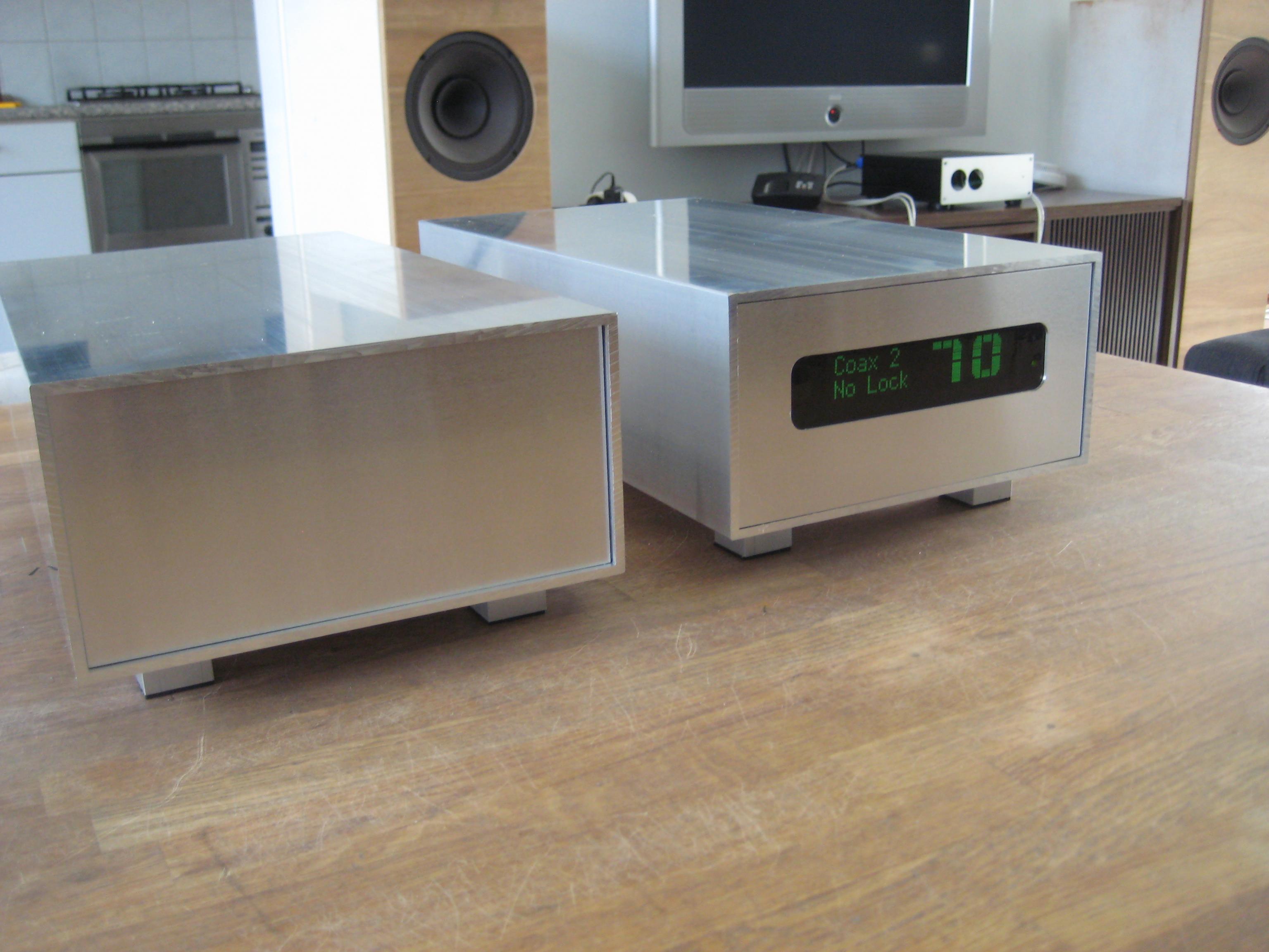

I enclose two pictures one of the outside (with shoebox on) and the inside.
Maybe I have forgotten to say that I use a separate case for the power supply.
Earth makes contact there to the chassis and goes with quite a long wire to the amp where it connects to the chassis and then connects to the loop breaker.

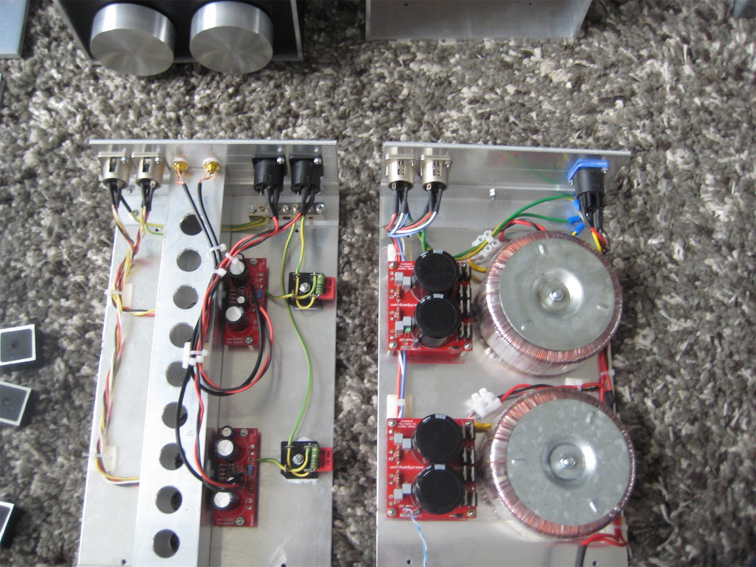

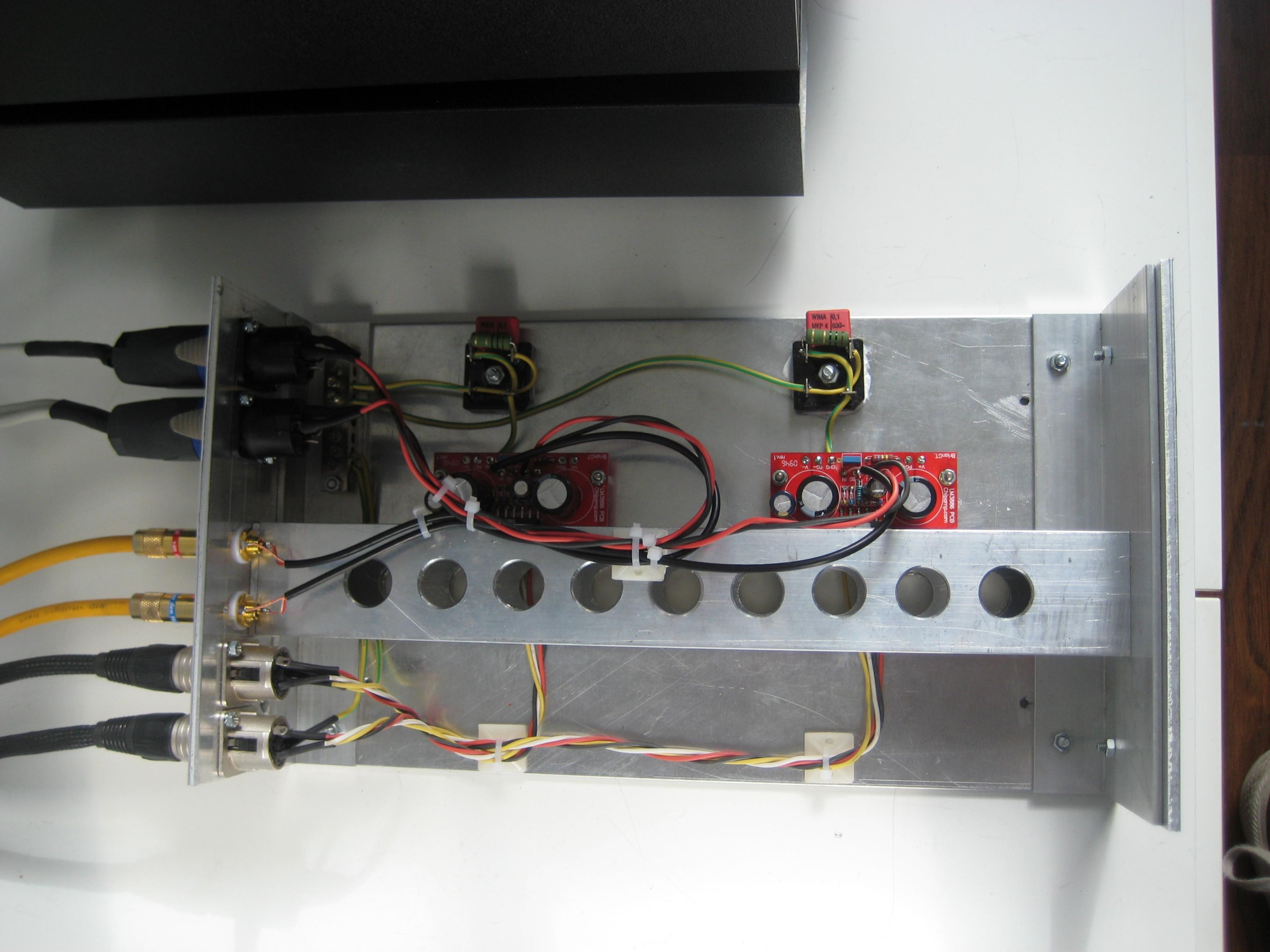

Yes you are right each cable consists of 5 cables V- PG- V+ PG+ and Earth. I have included some pics.

Well it has been a long day and in the end there is succes and failure...and more questions than answers..
I will keep it short....
I had three pairs of broken interconnects? Who could have imagine that
The "hum" has gone....
The hum has gone in combination (Chipamp)with my second source not with the new Dac.
We have tried many combinations and in the end it became very confusing. One thing is clear there is also something wrong with the wiring in my house so that even a loop breaker won't help.
But there is also good news! the Chipamp with it's "upgrade" sound brilliant! Thanks for that.

I know it's a bit late, but it appears you have your AC wiring ziptied to your signal input wiring. They should be as far away from each other as possible. :D
