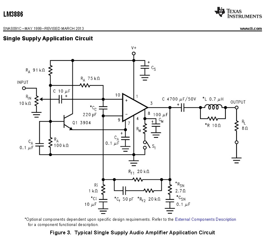

I have an amplifier with several LM3886 boards I made. I knew them picking up radio might be possible, so I added a low pass filter on the positive input terminal. I have a 10uf blocking capacitor, and then a 20k input resistor. This goes to the LPF of 1k resistor plus 680pf capacitor. An online calculator says this is a 3db cutoff of around 234khz. This was noise free for the last year, but it suddenly started picking up garbled conversations of some kind. Just like once or a twice a day it'll pick up what sounds like someone talking into a tin can, sort of like that teacher from Peanuts.
Anything else I can do to harden this up a bit? Here is a rough schematic of the input and the feedback loop. I have the output recommended components and included inductor.

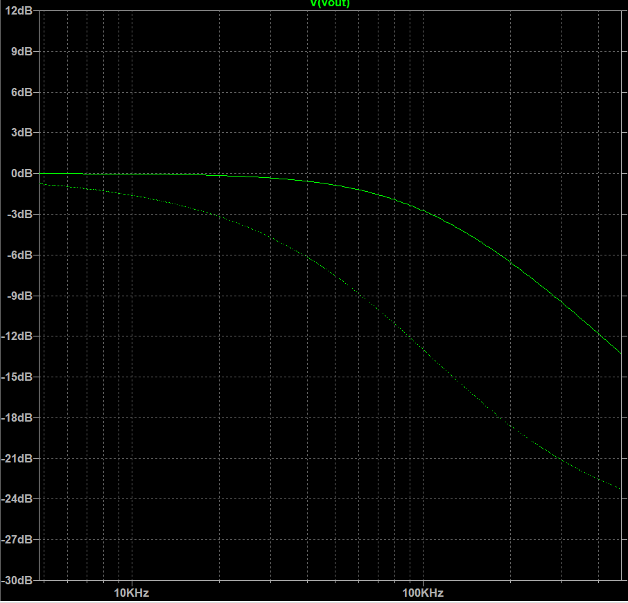

Yep, increase RB1 to 2k / 2k2 to bring the 3db point down to around 100kHz. It will have minimal effect at 20kHz.

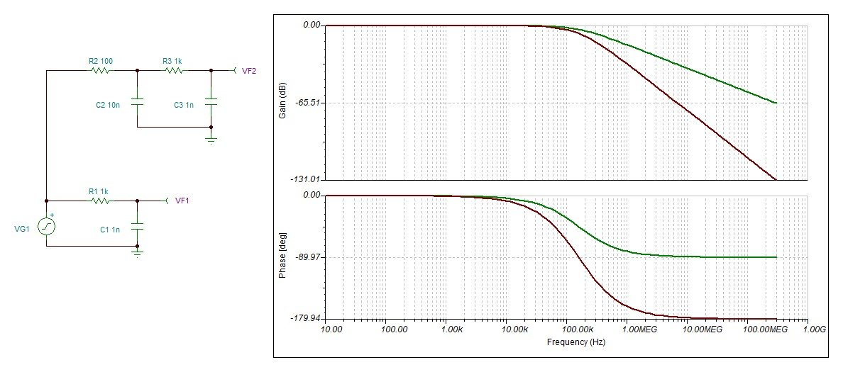

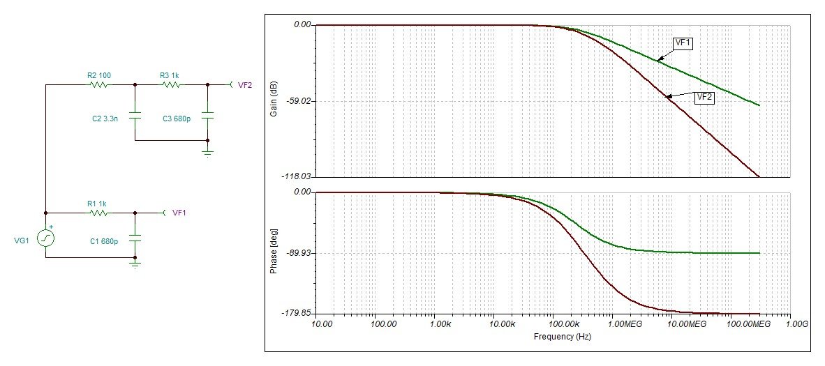

Not sure if using 2 pole filter for more rejection on input is common, guess it could be done.
VF2 output shown as passive 2 pole example.

Does that operate differently that the 1k/680p LPF I have on the +In terminal? A lot of the blog posts I read previously recommended against that and suggested the route I took (on the positive leg only) was more stable? I'm happy to do it, I just thought the consensus was it wasn't the best way going forward.

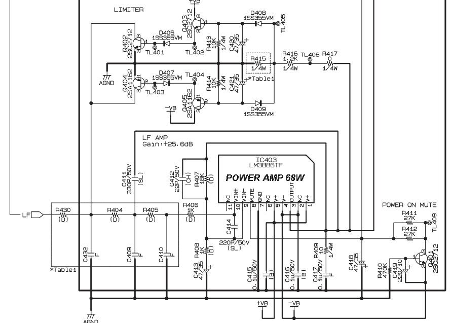

Make sure that the power pins are bypassed w 100nF ceramic caps. As close to the LM3886 chip as possible.
You might also consider using some ferrite clips on Vcc and Vee leads

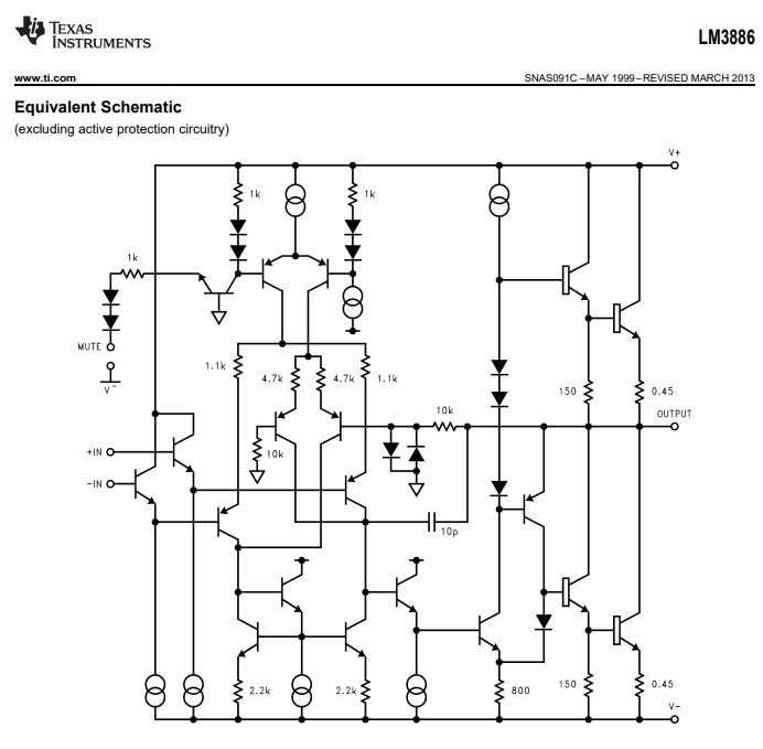

The 1K and 680pF is the low pass for incoming signal.
Regardless of what changes you make there, it will not stop RF.
What is happening with the LM3886 is both the inputs, + and - have very high impedance.
That is shown in the LM3886 schematic.
Because of that, the inputs are sensitive to RF.
I understand some users are against adding this capacitor across the +/- inputs.
Their arguments are it affects the sound quality.
Frankly, I can't hear the difference between having a 220pF and not having one.
Maybe they think they are smarter than TI and Yamaha.

You've ruled out the voices in your head? 🙂 Sorry... I couldn't resist.This goes to the LPF of 1k resistor plus 680pf capacitor. An online calculator says this is a 3db cutoff of around 234khz. This was noise free for the last year, but it suddenly started picking up garbled conversations of some kind. Just like once or a twice a day it'll pick up what sounds like someone talking into a tin can, sort of like that teacher from Peanuts.
1 kΩ + 680 pF is what's recommended in the data sheet. I often go for a bit more attenuation by adding a (de-Qed) LC filter. I'd want 40+ dB of attenuation at 10 MHz. If you look at some of Siegfried Linkwitz' designs you'll see that he uses three RC filters.
Really? I've never had it pick up RF.The LM3886 is prone to picking up RF if unattended.
It looks like you have Rf2 and Cf2 fitted, so I second this suggestion.I would solder a 220pF across the + and - inputs.
It will make the LM3886 unstable, though, as the closed loop gain will be less than 20 dB.Yep, increase RB1 to 2k / 2k2 to bring the 3db point down to around 100kHz. It will have minimal effect at 20kHz.
The decoupling is in the schematic already. It looks fine to me. If anything, I would reduce the 47 uF to 22 uF, but that won't impact RF pickup. It might impact stability at heavy loads near clipping, however.Make sure that the power pins are bypassed w 100nF ceramic caps. As close to the LM3886 chip as possible.
