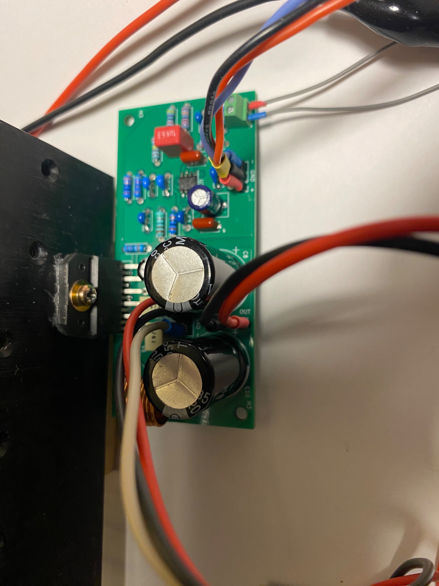

I put up a setup and made some initial measurements. Picture 1 and 2.

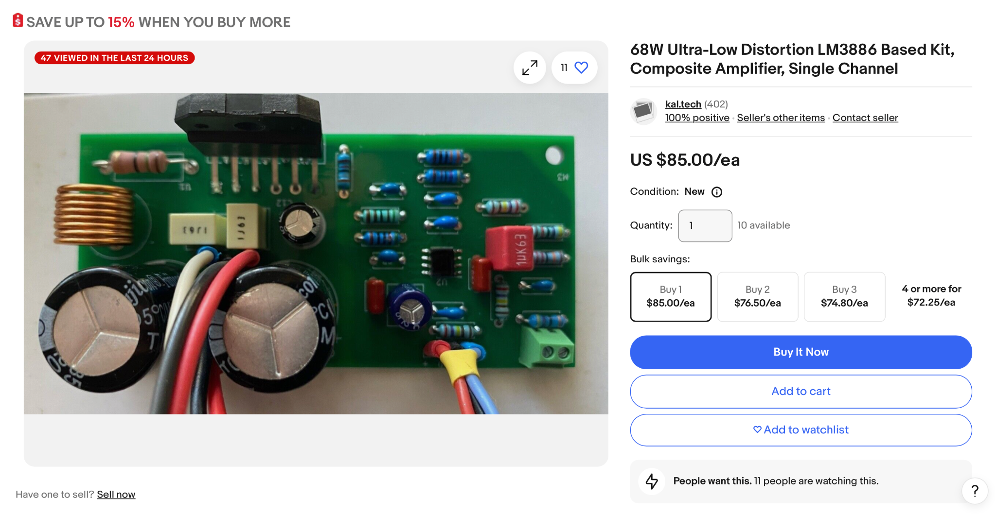

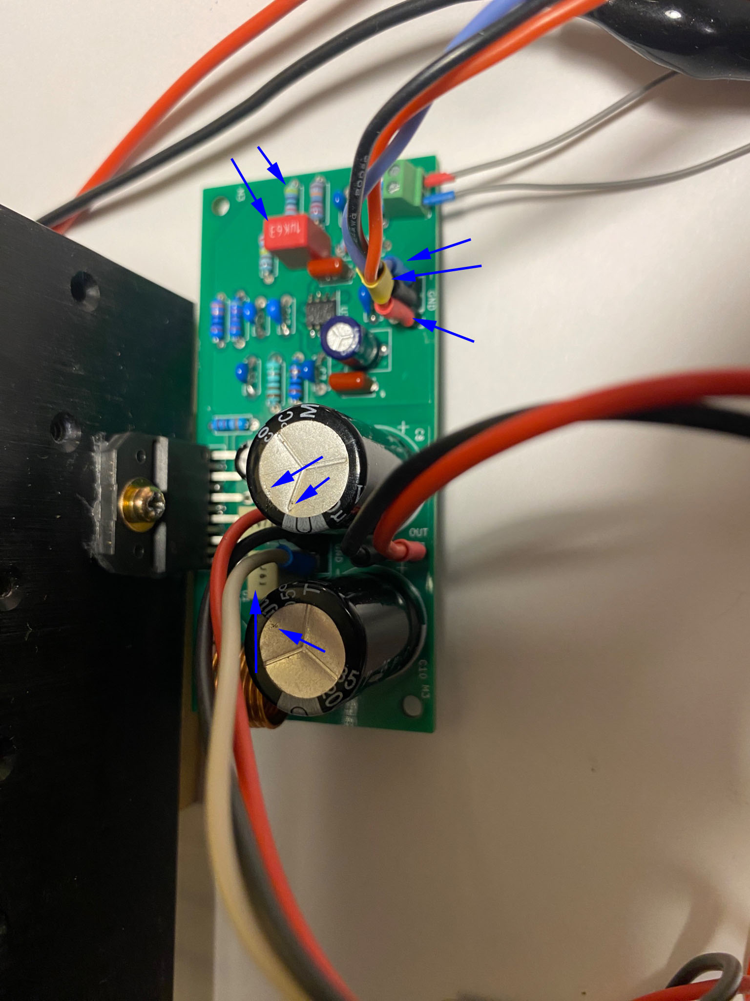

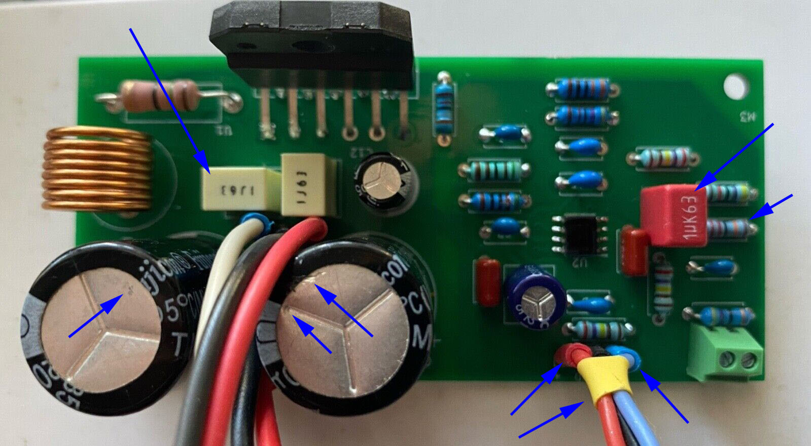

Hmm... You didn't say whether the picture in Post #1 is of your build and test setup, so I'm going to assume that it is. It's certainly presented that way.
The reason I asked that question is that it looks like your board is the exact board shown in the eBay listing. In addition, it appears to be the exact same setup, i.e., the same wires, same use of heat shrink, etc. That makes me believe that you are in fact the seller of this board and are posing here as a satisfied customer posting about their build.
But I could be wrong, so I ask: Do you have any relation to the eBay seller by any chance? Or any conflicts of interests that we should know about?
If you are indeed the eBay seller or are associated with them then I welcome you to the market. Please keep us posted on how deception works as a business strategy.
Below are the picture of your build from Post #1 and the picture of the board in the eBay listing. All the resistors have the tolerance band facing the same way, except one by the input which is reversed ... on both pictures. The scrape marks on the electrolytic caps are identical and the film caps face the same way. I think it's fair to say that these are of the exact same board.
But you did say that you bought the board fully assembled, so maybe it's just an amazing coincidence that you received the same board as the one shown in the eBay listing. But then I suppose it's also just an amazing coincidence that you just happened to use the same wire colours, wire gauge, and heat shrink colours, placement as in the eBay picture.
This is the picture presented as your setup in Post #1. I've added arrows to show the similarities with the eBay picture.
This is the picture from the eBay listing with arrows added to indicate the similarities.
And this is the eBay listing:

Tom, those are no coincidences or similarities. You probably already knew just reading the first post.
Mr. kal.tech (402ebay ) how about an introductory rate for the boards?
And can you sell me a pair of parallel 7293 boards only ? I am 99.99% sure you are same as kaltecs.com
I figured I would give @sherab the benefit of the doubt. After all, he does write:
A week ago I found this on eBay - https://www.ebay.com/itm/334842335447
I was wondering if anyone else had already tried that kit, but couldn't find anything.
So I ordered it and it came 3 days later. The seller also offers a "PCB version only" but I skipped it for now.
If @sherab is indeed the eBay seller then he is engaging in deceptive practices here. I don't know about you, but I don't like being manipulated with, deceived, or lied to.
@sherab: The honest way to start a thread like this is to post about your product in the Vendor's Bazaar and waiting for someone to start a build thread featuring your product. Best of luck with your business.
