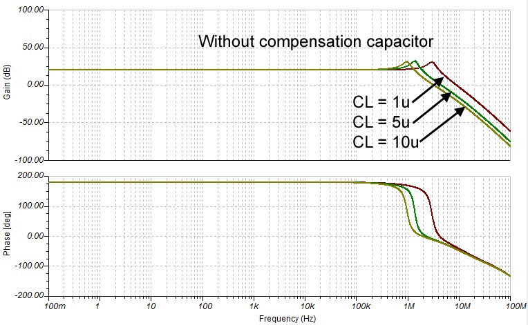

  • The composite amplifier needs to remain stable even when presented with a highly capacitive load (e.g. 4.7uF) that emulates the capacitance of typical speaker cables.

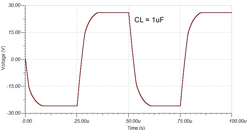

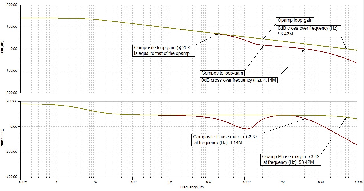

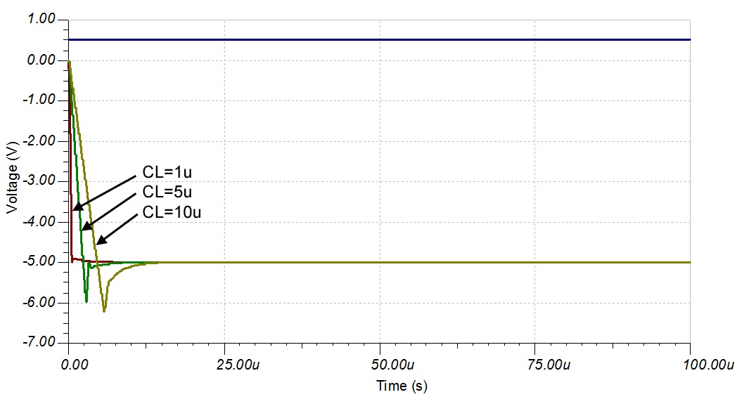

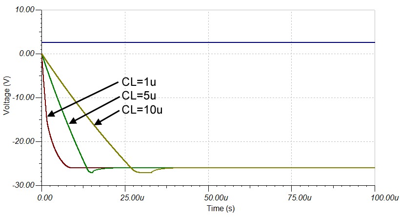

However, lately I happened to find that TINA-TI does not show proper results for the open-loop responses of many parts, possibly due to DC offset saturation. Consequently, my amplifier circuit has not been able to make it to reality, as I am unable to confirm the accuracy of the simulation results (attached).
Though the simulations look good, how accurate are the National / TI models and how far are these from reality? Since this is the first time I'm using TINA (I used PSPICE for over 15 years), I would like to know some of your experiences with this topic.
I can't imagine any speaker cable coming anywhere near uF territory for self capacitance. Typically it is small capacitive load that cause amplifier stability problems, say 1nF to 100nF give or take.
Electrostatic speakers do present as a more pure capacitive load but would be an unlikely partner to a chip amp.

I think you are under-estimating how ugly speaker loads can be. Sure, multi-pole output networks reduce performance, but prevent letting the magic smoke out. Fact of life.
I am not sure I totally agree with your comment on how critical the compensation cap is. Sure, it is not the only factor, but that is it's actual primary function. I think maybe a better way to look at is is how far past zero gain do you maintain stability? What are the other poles? Is there a zero sneaking it that is thermal or age related that could mess it up?
Although I've found the TINA THD function to be totally useless, it somehow manages to obtain the THD of a square wave correctly! The component models are exactly the same as given by TI, for TINA simulator. Of course, I can handle the PCB correctly, as I belong to the (non-audio) industry.
Actually, my circuit is the kind that operates without any external compensation (as you can see from a picture) and its poles / zeroes are a result of the gain-bandwidth products of the constituent devices. The compensation capacitor was added only as a cosmetic adjustment to reduce the effects of the peaking / ringing response.

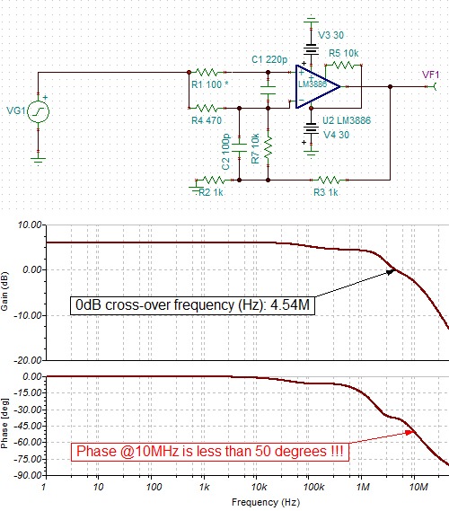

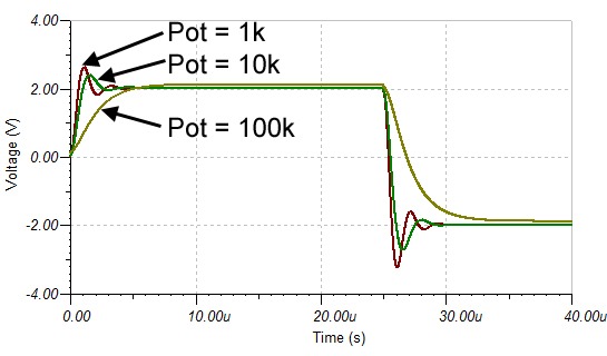

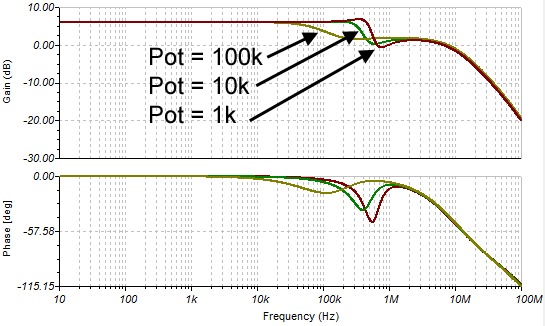

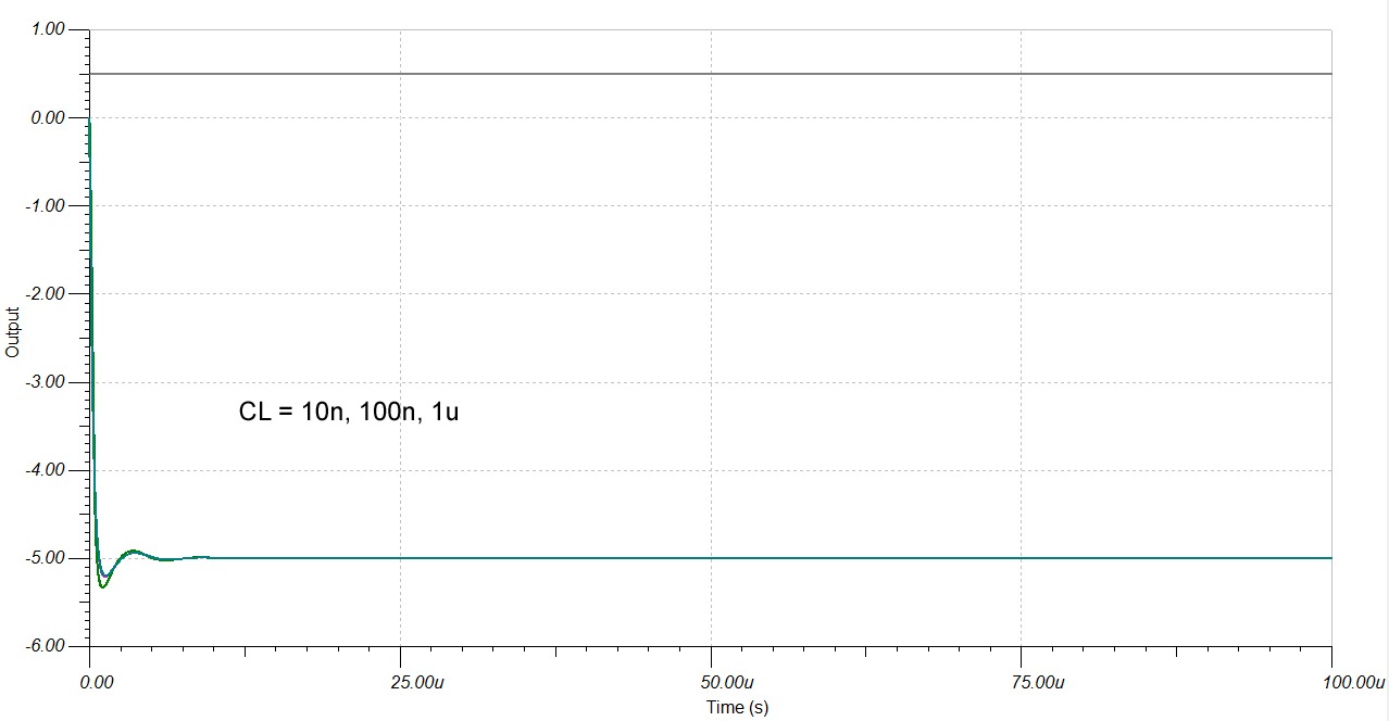

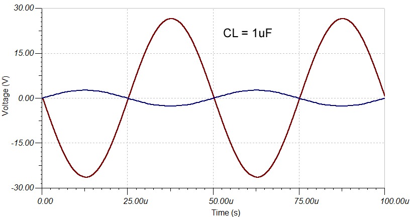

Here's the method that I used for reducing LM3886 gain, without affecting its stability. The idea is to simultaneously use both the inverting and non-inverting gains together to get a net gain that is lower than the minimum recommended value. By adjusting the potentiometer, the shelving bandwidth may also be changed accordingly.

I think you mean that method in which he uses a resistor between the inputs of the LM3886 (here), but I don't use a resistor between the inputs, only the 220pF capacitor recommended by National.
Yes, or simply raising the noise gain a shown here in post 19:
MT-033
But this is better tested in real than just simulation and as you can see it does work.

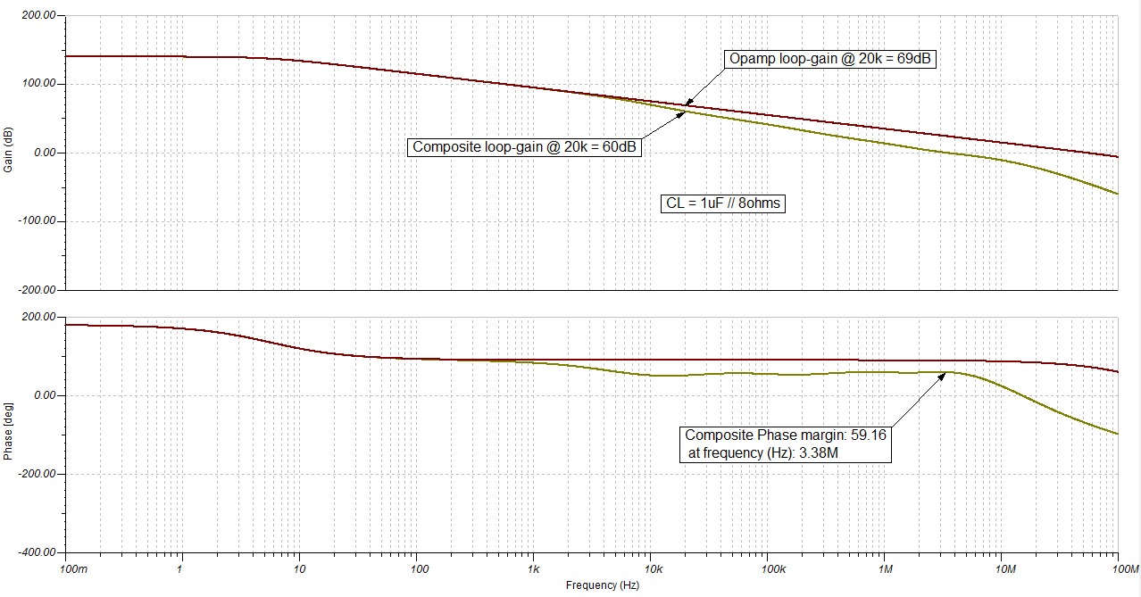

However, on second thoughts, I feel that it maybe best to keep the power-amp at its minimum recommended gain. And, if this minimum is also equal to the net closed-loop gain, then the power-amp gain and the feedback factor cancel each other, leaving the op-amp's gain as the excess loop gain available for error correction. This change should not impact stability, as the power-amp's noise gain remains the same as before.
I have also corrected the list in the opening post, and hope it now reads more or less alright.
depending on the implementation there may be no definition of how much amplification comes from each stage (e.g. if only one global feedback loop).
Right, I was simulating a multiple feedback system with the power-amp in closed-loop configuration.

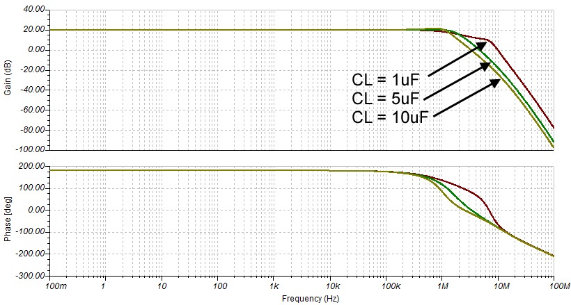

So, there's a new simulation based on the revised concept that uses the power-amp gain to cancel the resistive divider, whose results are attached. However, once again, there's the issue of the simulation translating to reality! But I must say that the LM3886 characteristics look very promising.

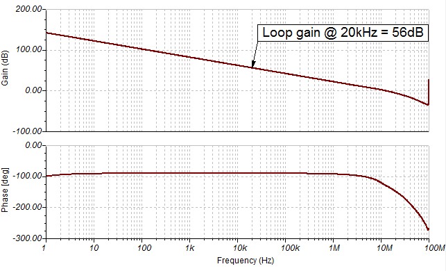

From the TINA macromodel, the OPAx593 loop gain at 20kHz is 56dB, much similar to that of LM3886. However, since this loop gain does not include the resistive divider, it would drop by another 20.8dB for a closed loop gain of 11V/V.
It is due to this issue that I later (since post #10) thought of using the power-amp gain to cancel the divider, leaving the entire op-amp loop-gain available for error correction. For the LME49710, this value would be close to 70dB at 20kHz.
However, I think this opamp can make a very good driver in discrete linear amplifiers. Due to the excellent DC precision, it may also be possible to apply local feedback around the output devices to further stabilise the quiescent current without putting the VBE multiplier on the heatsink.

The TINA-TI model for the LM3886 is not great. It works OK for a small signal analysis away from the supply rails. I find the transient model to be reasonably reflective of reality as well. The model does not include THD and also not anything related to the power supply. Not even the supply current (aside from the quiescent current).
I still find the model very useful to eliminate bad circuit candidates. But for deciding between two good circuit candidates you really need to build the circuit.
Tom

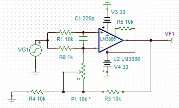

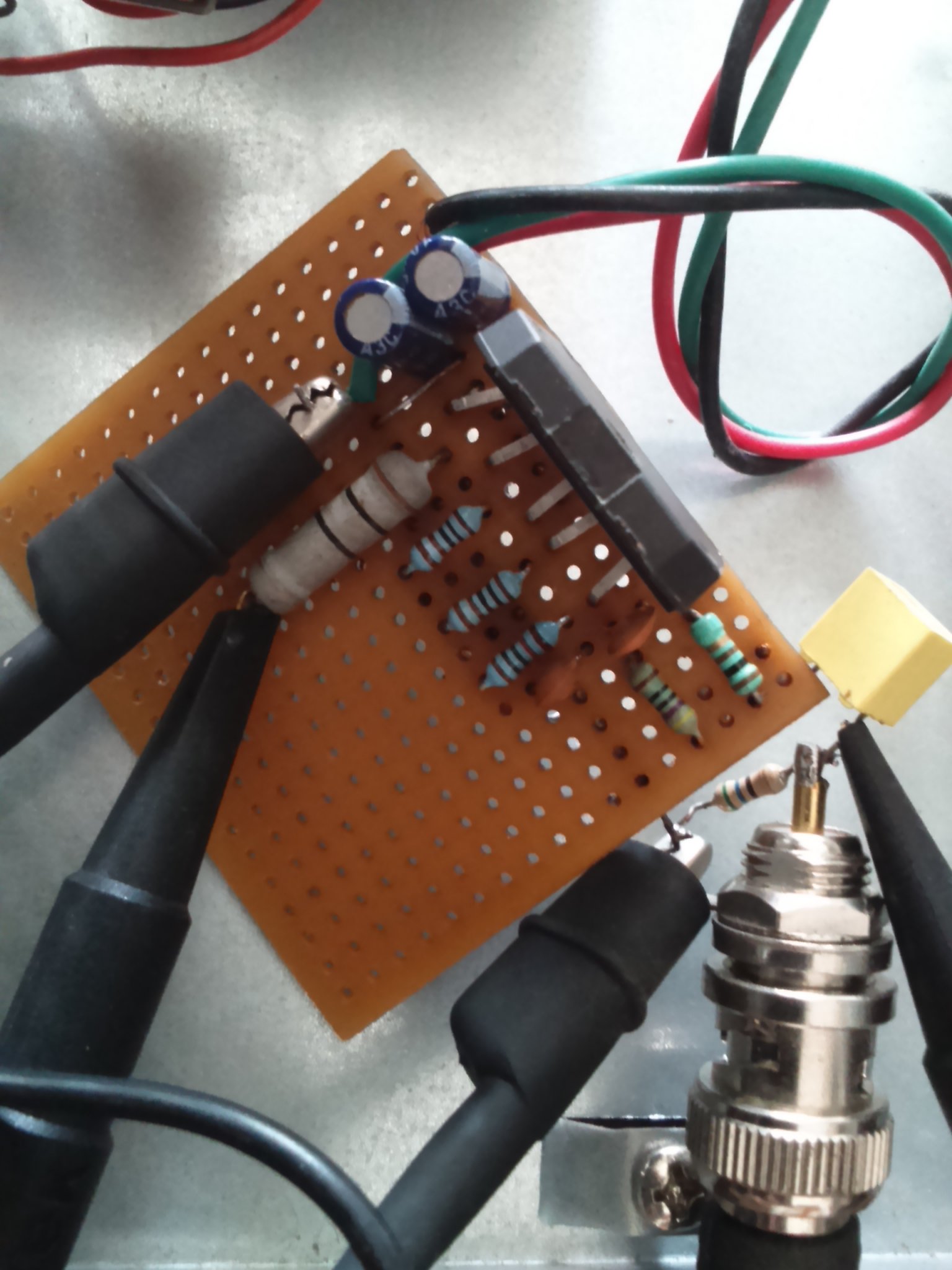

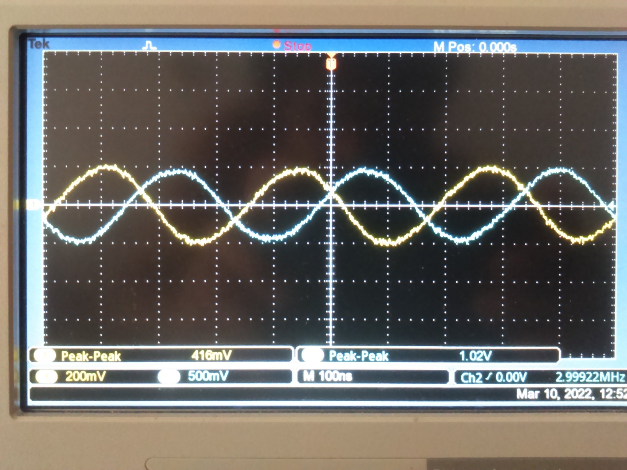

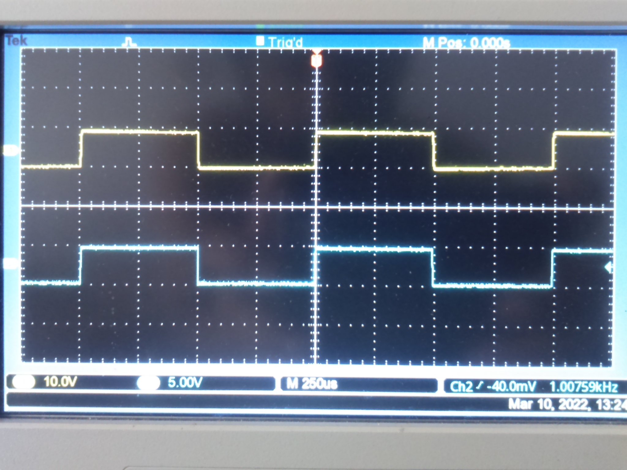

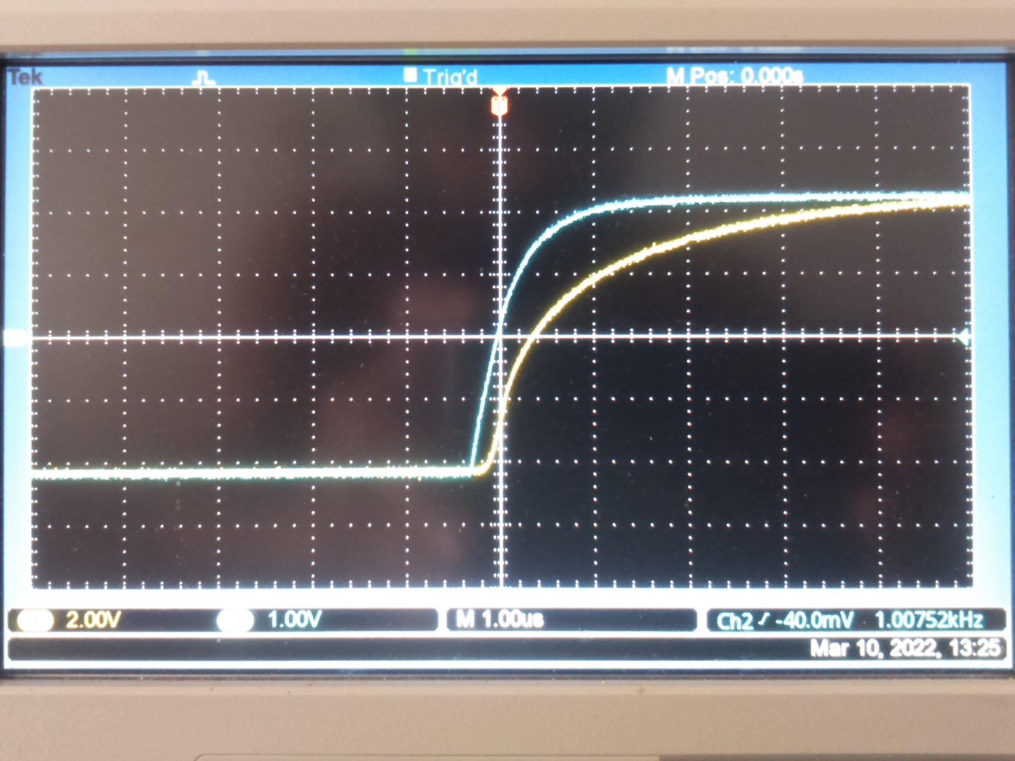

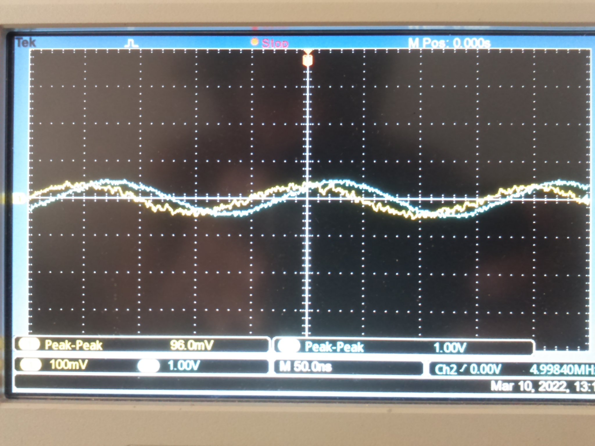

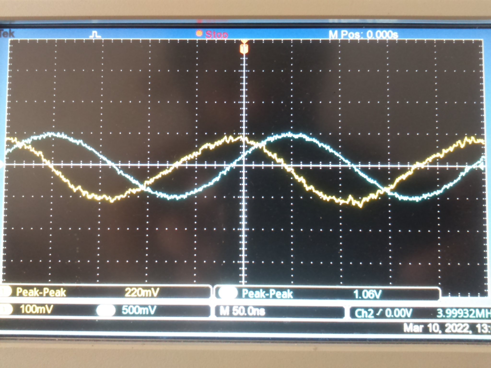

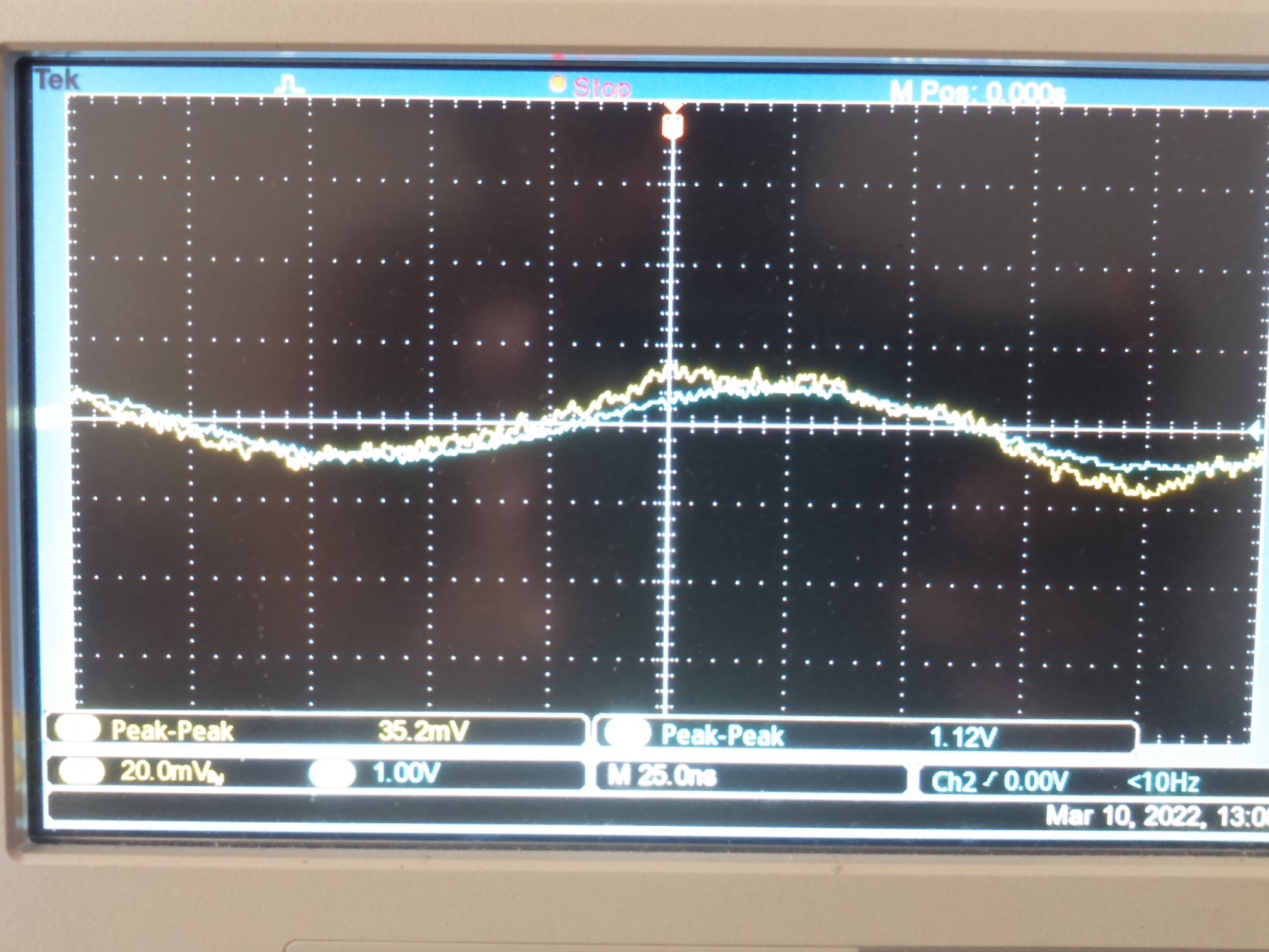

I did build the non-inverting 6dB circuit with some modifications (circuit below). The results for 1kHz square-wave and 3MHz-6MHz sine-wave steps are also attached.
Input = Blue trace (Ch2) and Output = Yellow trace (Ch1), descriptions in the respective filenames.
What I gather from the pictures:
* The circuit is indeed non-inverting with a gain of 2V/V or +6dB as intended, with dynamics suitable for amplifier applications. In fact, a non-inverting 0dB (unity gain) amplifier could also be successfully built, based on the fact that the inverting and non-inverting gains differ exactly by 1. This would also cancel the influence of the resistor divider on the magnitude of the closed-loop gain, which is sometimes a useful thing.
* Though the 6dB circuit works well across the audio band, high frequency results show that it turns a lot of phase, much unlike what the LM3886 TINA macromodel predicts (last picture).
Frequency / Gain / Phase
3M / -8dB / 135*
4M / -14dB / 120*
5M / -20dB / 30*
6M / -34dB / negligible.
Now, it is worth noting that one would get misled if he/she were to look at the audio frequency band alone. So, does it work ? Yes, but not as claimed by the manufacturer's model.
So, what could be wrong with the model when it seems to work for many? Most likely the locations of the non-dominant poles, which are considered important in non-unity-gain-stable (decompensated) opamps.
And, why would the manufacturer model only the dominant pole correctly ? Most likely because that's the way the device was primarily meant to be used and experiments such as this involve undocumented ways of operation that are usually not covered by datasheets / spice models.
So, maybe I could have made a mistake ? Not likely, as I have checked these things multiple times. However, there's this thing that my power supplies were only about +/- 17V and I don't know if that would make a big difference, but I'd like to know if it would. I'd have to go to the market to get some rectifiers though.
