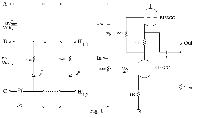

So this uses 2 E188cc for stereo, 24vdc rails, and 12v heaters?
Hmm. If i went with this, could i use the 30vdc rails for B+? And with the 12v heaters i could just pop in a 12v regulator from the rails too, no extra transformers necessary.

Here are two examples of not-so-standard PSUs:
DIY 12AU7 Tube Preamplifier Project with back2back transformers, and
12AX7 Tube (valve) Preamplifier Kit with a DIY SMPS.
