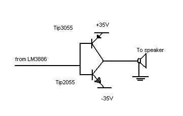

I have also considered using the Lm3886 as a driver.
I'm trying to build a sub right now, and I thought I'd build a bass amp also.
And since I'm not out for the highest fidelity or anything, juste a sub amplifier, I was wondering if I could use a very simple setup, something like this;
Best Regards,
Christian
