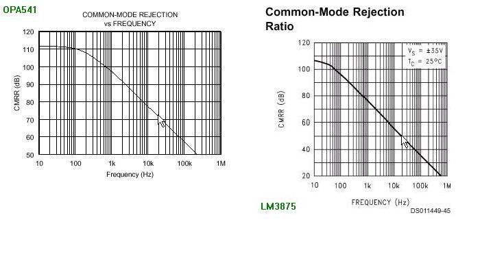

It looks like I answered my own question:
http://www.diyaudio.com/forums/showthread.php?postid=261657#post261657
So, on paper LM3875 would be the better choice if designed and executed properly.
