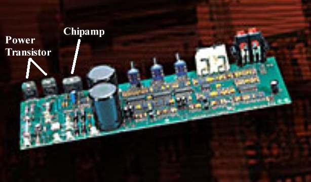

I saw an almost US$1000 subwoofer made by a well known company that uses this type of amp, 1 chipamp, and a pair of complimentary output transistors. 😀 Now that powered sub really sells here in my country for hi-end HT. 🙂

BTW, the picture is the amp of an active (powered) sub that I saw personally.
